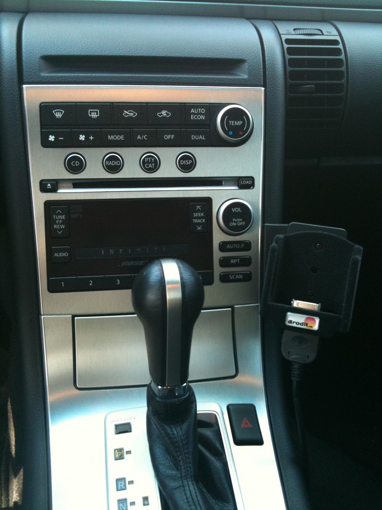

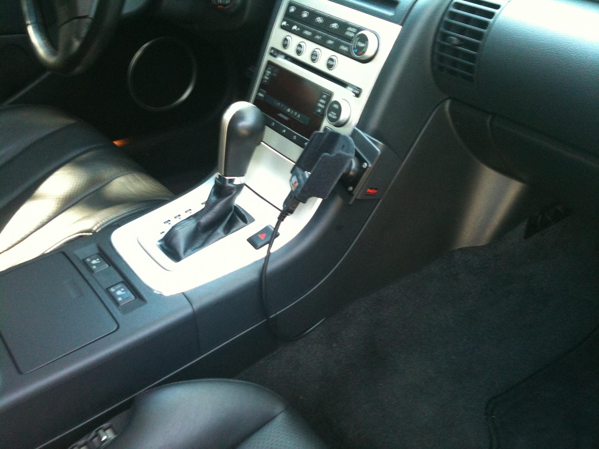

Installed this over the weekend with a ProClip pass through mount for my iPhone.
Attached Thumbnails USA Spec Pa15-NIS-img_0161.jpg   USA Spec Pa15-NIS-img_0160.jpg
