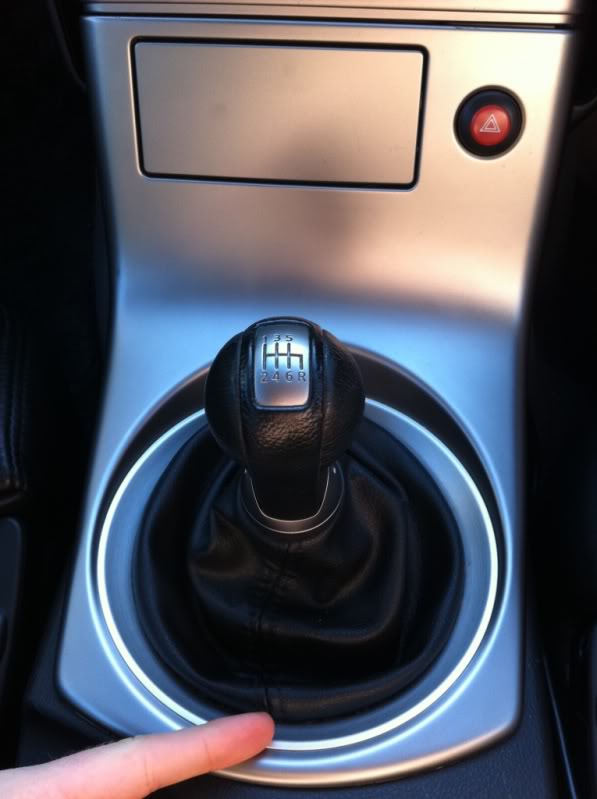

If u got manual i put mine on the bar that sits under the bose unit. You can see it when u pull the gear stick plastic cover off.. ill take a pic later
so wrap you fingers under the edge where the leather is and pull upwards. Make sure u shift into 4th so you have room to swivel the whole thing on a angle so you can get to it and when installing unplug the hazard and ashtray cables.
But anytime i need to change settings on it, or plug in the RCA plugs i can.
For now i just have the cord running down the side of the drivers center console and it just sits next to my seat belt until i can figure out what to do with it... Its handy as u can hold the iphone close to u when u using it for gps etc or typing messages...
