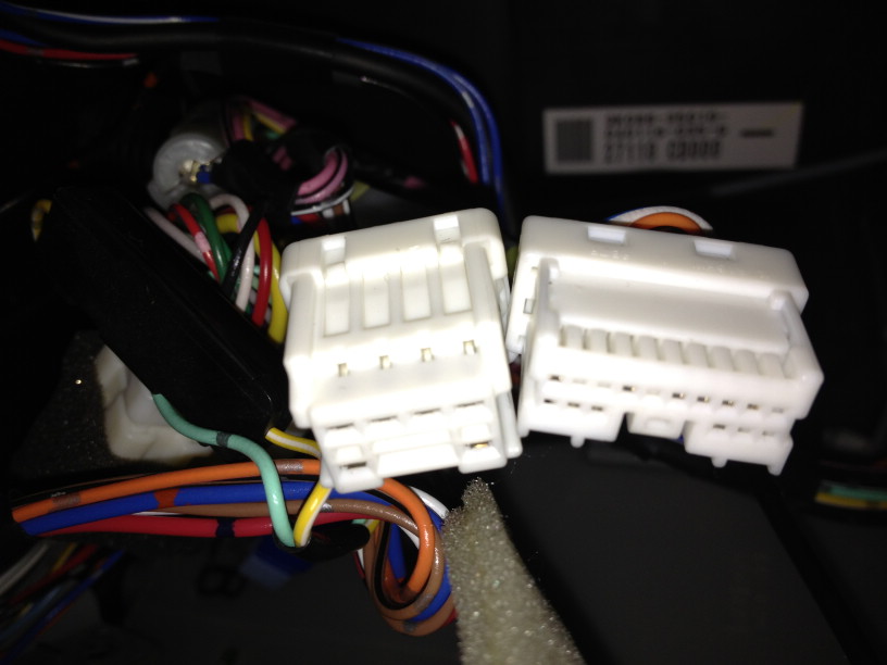

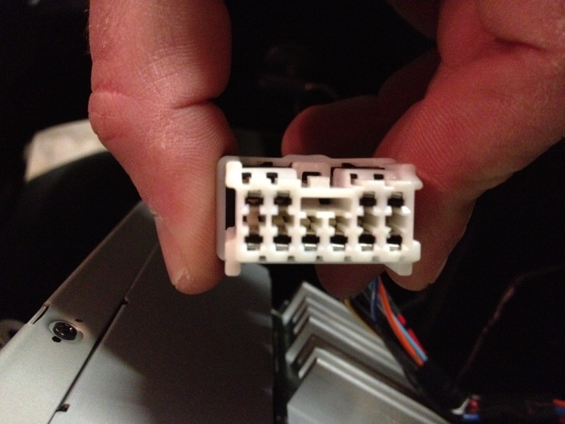

R6n350GT,
I got a 350Z and i'm also missing the 12pin plug. Only have the 10pin.
Did you ever got the PA150-NIS working without the 12pin plug?
Old Feb 11, 2012 | 07:13 PM
  #309
R6n350GT's Avatar
Joined: Sep 2010
Posts: 359
Likes: 19
Originally Posted by Tepke
R6n350GT,
Hey man, yeah you dont need it from memory, it will be the only plug you dont use.
All others plug in!
They are my plugs
In the 2nd photo you can see the top wire is separate from the head unit, the other wire should be plugged in so ignore that.

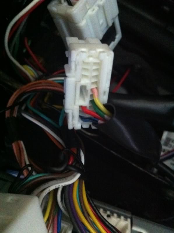

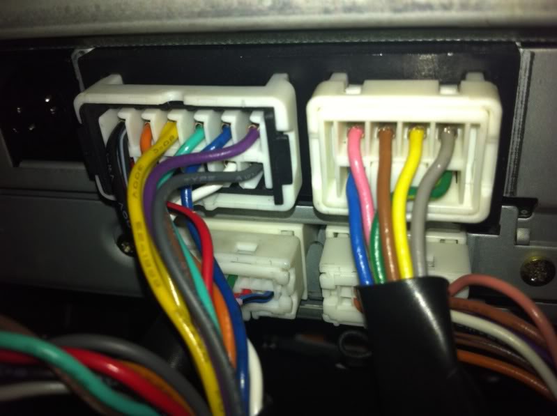

All others plug in!
They are my plugs
Thanks for the pics man!
The back of my radio looks like this:
As you can see, i'm missing the connector on the bottom right.
It's also explained here:
http://www.350z-tech.com/wiki/index....e_Sound_System
Tried to install the PA15-NIS yesterday again, but unfortunately I can't get it to work
Can you please take pic of you USA SPEC plugs? looks like you may need PA11-NIS not PA15-NIS..
