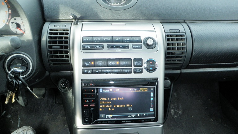

I finally got around to installing the PIONEER AVH-P3200BT head unit yesterday, my only real complaints about the unit is you can't completely shut the unit off and the steering wheel controller on radio doesn't go to the next station stored in memory, it just moves up the dial. On the good I like the SD card reader which I have about 900 mp3's stuffed onto it (no more cd's) and the blue tooth worked very well with the cell phone, it imported all my contact and my placement of the mike worked out well.
The PAC ROEM-NIS2 Nissan/Bose Radio Replacement Interface worked very well also, no sound issues with it at all, works perfectly.
The Metra Axxess ASWC universal steering wheel controller gave me the most grief (trying to find out how to wire it up) and to my surprise it worked. I had a hard time leaving all those other wires unused and unaccounted for.
Running the head unit parking brake ground threw a relay to ground works fine and is useful when stopped at lights so I can get into all the menus without having to engaging the parking brake.
I also transferred the dual climate control buttons to the jdm hvac controller and yes it also works.
