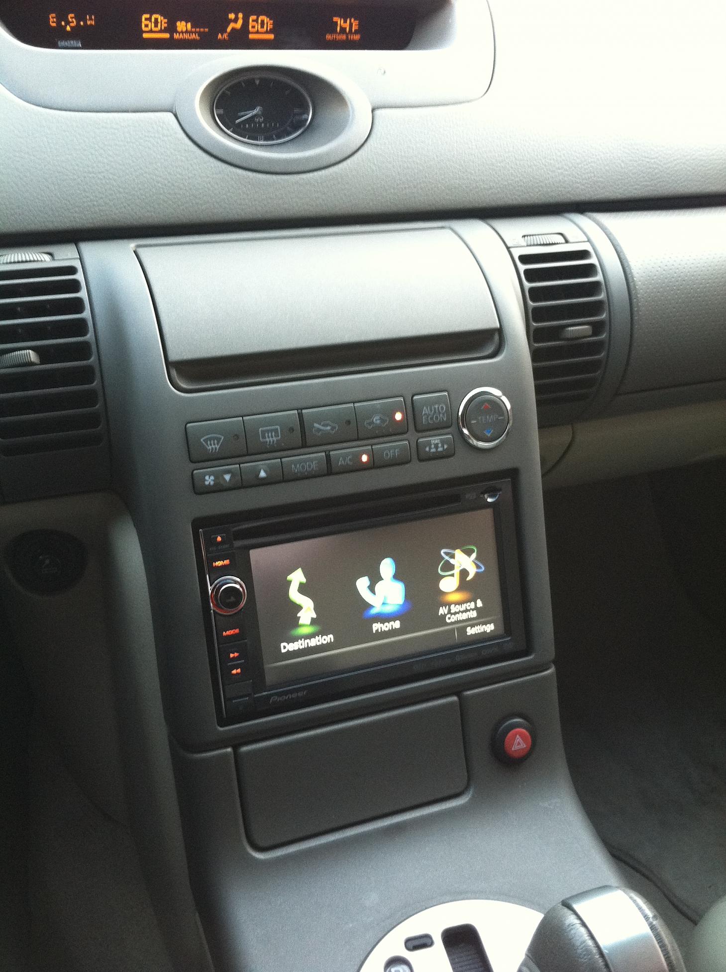

Finished my install
I finally finished my install, and I think it turned out pretty good. I used the willow color JDM buttons for the AC (PITA) and did the dual AC mod. It was much more work than I initially thought being a newbie and all ... but the sense of satisfaction is high.
Looks great, and definitely a good result from popping your a/v cherry

sweet.... good job bro, any pics of it head on? did you use a dd trim ring?
No other pics yet, and yes I used the DD trim ring.
The only problem I have is that the touch screen takes a while to become responsive. (up to 5 min, should be less than 15 seconds) I am having a local stereo shop take a look at it next weekend.
