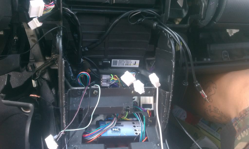

To make room for the DD, I cleanly zip tied my cables together and shoved them all the way down. Make sure you organize all the cables before placing the HU inside.
