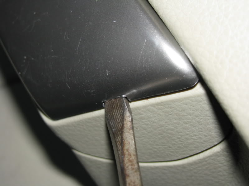

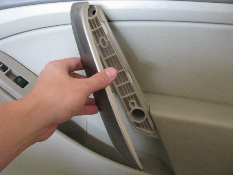

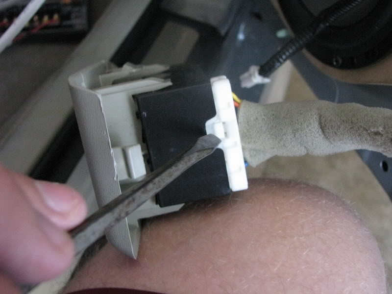

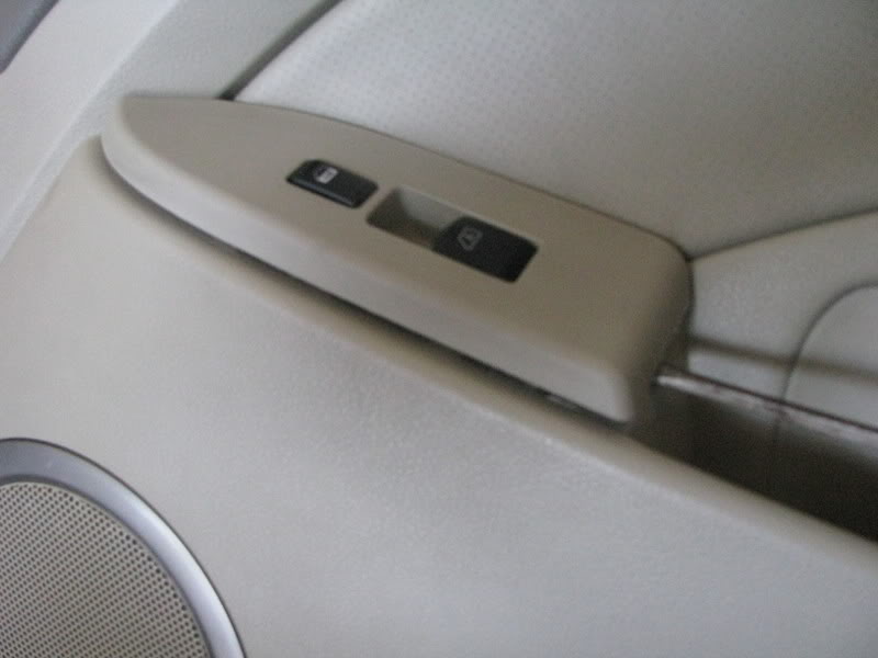

thanks for the video. I will update the first post with this vid..however at the start you dont have to pry off very hard..there is a notch..those notches are actually made for a Flat-Head screw-drive that you slide up in there to allow you to pry out on. Also on the window switch you can pop in a flathead and just pop off the window switch to acess the wiring harness alot easier.
pry up here:
access the harness very easy.
On the bottom side there should be a little slot. Stick the flathead into this slot and twist your screw driver or pull out on it.
Quote:
Actually I did in fact use a flat head screw driving which was inserted into the notch at the bottom of the panel, it was just really stuck on there. As for window switch, that could've been one way, but i wanted to avoid marring the finish around the switch. Good points though Originally Posted by g35man04
