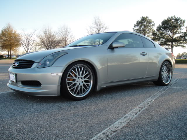

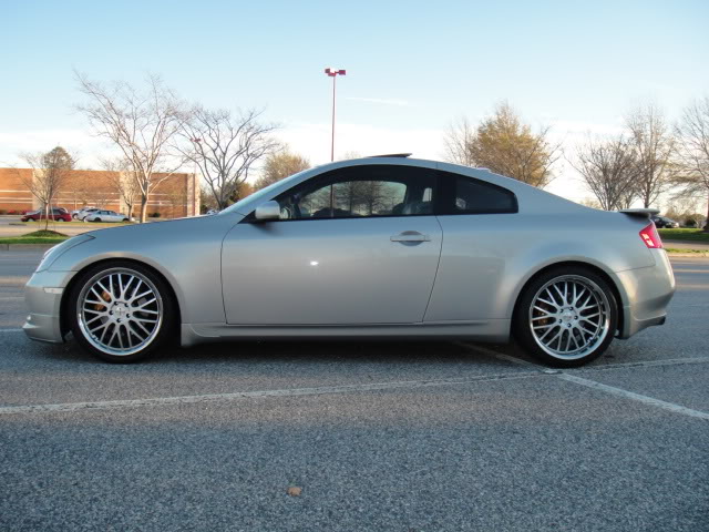

I was kinda scared to attempt this, but I did it anyway... If I messed up, I was gonna call in sick tomorrow since the dealer was not open today... Thank goodness everything worked out well and the car is back together. After I did my cut (1/2"), I placed them on a flat even surface and placed a level on top of them. I kept sanding until it was levelled... That is how I achieved the even cut...
