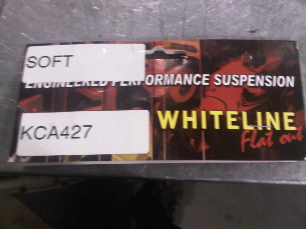

First thing first it is I-N-F-I-N-I-T-I I not Y
Whiteline also sells replacement bushings they sell them as a pair they have hard and soft bushings. They call them radius arm bushings in the UK if your dealing direct with Whiteline I also posted the part number in another thread I am on my phone so I can't get it now but search should find it. If youre going through the work to replace them no point in putting sh1tty OEM ones back in again.
Part number this will be helpful dealing with Whiteline

Yes, that's me, thanks! New shipment on its way - should be here any day. ES really does have a much better solution to the bushing issue. No way, no how would I replace the compression rod bushings with either factory parts or Nismo bushings - they're both rubber. The whitelines are the same basic design concept, but they use polyurethane instead of rubber. The design of these arms requires that there is a lot of deflection in the bushings, and with the factory bushings, the Nismo bushings, and the Whiteline bushings, the only flex built into them is by deflecting the rubber or poly material. This quickly causes the rubber to tear, i.e., the bushings to fail. Jack your car up and look at how much the CR bushing is deflected, and then understand that it's manufactured as a straight piece, and you'll see what I'm talking about. SPL and ES are the only ones that actually allow any differential movement of the bushing parts (by different methods, but both allow movement.) The SPL parts are good, but they're very expensive and it's not yet clear how long they will last on a street car, driven in rain, dust, snow, salt, and mud.
