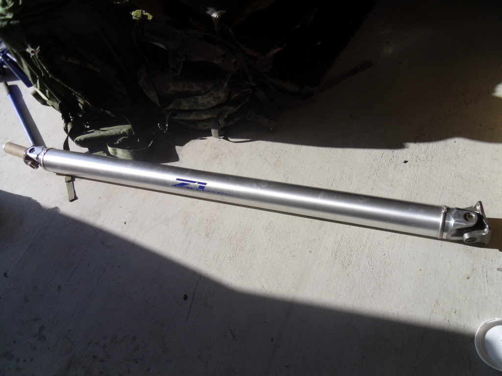

Got mine in. Started at 630 after work then finished at 8. Not bad for being on my back. Note: the bolts connecting my diff to the shaft **heh heh** were 17mm. I did a quick spin around the block. My initial impression is that there are less vibrations coming through the shifter. I will stretch her legs tomorrow on the way to work and see how she feels.
nice solid one piece

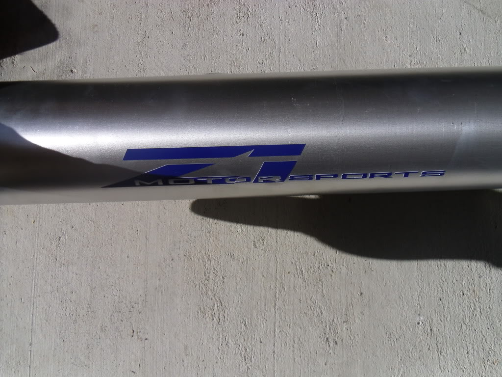

Notice the blue Z1 sticker. It may be so they can tell the difference between manual and auto.

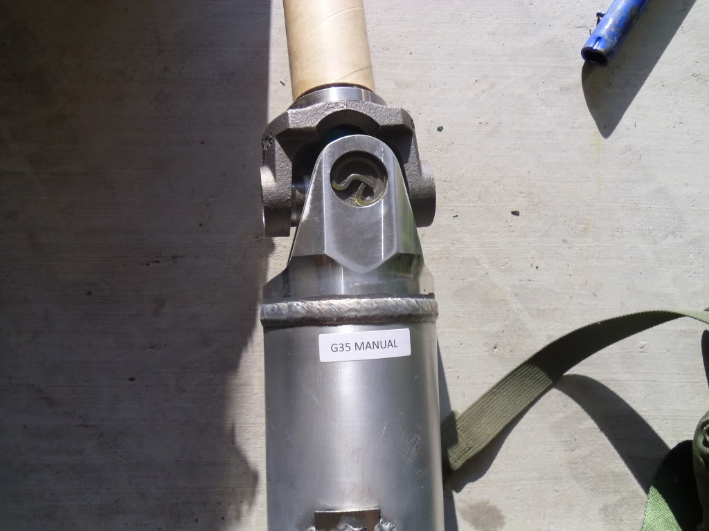

G35 manual

Mine didn't have weights on it. I guess I lucked out when they balanced it.

what weights do u see on those pictures??
serious question I don't see it...might be me

Very bottom of the last pic looks to have a weight tack welded on. Completely normal for a driveshaft to have to be balanced.

Yeah, mine has some weights tack welded on it. That's normal. Just like wheels have weights on them to help balance, so do driveshafts. Manufacturing processes are not perfect, and thus, balancing is needed.
