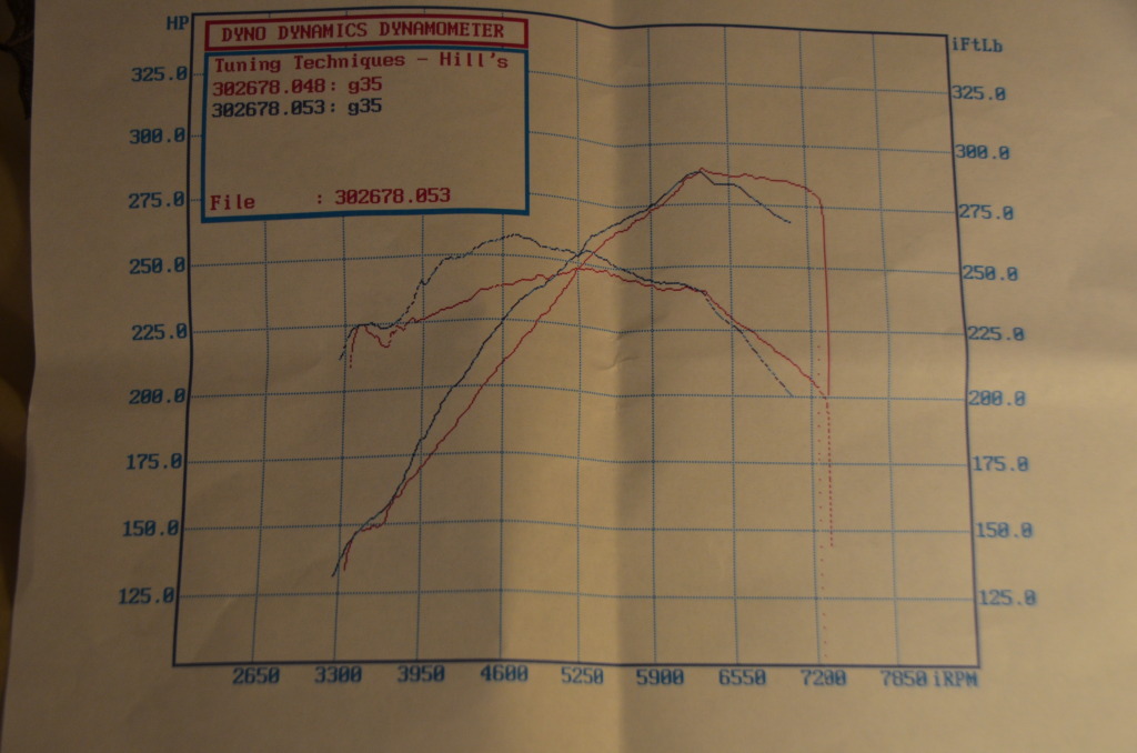

Old May 8, 2012 | 11:58 PM
  #360
Dsskyline's Avatar
Joined: Oct 2003
Posts: 2,729
Likes: 84
From: Owings Mills MD
Here is the after dyno. The car was pinging up top on the dyno so I had it retuned also since I had my exhaust and headers changed out since the before run.
Headers and exhaust would not cause a TQ jump as shown
before retune
after retune
My results are similar to this mustang with a alum driveshaft.
http://www.coastdriveline.com/PressR...DriveShaft.htm
