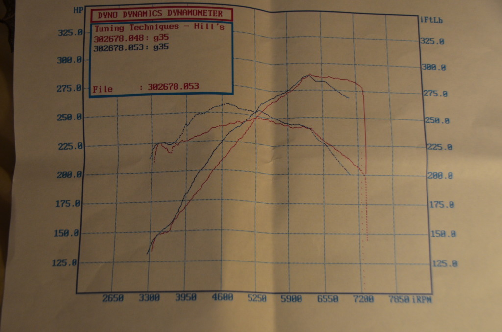

Originally Posted by Dsskyline
Here is the after dyno. The car was pinging up top on the dyno so I had it retuned also since I had my exhaust and headers changed out since the before run.
Headers and exhaust would not cause a TQ jump as shown
So the driveshaft was only installed on the second dyno run? If so then retuning with breather mods and driveshaft installed just for that run would render it inconclusive.
I probably won't be able to do a before and after dyno since I've got too much other crap being done at the same time.

Yes and no both dynos were done today. The DS was installed last Friday the 1st dyno was before anything was done tuning wise just pulls. So yes the 2nd dyno is not a actual representation of the DS gains because it is after tuning.

What are the differences between run 48 and 53 on teh first dyno?
Different exhaust and the redesigned longtubes. Run 48 is from Jan run 53 is after a few runs today before bbeing retuned.
The exhaust showed no gains the headers gave me my low end back with a little lost up top on a dynojet so I shouldnt of gained anything up top. The only way to get a true after is to go back to RT tuning, but my tq did not rise like that on RT's dyno before the DS 2wks ago.
I know that it feels different since installing the DS.
That is why I posted the mustang dyno it also shows a big jump in lowend-midrange tq from a alum DS.

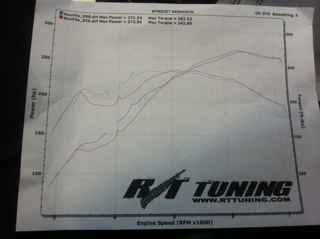

I know that all dynos are different, but here is my dyno from RT tuning from 2wks ago with the new headers and exhaust vs old long longtubes and gemini exhaust. run 25 is old, 58 is new.
The only difference from changing the exhaust and headers is the lowend

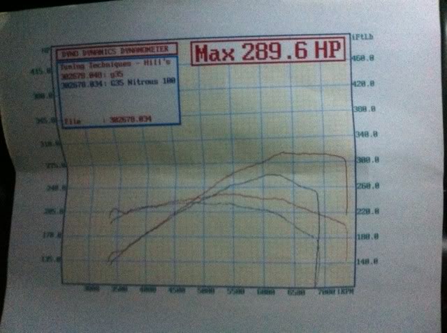

The car reads 10 hp/tq higher on Hills dyno compared to RT's
Here is the Hill's dyno after a touch-up to my tune (run 25) from RT. The car put down 282 before he did anything on RT's tune. The blue line is before cams, new exhaust and longtubes.

Notice the difference in low end between the dynos after adding the DS before tuning.

The car put down 288 on this run before tuning which is almost the same as before.
Sorry for all the dyno sheets I know that there are doubters, but there are gains switching from a 2 pc to 1 pc DS on our car.
