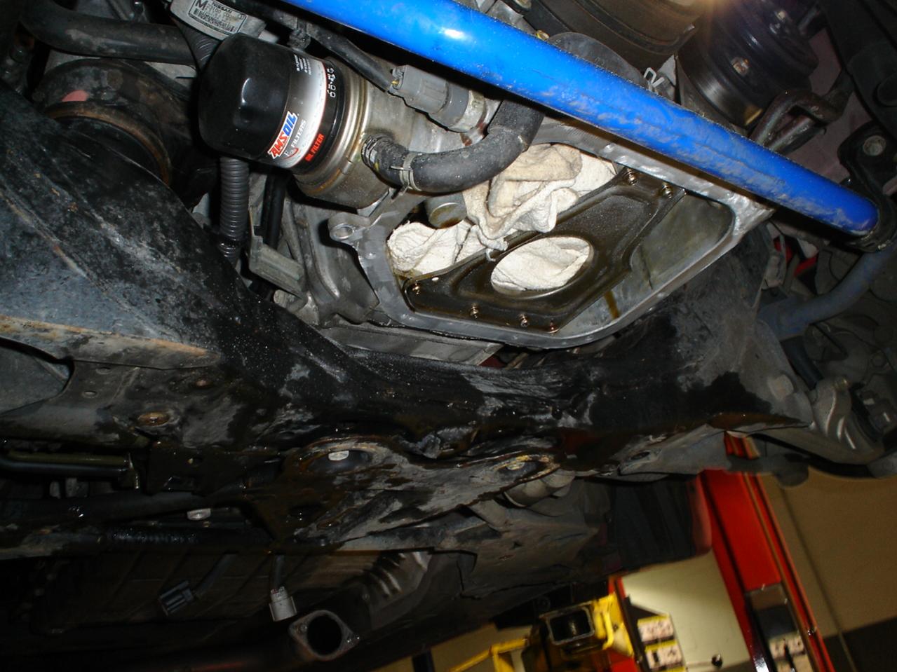

Pics!

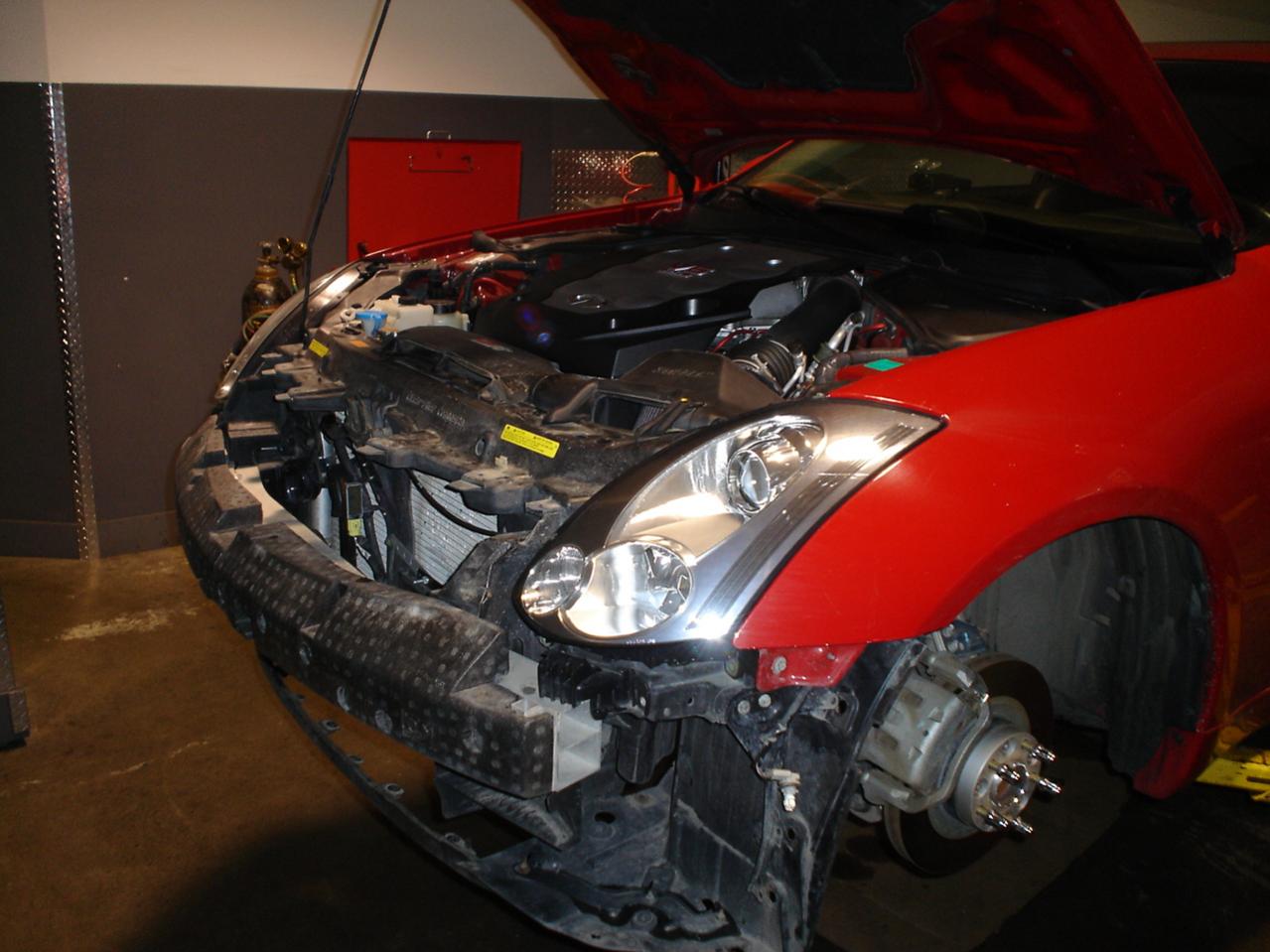

Not too much to see on these- I thought there were some current ones from today but I see there are a few things they've done I don't see photos of. Intercooler is 80% on and they're just working on that piping. The gauges look fricken awesome, but the cluster is a bit heavy so it'll need to be secured in place somehow- right now it won't stay seated on the A pillar.
Got a good Amsoil product plug in there...
There is some hesitation on the wastegates- that's where Cam comes in I hope!
Here are some photos! I'll post more on Monday.
Attached Thumbnails FI: we're not in Kansas anymore...-dsc00338.jpg   FI: we're not in Kansas anymore...-dsc00355.jpg   FI: we're not in Kansas anymore...-dsc00358.jpg   FI: we're not in Kansas anymore...-dsc00347.jpg

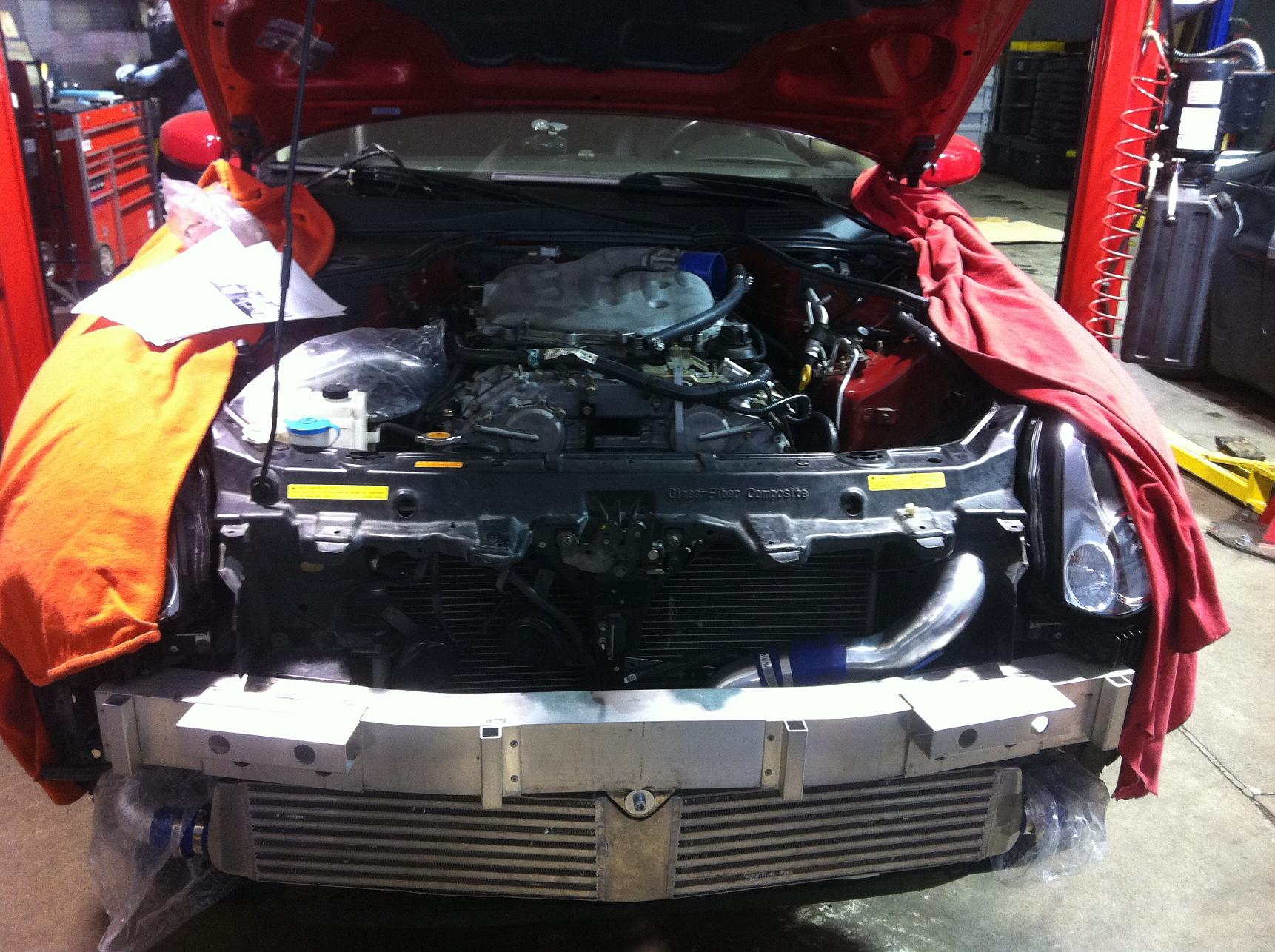

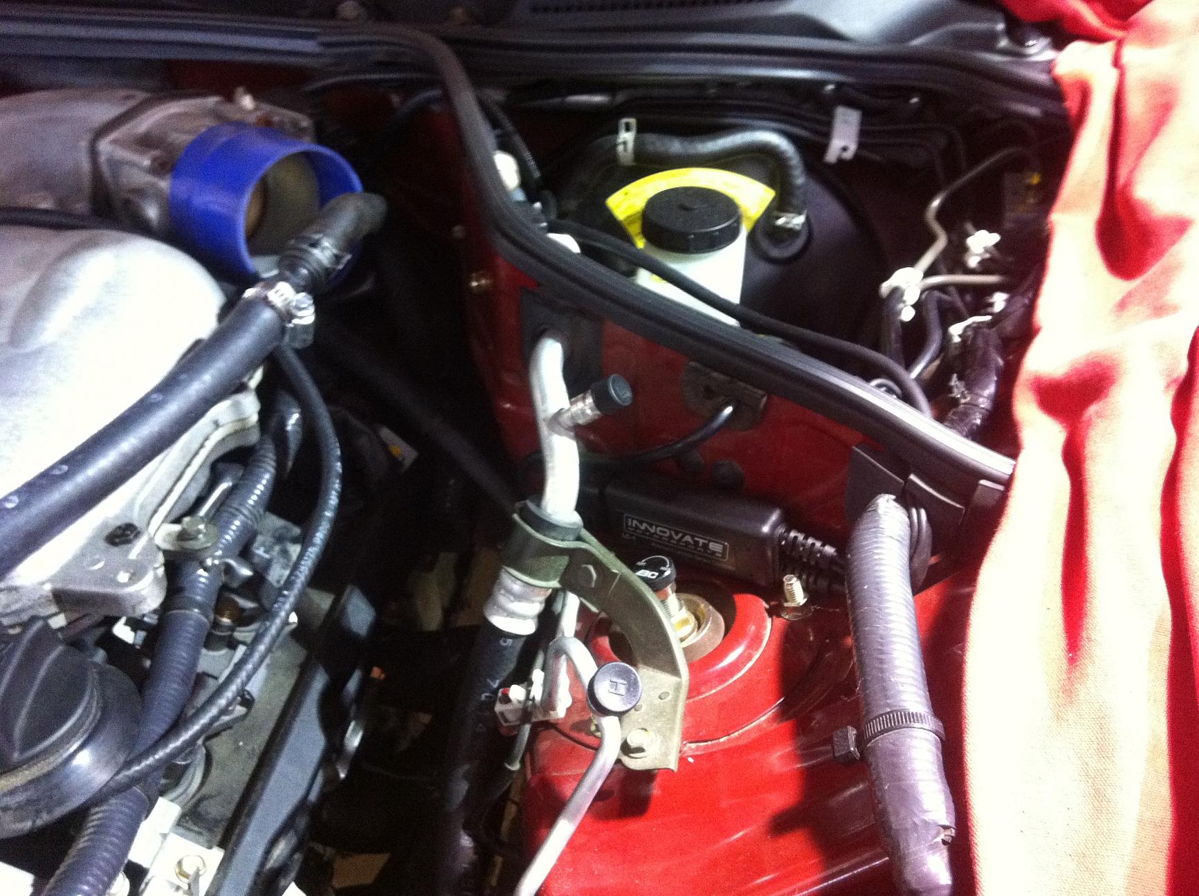

I have a few more pics I took today... The intercooler looked like it was 90% plumbed in and the necessary mods to it are done from what I could tell. I'm not sure about what's happening with the wastegates... Cam seems to think it's as easy as adjusting some "crack" thing-a-madgiggy while the shop doing it seems to think that they can be adjusted "up" but not "down." Cam had just spoken with Jim Wolf, so I'm leaning in that direction. They were going to conflab about it between Cam and the shop doing it. If parts need to be ordered then so be it- provided the two agree that's what is necessary. Doesn't sound like it's going to go there so I'm hoping it'll just be a matter of turning a screw or something.
Even Cam audibly winced at the thought of the cobb sustaining this system so as much as I'd hoped that it was going to do the trick I think the simple fact is that Haltech is in my near future. That or something else that someone doing the work is going to recommend. I am sort of leaning towards Haltech because I know it was one of the first systems Sasha was leaning me towards and I know if I'm going to continue to copy everything that Dustin does then I'm going to need to go that route.

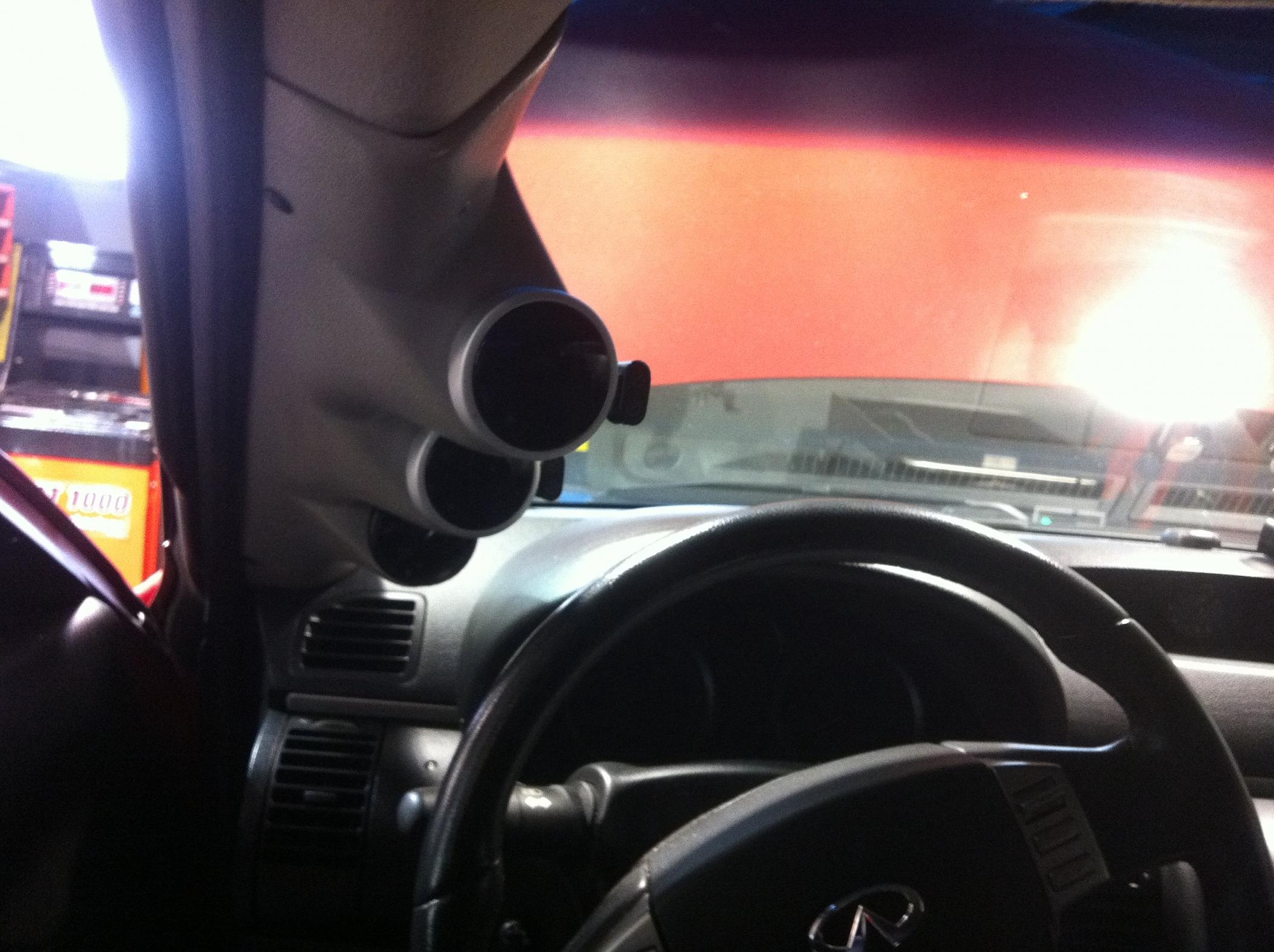

The gauge cluster is in and secured... I don't have the photos of the "turned on" cluster but believe me when I say when even the guy doing the work says "these are among the best you can get" then... well... do me a favour and just use your imagination. Even if they suck performance-wise, they look freakin' awesome. Kidding, sort of.

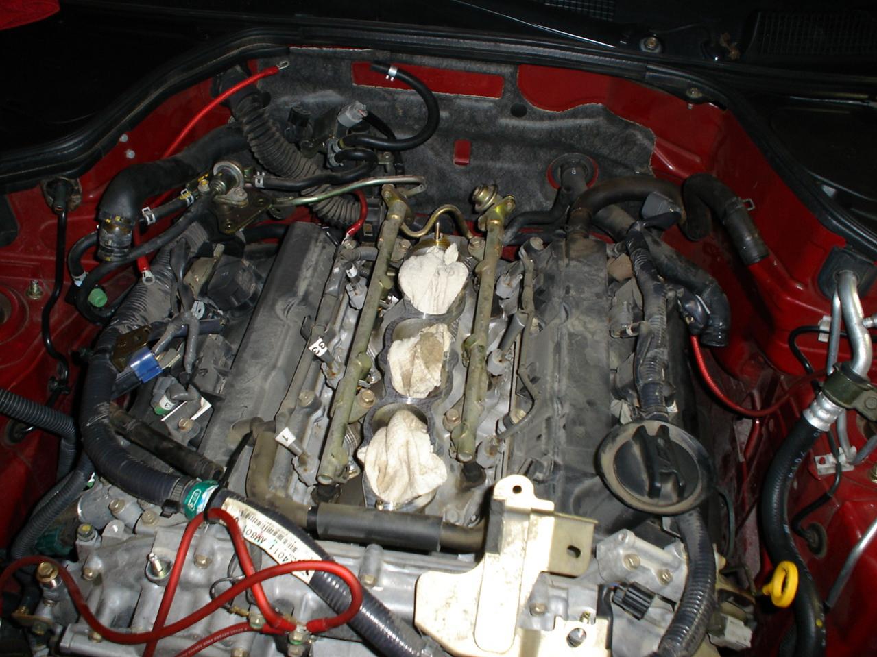

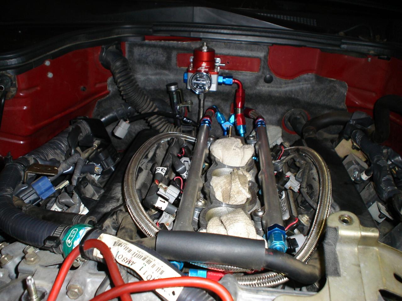

The fuel lines were run really nicely in an open spot alongside a few other lines. They did a really nice job on those... I'm no expert, I know- but alongside factory lines in the groove open for an additional line seemed like a natural spot. Speaking of natural spots- I guess the install necessitated the removal of my washer fluid tank and it has subsequently been replaced with a PVC pipe about 3" in diameter and with enough room for about "a-liter-a-cola." Anyone remember what movie that was from?

In the second picture the pipe coming from the IC through the rad support is much different than the G35 one. Mine is straight then makes one turn through the hole, Dustin have pictures of yours or recall if that was a pipe they modified it looks to fit poorly and looks like it hits the crash bar??

its looking good!! but those intercoolers look like very different set-ups from the Z to the G.
