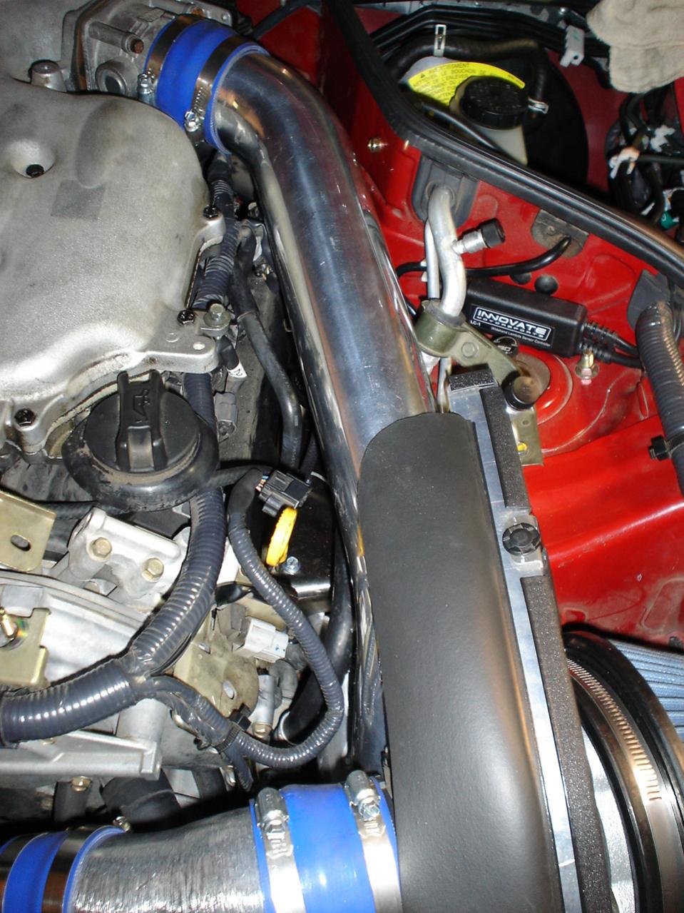

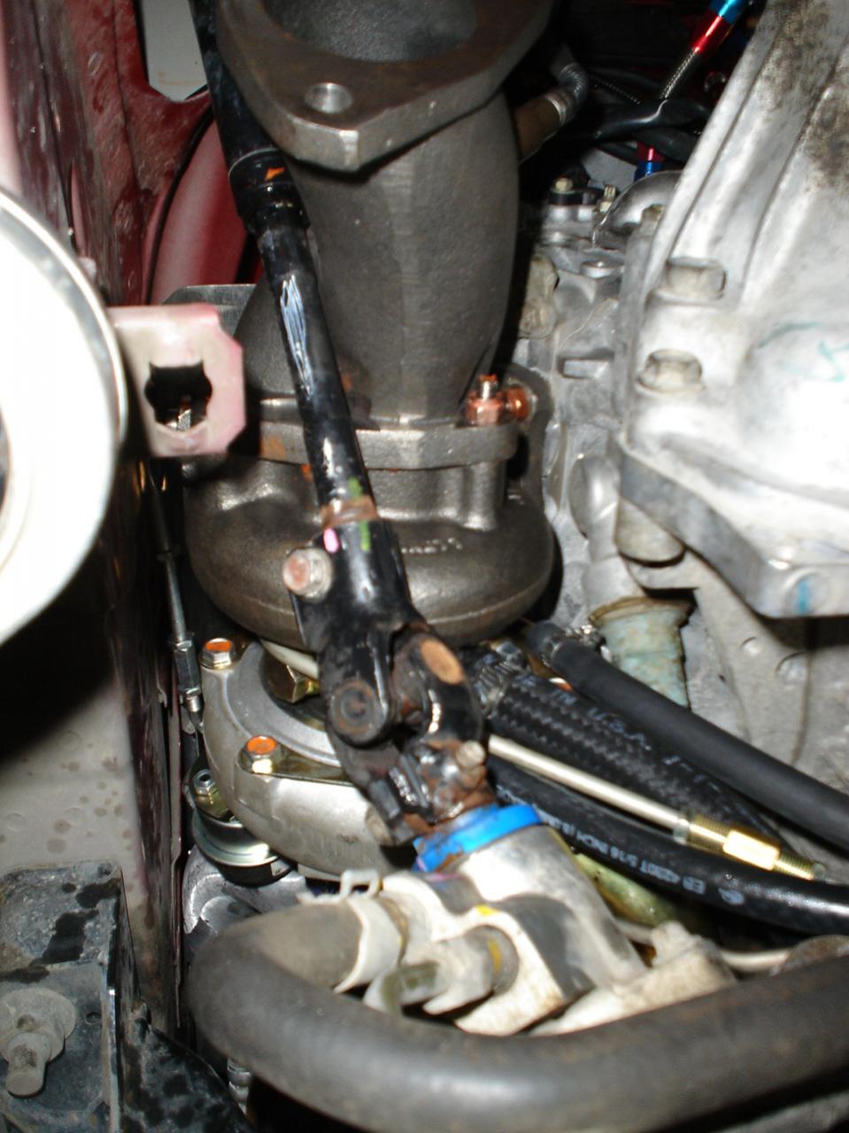

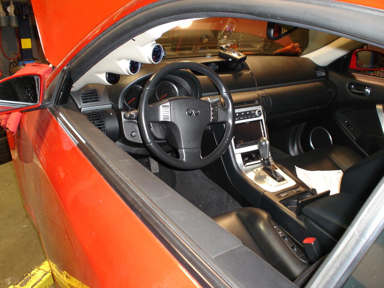

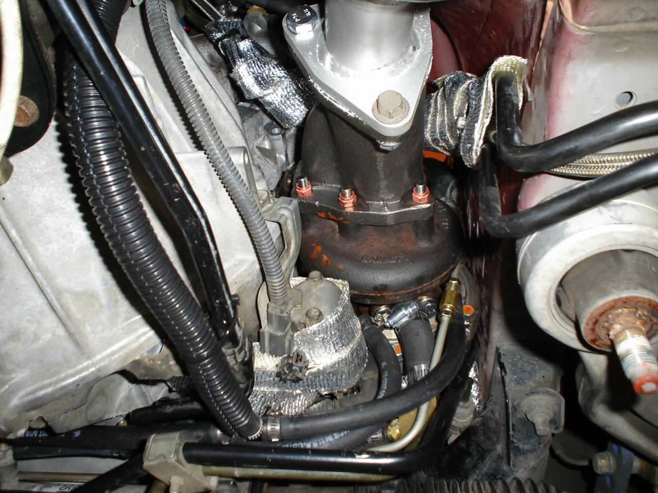

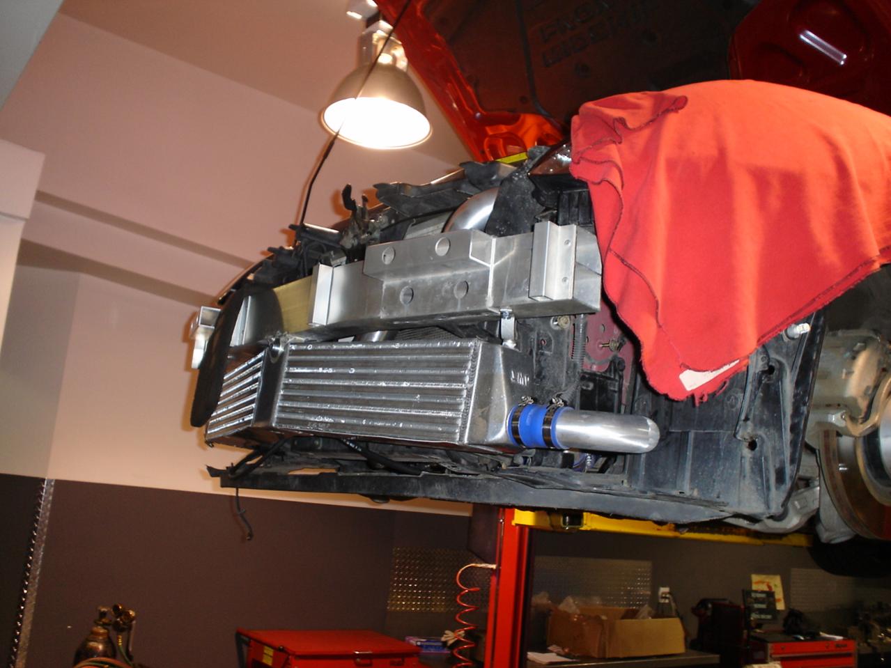

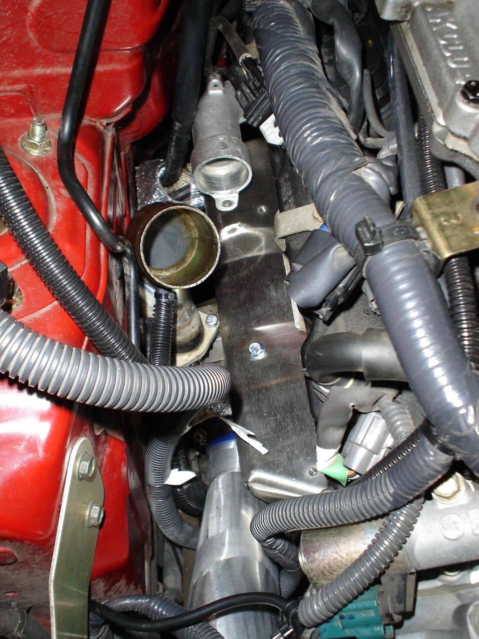

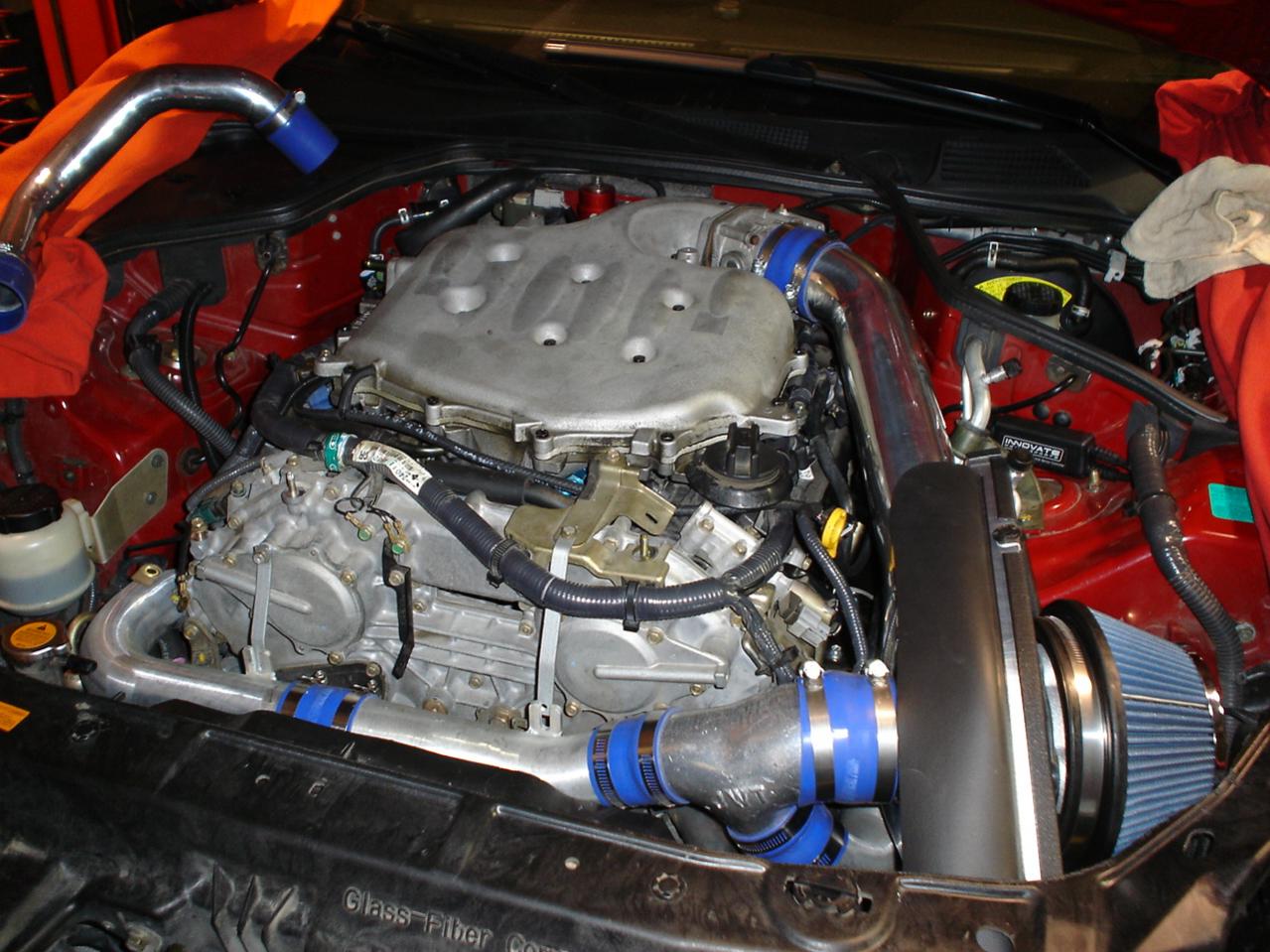

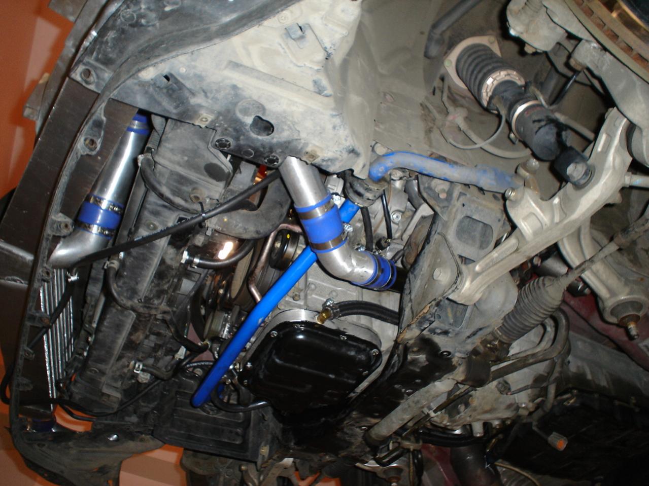

The job is moving along now that the waste gate issue has been resolved. The tech doing most of the install has sent me a new set of photos. I'll include his explanation of what's in them... though I don't think they'll post in order they're pretty easy to match up.
Here are the latest pics of the build, there has been a fair share of road blocks here and there but everything is coming together at the end of the day.
Picture 23 shows an obvious clearance issue with the left side downpipe and the steering shaft, which i was able to correct by shaving some metal off the downpipe.
pic 24 is the right turbo installed, and the oil and coolant plumbing complete
pic 25 shows the intercooler piping from the turbo to intercooler completed
pic 27 shows that a majority of the left side is complete and is how it will look upon completion. you may notice the piping in front of the engine is resting on the radiator fan shroud, another fitment issue i am running into.
pic 28 shows the right turbo installed from the overhead view, along with heat shield, wastegate actuator hose and turbo air intake piping
and pic 30 shows how nice the gauges look

The last 3- 28 29 30.
Attached Thumbnails FI: we're not in Kansas anymore...-g35tt-028.jpg   FI: we're not in Kansas anymore...-g35tt-029.jpg   FI: we're not in Kansas anymore...-g35tt-030.jpg

its looking really good dude! i would be careful with that steering column clearance tho.

The guy at the shop was saying that you couldn't adjust the wastegates down, but that they could be adjusted up. Cam talked to Jim Wolf about it last week and JW told him that they could be dialed down to the required settings... I'm assuming to those we've already discussed- opening at around 6 and fully open at 10.
As for the clearance issues, I winced a bit but I knew it was going to be very tight and things like that were inevitable.
