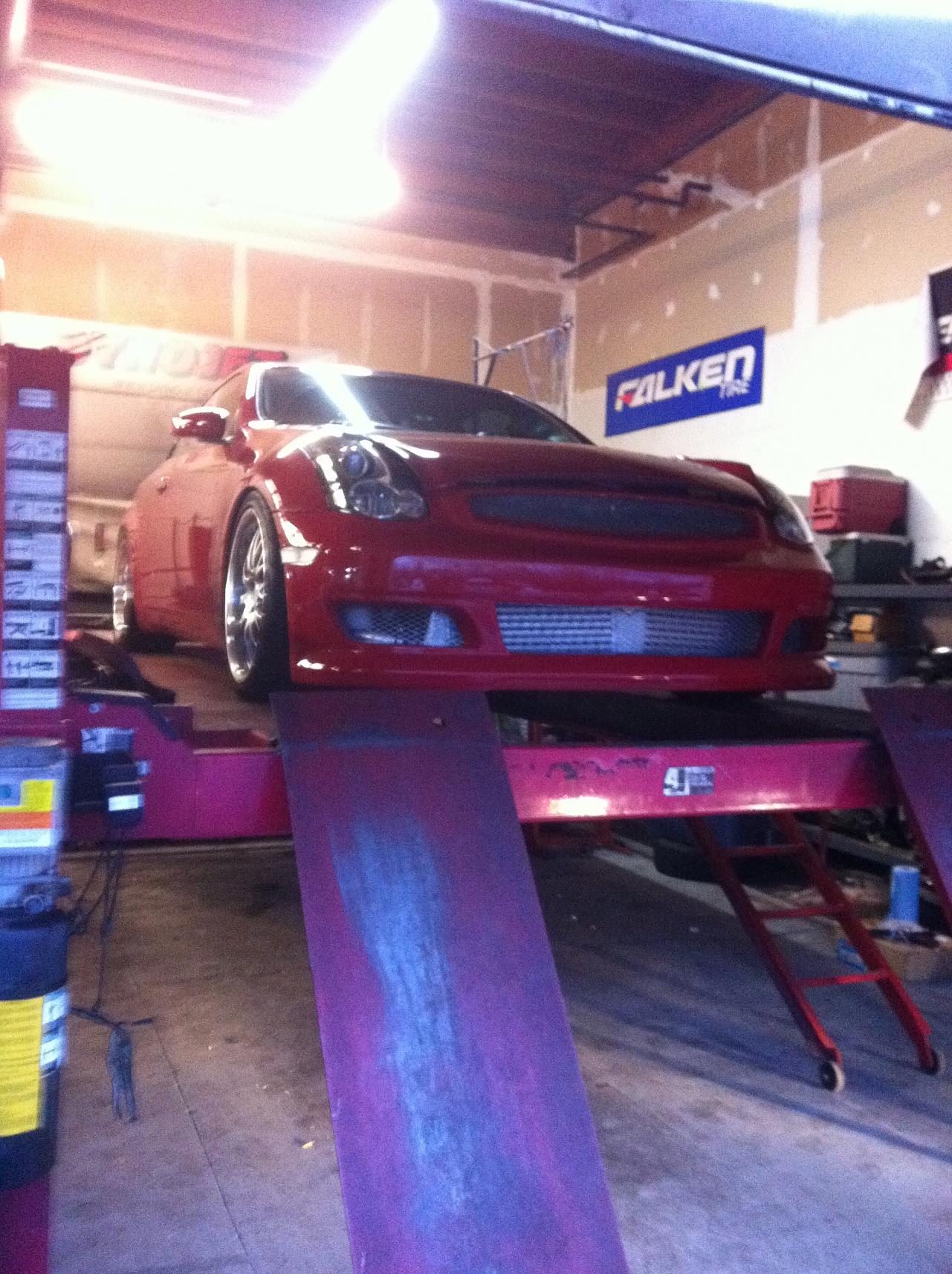

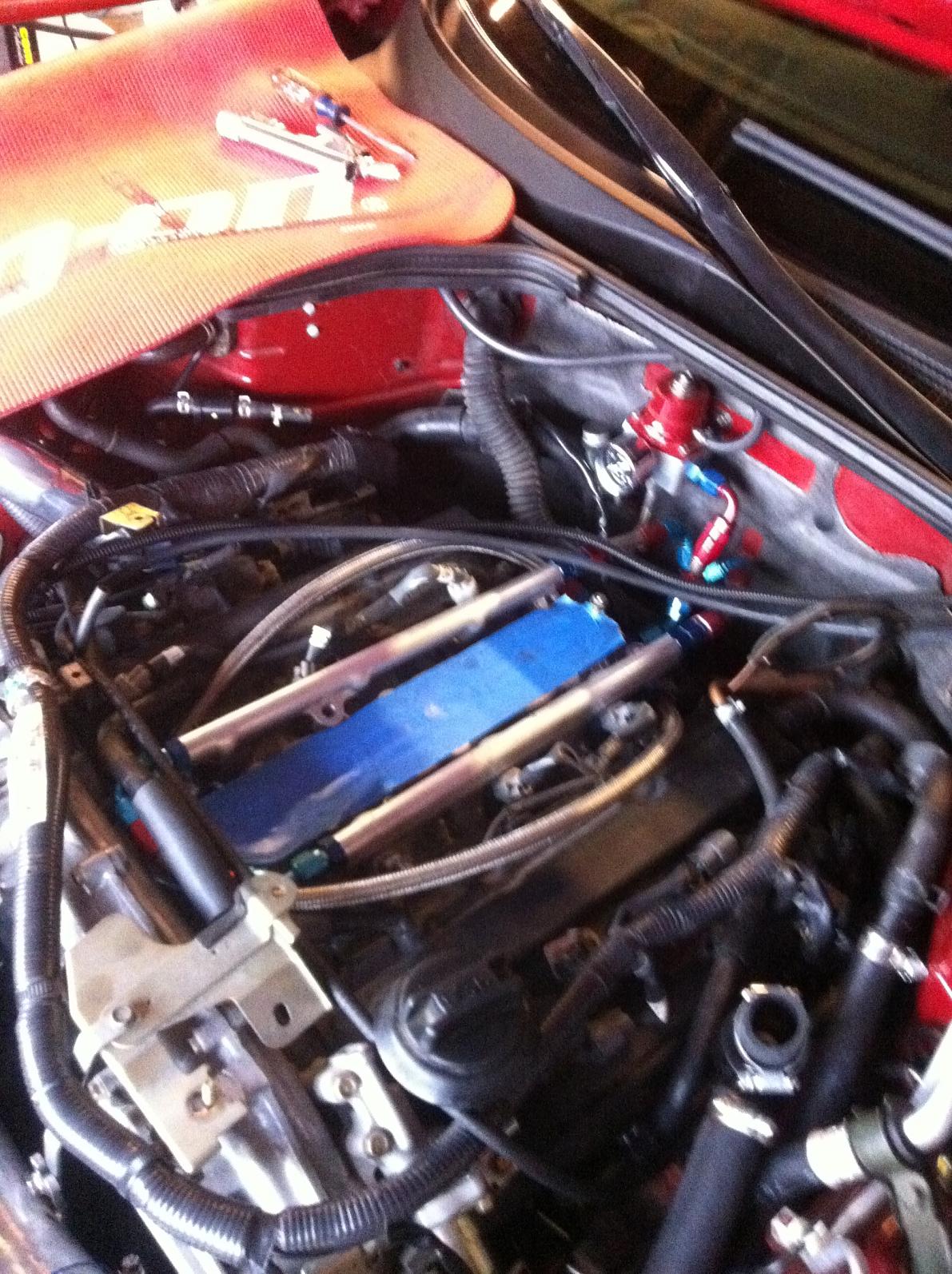

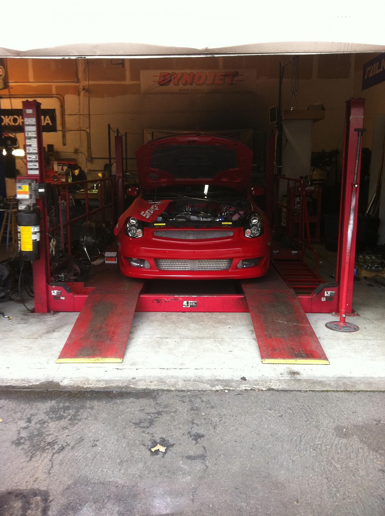

Okay... so a couple of things weren't quite right with the build- not outright wrong, but not quite dialed in. Which is fine- everyone has their experiences.
The few things that I remember were in need of adjustment:
1) Spark plugs. Apparently plugs are rated for heat- the lower the number, the hotter the plug. It was explained to me that with the FI builds a cooler plug is better. I think they said that the stock plugs are typically a 6, and the plugs that were in my car were a 5... or if stock was 5 mine were a 4... can't remember offhand- but it was a hotter plug and that wasn't good. The gap on them was also "waaay" off- I think they said gap was supposed to be about 28 and it was almost 40... One of the plugs was showing signs of detonation. They were replaced with a greddy 9 plug.
2) Some of the fittings were inconsistent with the way they would expand and contract when heated. It was pointed out to me, and now that we're tearing it apart little things like that will get touched up and fixed.
3) The oil lines were too small for those turbos. I guess this is partly a product of Progressive working more on European cars- apparently those that are included won't provide enough flow.
4) The vaccume lines were apparently all tied in to one spot as opposed to being bored into the plenum separately and secured like that. This one was one I didn't quite get my head around- but I saw it on Seymore's engine and I think his vaccume lines basically went in separately on the passenger side as opposed to just that one little spigot at the front.
5) The tech doing most of the work has a stereo background so he had a few remarks about how he might have tidied a couple things up a little but overall he was impressed with the quality of the workmanship. When one of the other guys heard him say that, they said to me afterwards "If Mike says that then they did a pretty good job."
6) There was already some rubbing going on with some of the closer fitting parts- particularly under the air filter- back a bit between one of the... um... stainless air lines and a bracket mount for something.
7) The stock fan really, REALLY cramped up the... "charge tube?" and I noticed it had to be shaved back a bit for proper fit. I'm going to go with 2 smaller profile fans that open up some room there and are more efficient. Now is a good time to just get that over with.
8) We originally had some trouble logging into the ECU because of the COBB. Funny, because I was unloading the boxes from the original install the morning I left for Seattle and I thought to myself "hmmm, I'm just going to bring this down with me" for no reason whatsoever. Anyway, I was under the impression when Progressive said they had loaded the stock map and unloaded the Cobb that they had reflashed the ECU to stock. When they were trying to get into it with the Osiris software it was locked out. I am glad I brought the Cobb out with me- as we were able to reflash and uninstall the Cobb completely- allowing for the tune to continue. Then again... I remember joking that may have been a good thing- but I didn't mean it. Getting these components built up is what the car and the kit needs. I'm comfortable with it and I'm happy for the oppotunity.
9) I'm not sure what's up with the wastegates... but whatever they were set at was probably too high. Now, we'll not have the issue.
It took me a bit longer to get down to Kent than I expected. I crossed the border at the busy place instead of the quiet place (Peace Arch instead of Pacific X) but the drive was okay. I didn't arrive until 2:30 or so, at which point they got to work on the build about 3:30 after some visiting. They checked the plugs as they did the injectors and upgraded those to the Deatchwerks 600s. They swapped out the plugs and then rebuilt the plenum and the rest to get it ready for the tune. We had a break for lunch and supper and the tune started around 8. It was cool because a bunch of guys stayed late to work on their own projects and an engine swap on another car... music was up, folks were dropping in... pretty cool atmosphere.
When things went south, the car dropped HP and torque simultaneously- but then resumed a trend generally upwards before everything was powered down. It happened pretty fast so I'm not saying they tried to push through the drop... everything happened all at once. Looking at the fuel ratio it was sitting level throughout- where it was supposed to be. The noise that followed starting the car after was kind of a... rough idling noise- almost like a diesel... near the front driver side of the engine- the it sounded higher up... it was tough to tell.
They went after the plugs and scoped the cylinders but everything was fine there... there was no residue or signs of damage. There was some thoughts it was one of the turbo shafts... but they eventually agreed amongst the extended community that it was either a bearing or a rod...
So anyway, that's where we're at.
