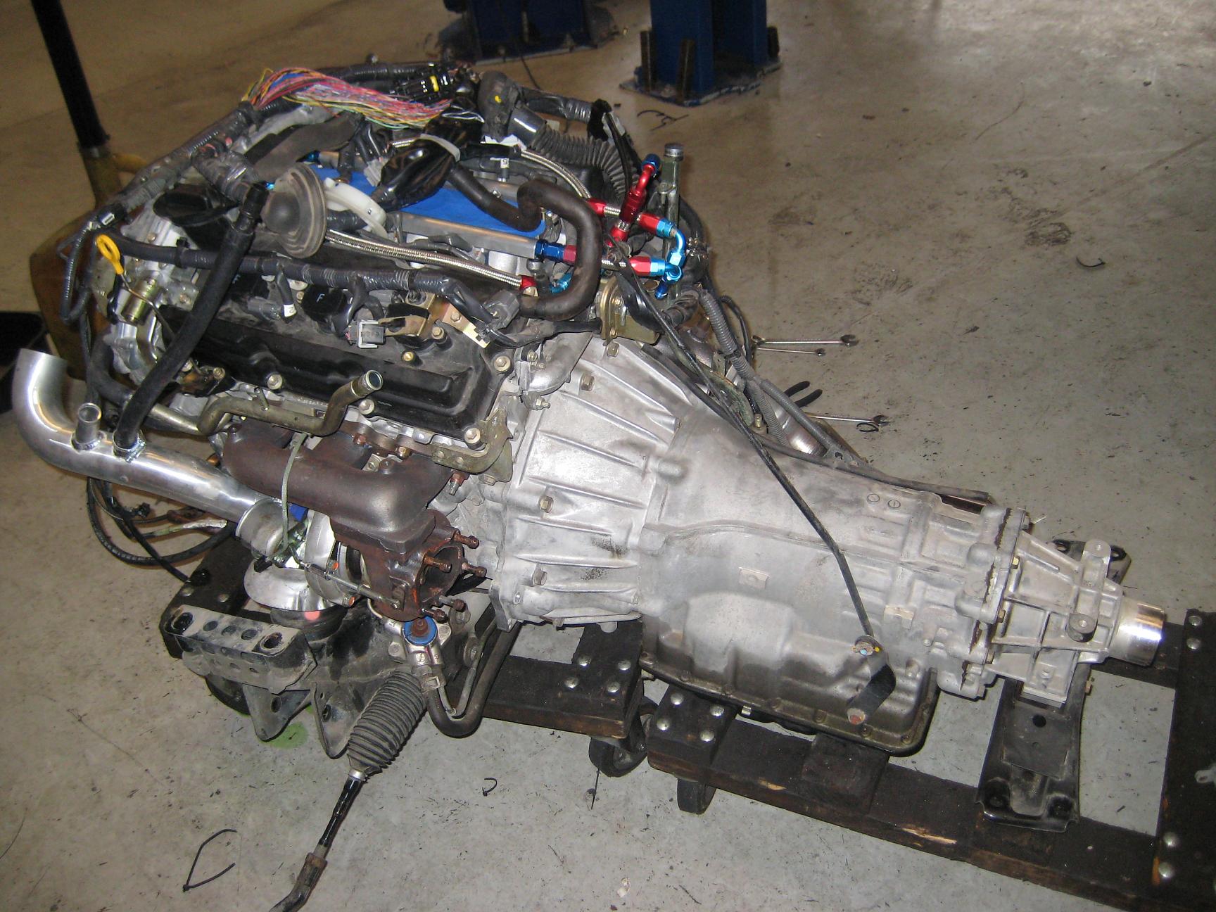

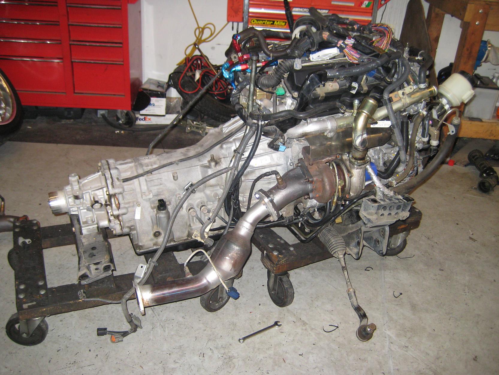

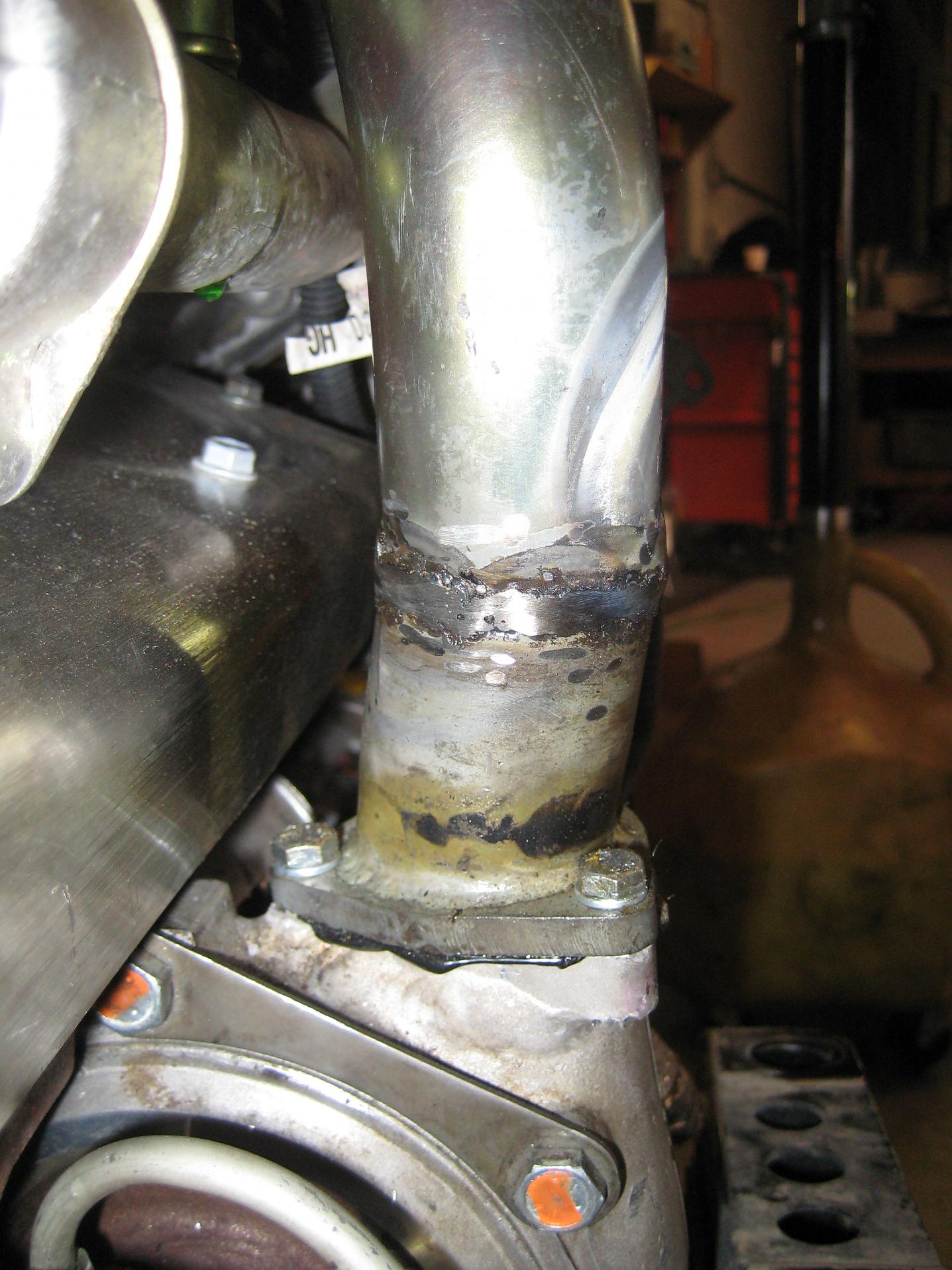

I've got some correspondence back from the shop regarding some of the discoveries that have come around as a result of taking the engine out and having a chance to inspect the deeper parts of the install.
1) First thing noticed was that the guys who did the install did not secure the front two motor mounts, and the whole motor was shifted to the side. The passenger side turbo and chargepipe were actually banging into the side of the engine bay while the other side had almost an inch of clearance. To say this discovery was a blessing was in fact saying very little indeed... and would have undoubtedly resulted in some significant badness later on.
2) The oil line issue that I mentioned before came out in a bit more detail. In their language: "The oil lines are a mess, it looks like they were using fuel line and random brass fittings to supply oil and coolant to the turbos."
3) Again, in their language: "The passenger side turbo actuator rod is loose, and the wastegate is placed crooked causing the actuator rod to catch on the cold side of the turbo, looking closely you can see a shiny spot where it has been rubbing on the turbo housing. If you look closely at picture 1 you can clearly see where its catching, and if this was catching it could cause the wastegate to not open and overboost the engine."
4) There were a few other issues that probably had less to do with the problems but may be an indication that my impressions of my original shop were off a bit. I knew it was going to be a tight fit so I expected some modifications to happen. Banging dents in stuff, grinding things down a bit... I thought that was normal and probably to some degree it is.
Anyway, thanks again to Intec Racing for their thorough inspection and efforts in getting this build cleaned up. They are in touch with me every step of the way and I couldn't be happier. These guys love what they do and it shows- if not on their website (I thought it was nice!) then where it REALLY counts: Doing it!

Engine is out... and a few other issues bubble to the surface. Some pretty sloppy work in some cases but for the most part all the things that were likely contributing to the overall problem we encountered on the dyno were already pointed out. Wastegates not being able to open, the engine front mount not being secured, the engine being crooked in the engine bay outright...
A lot of the other stuff would have degraded the build prematurely- inappropriate oil / coolant lines, crooked fitiment etc.
I'm posting some of the photos in this and previous posts as well.
Enjoy!
(Having trouble uploading- more pics to follow)
