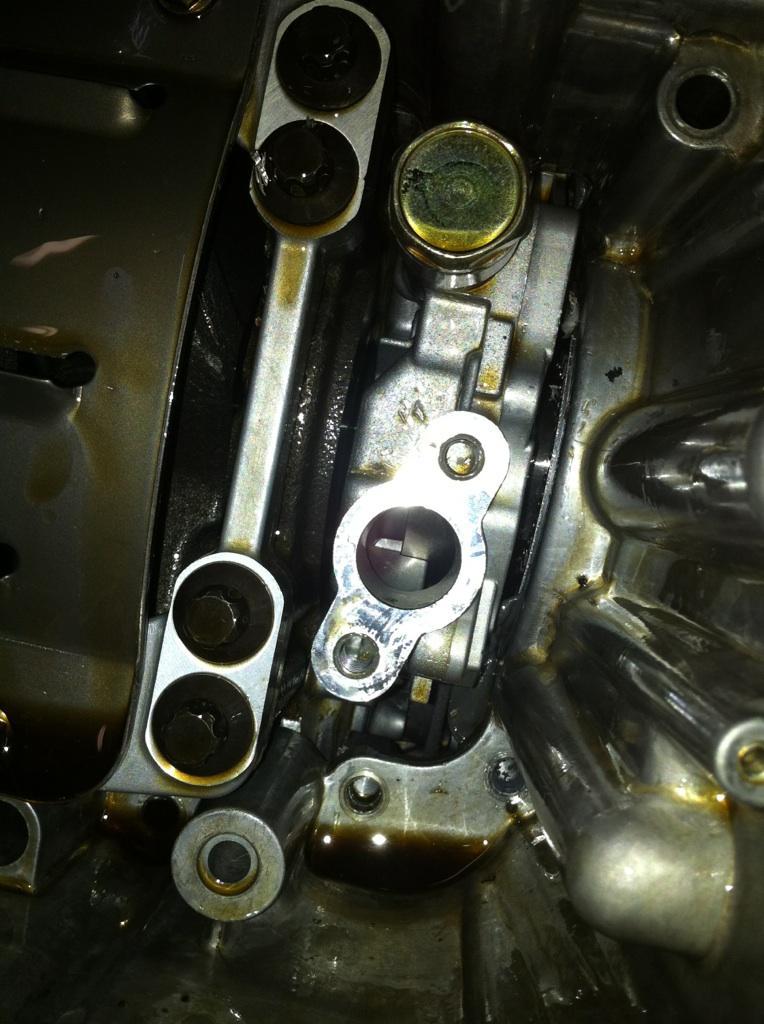

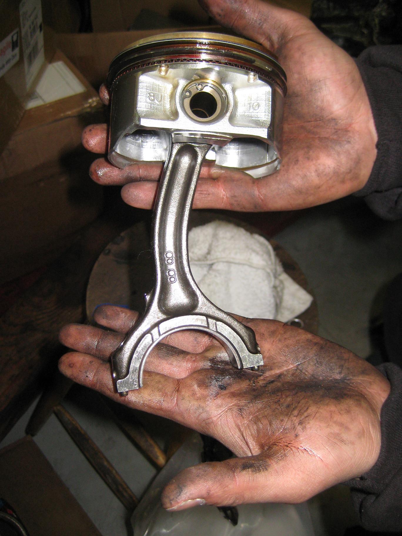

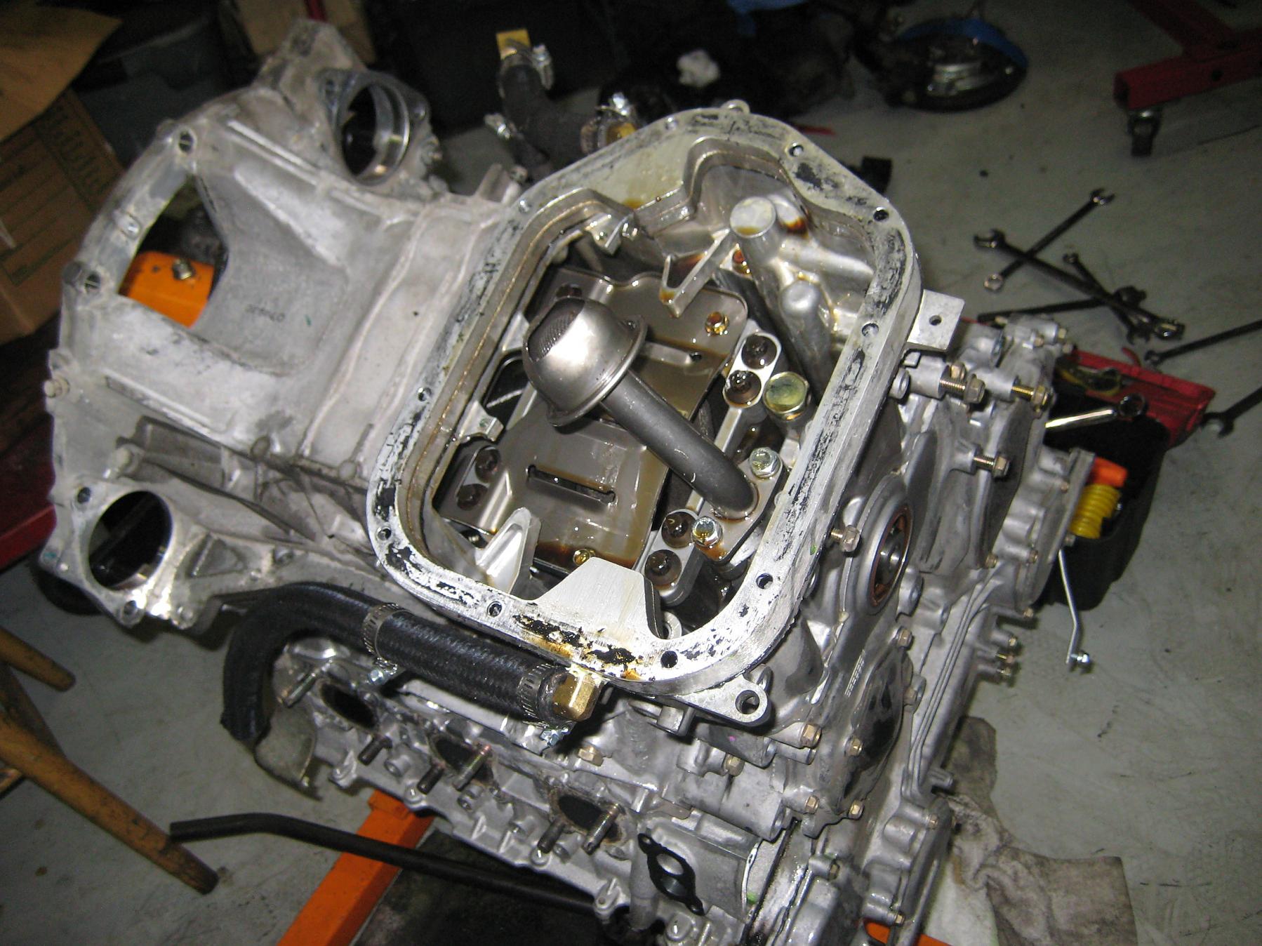

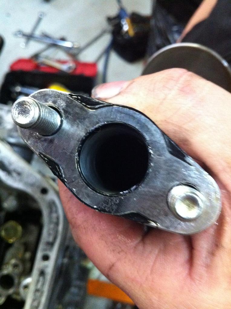

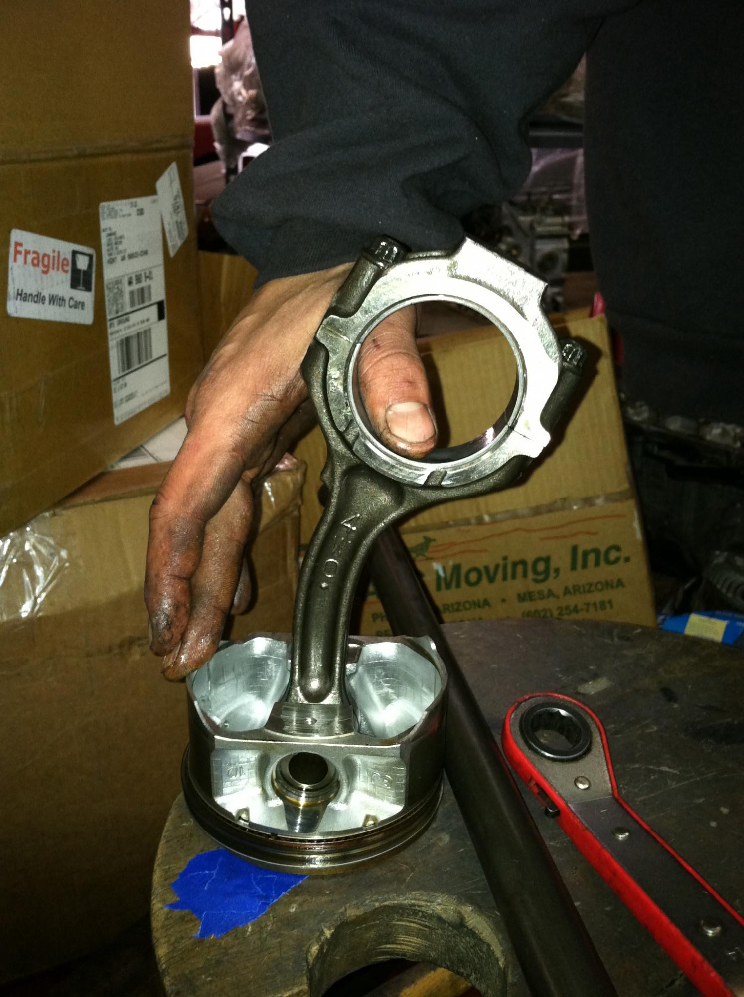

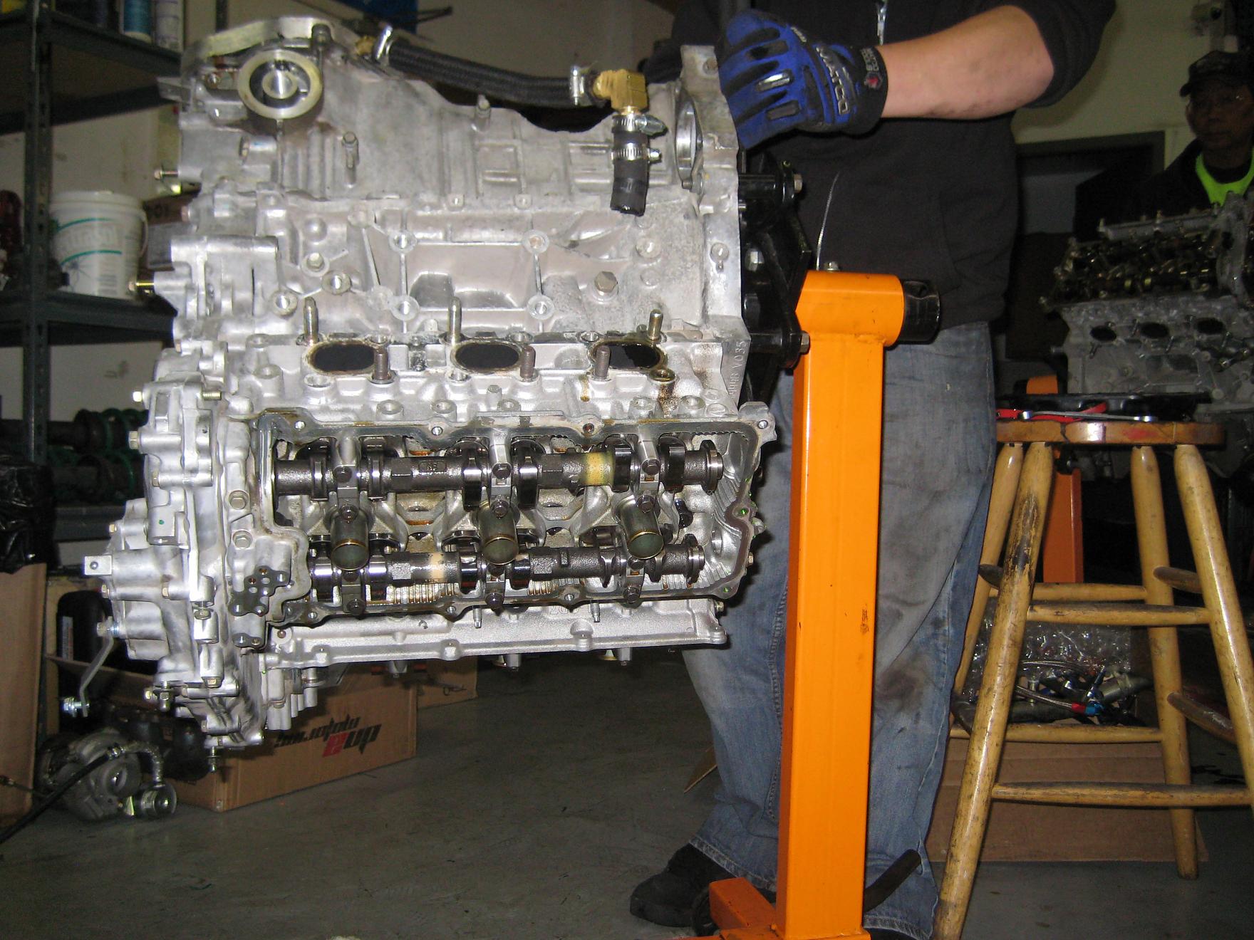

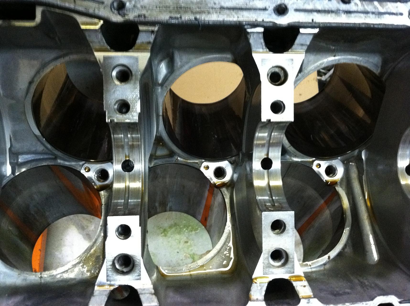

Arrow
"On a side note we're tearing into your motor, and I believe we found the source of all our troubles. With your kit it uses an oil pan spacer, and you have to put a spacer on the oil pick up tube as well. This needs to be completely airtight with a gasket on each side to ensure that it sucks only oil. On your motor when they put the spacer in the pick up tube they only used sealant on one side, and there was nothing sealing it on the top side. You can clearly see in the pictures the clean surface where there was no gasket. If the oil pick up didn't have good suction and wasn't sucking enough oil it would be fine for daily putt-putt driving but when you hit boost and it needed extra oil for the turbos it wouldn't get enough, leading to oil starvation. Consistent with this the rod on cylinder #6 was bent pretty bad, so far the block looks good, we're still disassembling to check the crank."
As an additional note in car language:
"Ceramic coating is good idea, we have a place locally that does it... Its a great idea, both the manifolds and the downpipe, but the first place to invest extra money would be replacing and cleaning up the oil/coolant lines. Especially with the rubber lines it has now, over time they'll degrade and weap oil, AN fittings and some good lines would be the first place I'd throw some money."
So I guess we're getting down to the nitty gritty now. I suspect the new lines and fittings are a no brainer at this point for longevity of the build... and I think I'll put in to get that coating done. Thanks for the tip Gord!
Here are some pics of the issue for those of you who might know what you're looking at:
Attached Thumbnails FI: we're not in Kansas anymore...-img_0464.jpg   FI: we're not in Kansas anymore...-img_5208.jpg   FI: we're not in Kansas anymore...-img_5209.jpg   FI: we're not in Kansas anymore...-img_7130.jpg   FI: we're not in Kansas anymore...-img_9718.jpg

My pick up has zero gaskets zero sealant on either side, bent rods are not caused by by oil starvation spun bearings are....

JWT does call for RTV sealant on both sides of the pick up spacer. Seems unlikely but I suppose it's possible...
Now you have me paranoid, I don't recall if I put any sealant on or not. But it ran for a full season with out any if I didn't put it on. I will have to be sure to do it when I put my 3.8L back in.
I still think oil starvation would spin a bearing not bend a rod.
Agree, and I still think the timing was all fubard up and is the cause of the bent rod.

Attached Thumbnails FI: we're not in Kansas anymore...-boomerod.jpg   FI: we're not in Kansas anymore...-img_0461.jpg   FI: we're not in Kansas anymore...-img_0463.jpg   FI: we're not in Kansas anymore...-img_0464.jpg
