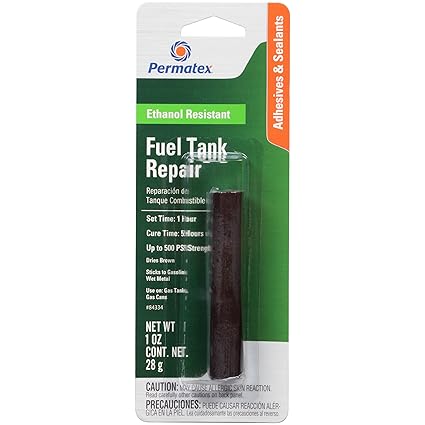

On the ground. After pulling the backseat, I discovered that the previous owner had put to long of screws in the fuel pump retaining ring and poke a hole through a couple holes.... Talked to a local shop and they said to try some tank repair puddy... So I am in the process of letting it dry.. I am also going to make a rubber gasket for mounting ring. If that fails on to a fuel cell...

I let it dry for a couple days. So far the smell is gone. Going to fill up today and see if the putty worked. Fingers Crossed. This is what I used
