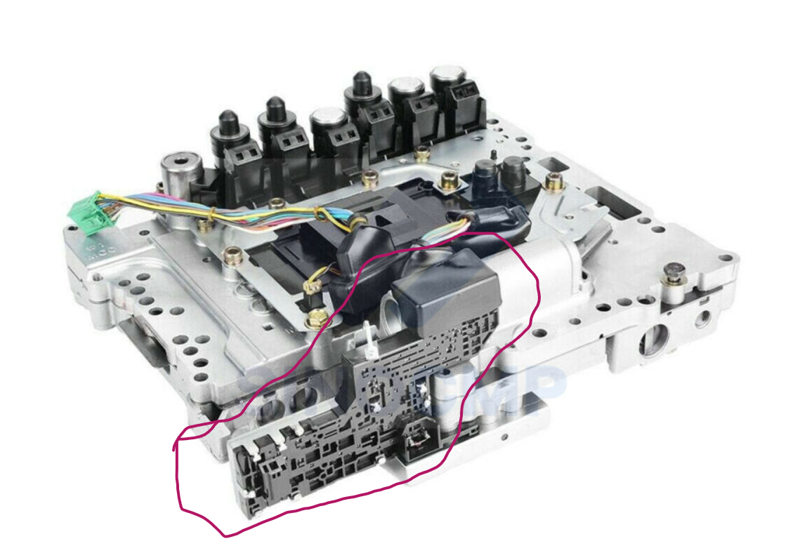

Then it's probably the PNP switch on the valve body, not sure if it can be replaced separately but it SHOULD BE. Trying to source just the PNP switch will be difficult though, probably going to end up putting in a new/used valve body.
See if you can find one from your local wrecking yard, then you can fiddle around with it to try removing the PNP switch.
