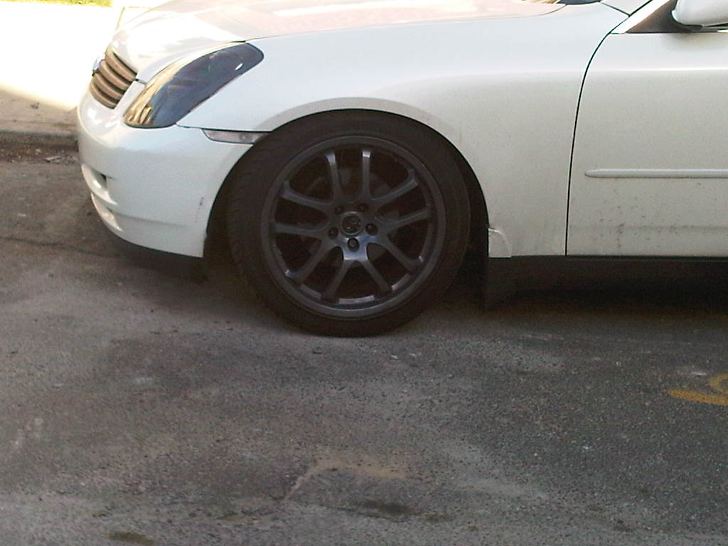

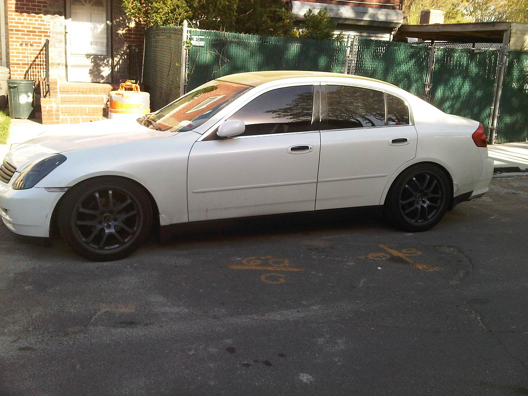

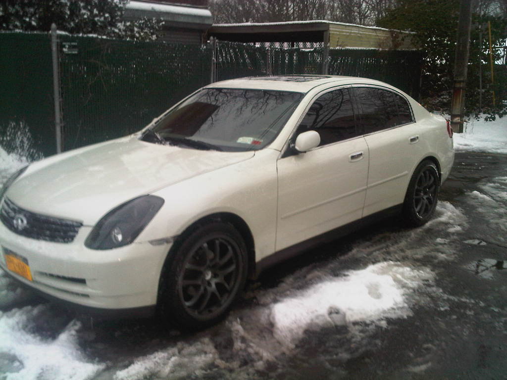

just recently installed my bc coils on my 04g35x about a week ago no...no camber kits yet but still dont know if i need one for the front also ...here is how it sits before and after
Attached Thumbnails Calling all "X's" with a lowered suspension!-img01367-20120121-1649.jpg   Calling all "X's" with a lowered suspension!-img01357-20120108-1204.jpg   Calling all "X's" with a lowered suspension!-img-20120417-04829.jpg   Calling all "X's" with a lowered suspension!-img-20120417-04830.jpg   Calling all "X's" with a lowered suspension!-img-20120417-04831.jpg

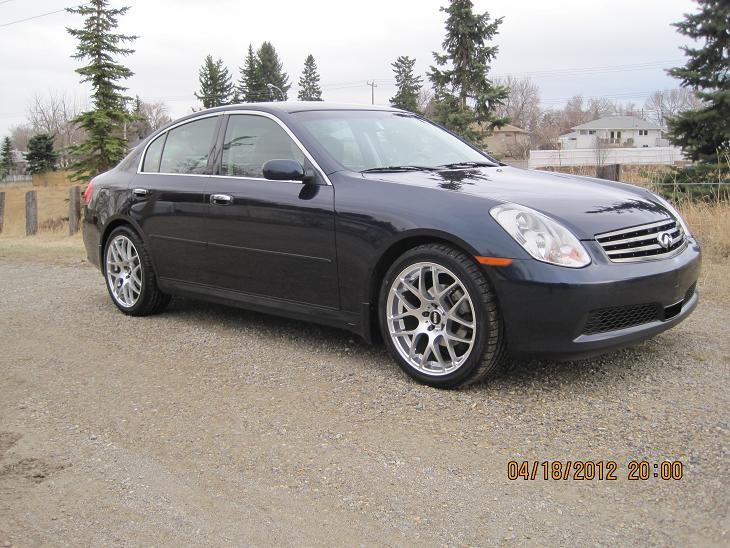

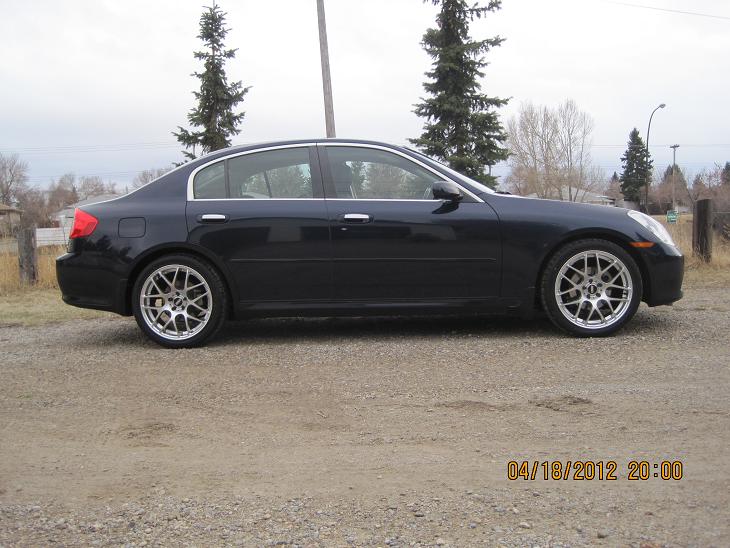

Here are a few pictures of my 05 G35x sedan with 19 inch VMR 710's dropped on coupe springs on the front and stock springs rear.
Attached Thumbnails Calling all "X's" with a lowered suspension!-vmr-sedan-001.jpg   Calling all "X's" with a lowered suspension!-vmr-sedan-002.jpg

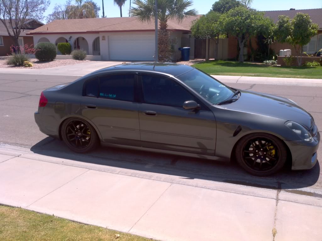

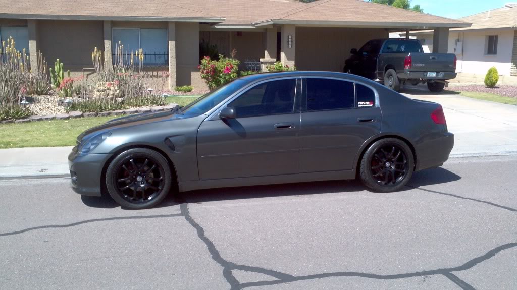

Before:
Unrevised Z Springs.
After:
Slammed on BC Coils
Conclusion = Coils > all

looks GREAT!^^... had my car slammed like that but roads here are super duper sucky... had to raise it cuz i kept busting my cv boots...

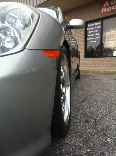

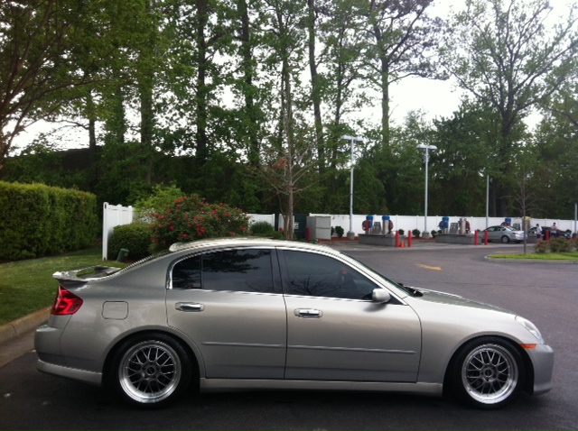

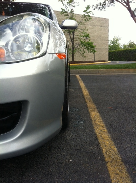

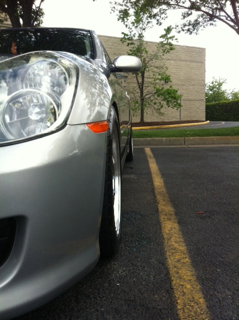

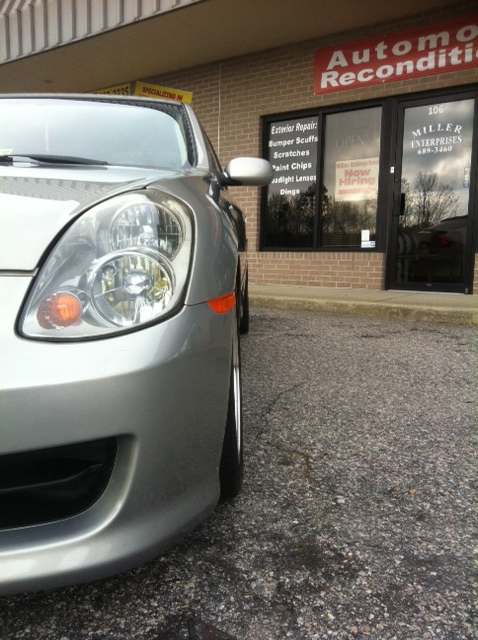

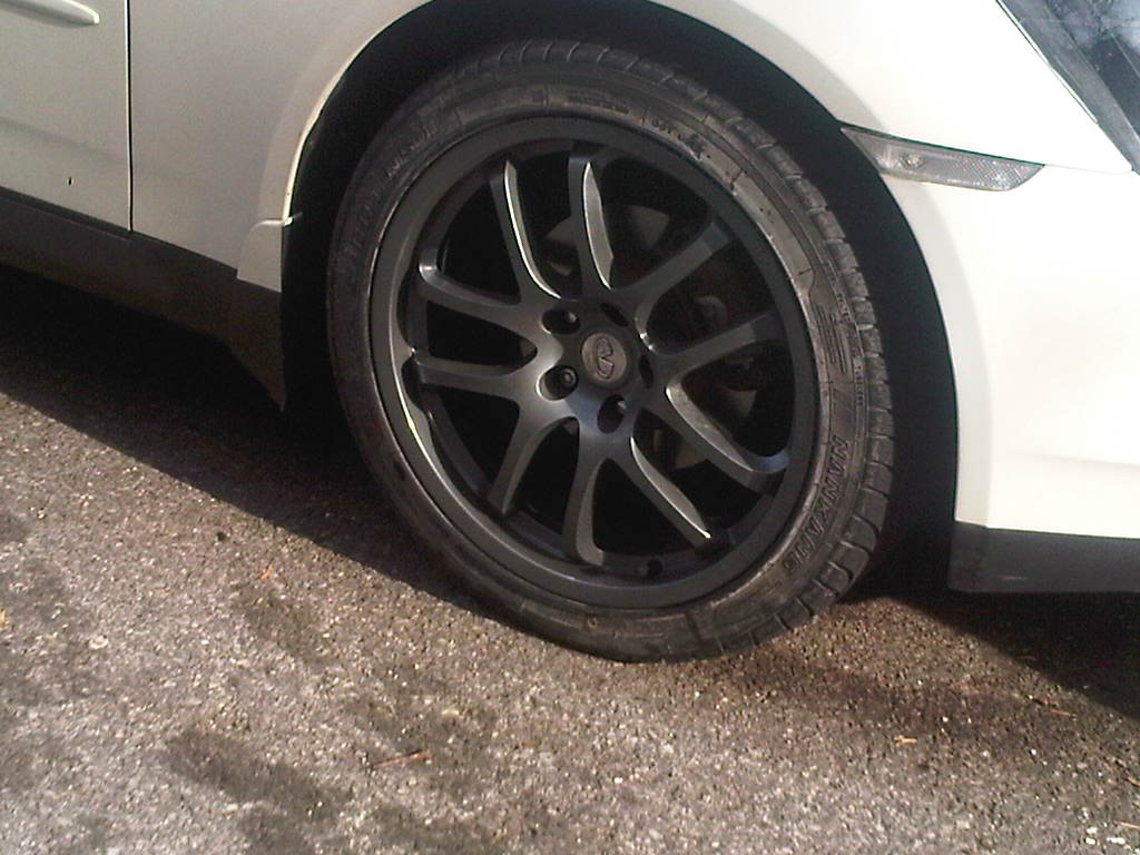

I have an 04 g35x running 18x8.5+35, 245/40/18 all around, lowered on bc coils. My wheels poked out about 5-7mm before i put my bc coils on. After i lowered it (not sure how much bc i left the spring rate and ride height the same fresh out of the box) the wheels sat nearly flush. i have the Eibach Pro SPC rear camber kit with toe bolt adjustment. Adjusted rides height and spring rates after the coils settle.... Damper setting is at 8 clicks away from hard in the rear and 4 clicks away from hard in the front. A year later i Finally found a front camber kit made for the AWD manufactured by SPC model number 72125. Just put them on and set them at -1.2 camber in the front and the rear is set at -2.0 maxed out. before the Front Camber Kit my camber was -2.2 on the left and -2.9 on the right!... The front camber kit made a day and night difference!!! Im very pleased with my set up and stance... I will be going with a more aggressive set up soon but i use my car daily to and from work and every where else, so i kept it pretty safe...... heres before and after my front camber kit..... I HIGHLY RECOMEND GETTING both front and rear camber kit.
Attached Thumbnails Calling all "X's" with a lowered suspension!-img_3875.jpg   Calling all "X's" with a lowered suspension!-img_3874.jpg   Calling all "X's" with a lowered suspension!-img_3877.jpg   Calling all "X's" with a lowered suspension!-img_3876.jpg   Calling all "X's" with a lowered suspension!-img_3873.jpg

If you mind me asking? What % is your tint?

Looks nice man ..man how much of a difference blacking out window trim nd matching door handles makes
Looks really good, you beat me to my idea. I was thinking that would be the perfect way to even the fender gaps by just dropping the front. Now I have to find myself a set of coupe fronts! How many miles do you have on your OEM struts?

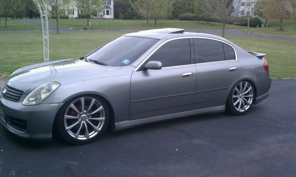

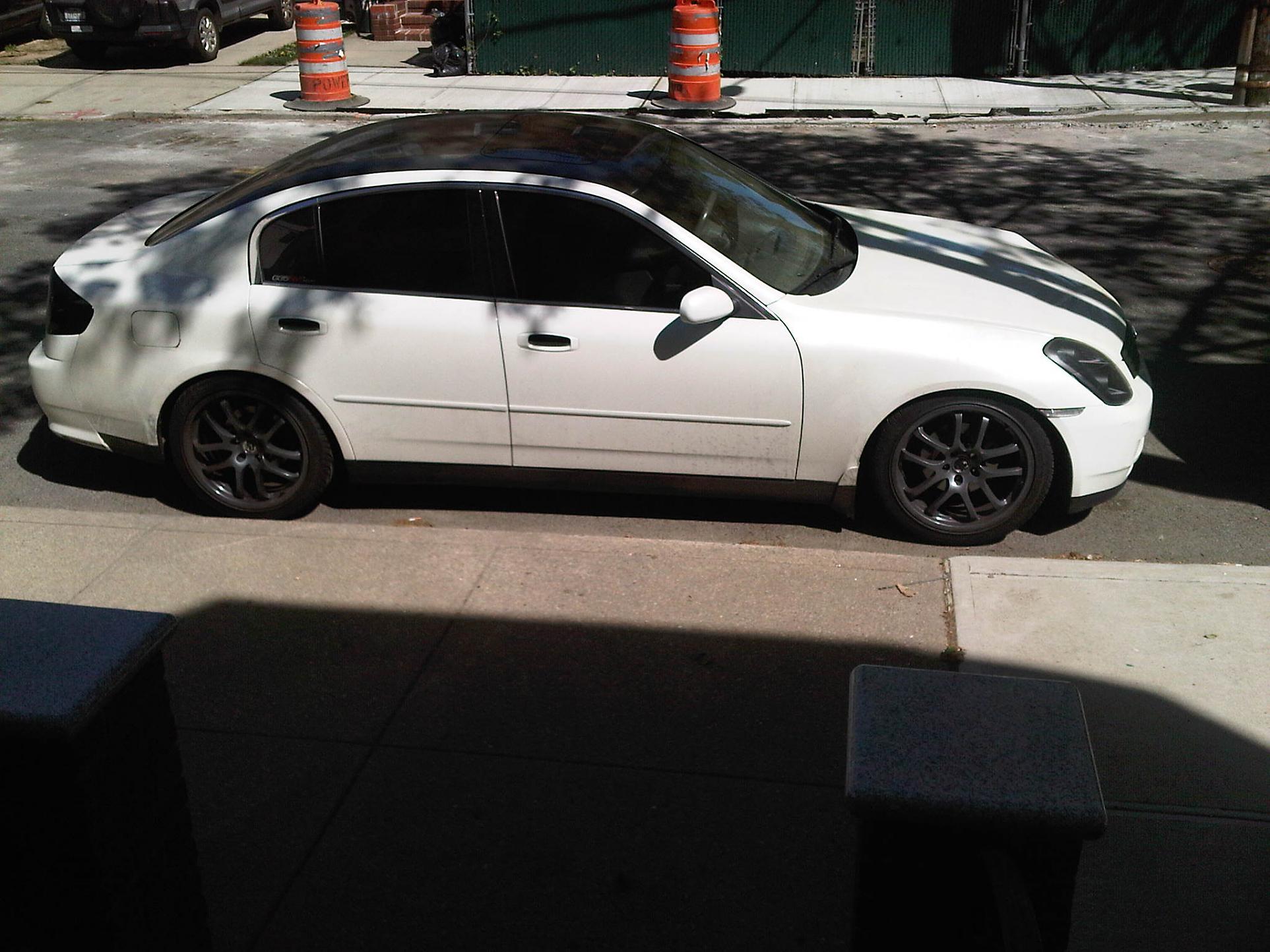

bc coils

dude... that looks so DOPE!!... are you running any spacers?
