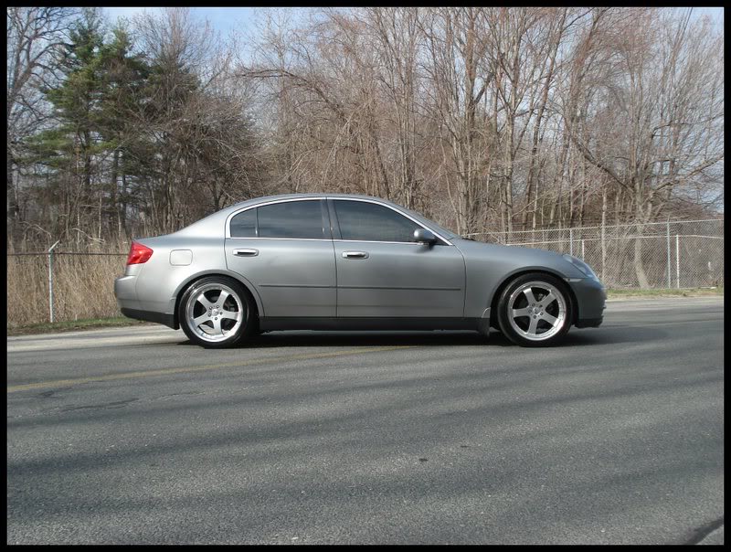

Guess I'll contribute & show my z spring/coupe spring setup as well...finally got around to giving it a good washing after getting the drop & my summer wheels back on.
