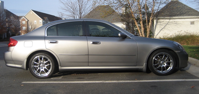

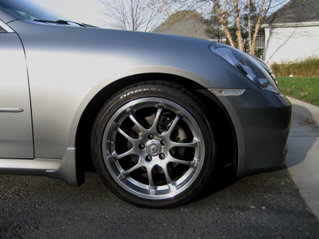

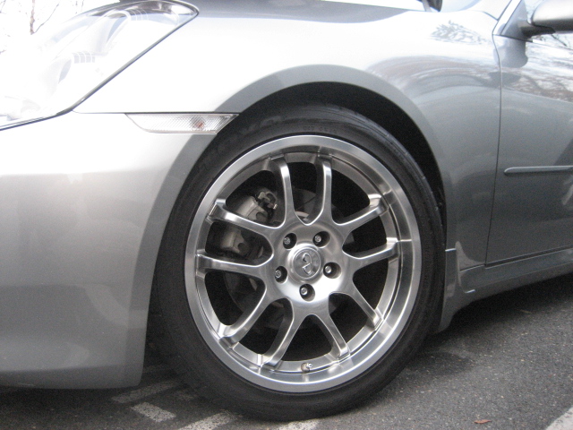

Finally put on the front springs from H&R. I am waiting to do the rear. I keep reading abut everyones back shock wearing out so I'll keep the OEM sedan sport springs (off an 06 6mt) in there for now. So far I notice a big difference in the ride. Not as harsh as the OEM sport springs. No crazy vibrations either. I have the rear camber kit (SPC) that I will have professionally installed along with the springs (easy I know) and possibly a rear sway bar. Not sure what brand to go with.
For now I am waiting on the rear because of the shocks issue. Kind of limited with the rear only choice. Does the drop look right to you guys. I kind of like the nose down look. We'll see how they settle... MTF
