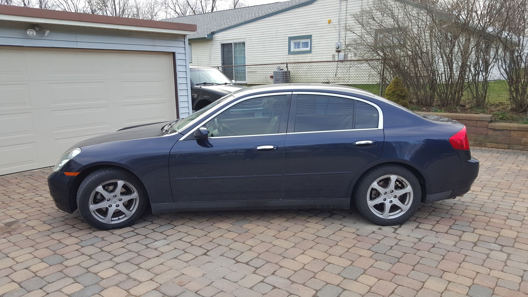

03 g35 sedan
so i bought my car about 5 months ago and im an 18 year old kid about to go to college and have no money. i want to do some very simple things to my car, cold air intake, lower it, and a new muffler. i would like to do a new exhaust but i cant afford a whole new exhaust system.... any suggestions for a cold air intake or muffler?
Old Mar 25, 2016 | 09:01 AM
  #1143
Lartytiejdke3's Avatar
Posts: 244
Likes: 989
i like how the car is from 2003 and the taillights are from 1996. very cool.
Old Mar 25, 2016 | 10:14 AM
  #1144
Texasscout's Avatar
Posts: 35,605
Likes: 2,116
From: South Texas
If you are a "poor student" as you say, here is my advice: Unless you are looking to change the sound of the car, a CAI is the worst mod for the money. Don't lower your car unless you have the money to buy tires every 18-20,000 miles. You will spend another $1000 or more correcting the alignment of the chassis to stop the tire wear.
Now what you CAN do "on the cheap", that's worth the money: look for a used HKS axel back muffler. I got mine for $150 used in good shape, easy install, sounds great. Your best "bang for the buck" is Hotchkis Sway Bars. You should be able to pick up a used set for a couple a hundred dollars. (New they go for around $350) Set them up "hard" in front and "medium" in back. It will transform the car. Then save up for a set of Tokiko D-spec adjustable shocks. If you don't mind a bit of a harsh ride, set then four knotches from full stiff. You will not believe how well the car handles. They are fantastic.
All this supposes that your suspension is good. You may want to replace all your bushings with polyurethane bushings and check the wear on the differential bushings first. They are known to leak by this age. (They are filled with silicone oil) also watch your oil consumption VERY CAREFULLY. Once you establish a baseline, you won't have to worry as much.
Good luck and get that crap off the tail lights.
