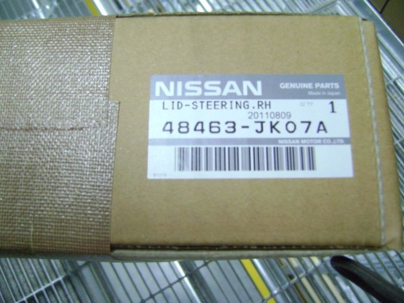

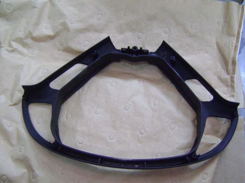

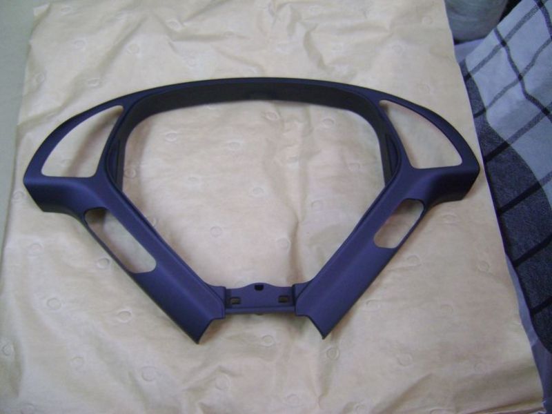

WHO IS THE MASTER OF THE INFINITI PART NUMBERS??? ))
Yes, it's ME!
So, I was right, partnumbers are:
Nissan 48463-JK06A LIDSTEERING,RH - Black (only cruise-control hole)
Nissan 48463-JK06B LIDSTEERING,RH - Beige (only cruise-control hole)
Nissan 48463-JK07A LIDSTEERING,RH - Black (both cruise-control and Navi/Bluetooth hole)
Nissan 48463-JK07B LIDSTEERING,RH - Beige (both cruise-control and Navi/Bluetooth hole)

Old May 21, 2012 | 09:07 AM
  #311
harp00n's Avatar
Posts: 479
Likes: 13
From: Ukraine, Kharkov
Originally Posted by soundmike
There's nothing that prevents you from changing just the trim yourself.
Except one thing - you can't find those part-numbers in the Nissan Fast catalog!
Only some smart UAE dealers have found them and a friend of mine from there gave me the number of the beige non-bluetooth trim from his invoice . That's how it started
