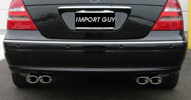

It fits 2.5" tail pipe. I measured the distance between my exhaust and nismo rear lip and it's about 6.5" so 7" would make it stick out .5" which is what I'm after. My ideal setup would be 3.5" dual oval tip like MB AMG(see attachment) but couldn't find anything yet.

The only problems with those tips are they have those nasty fitment screws on the back and that they're only 3" in diameter which would make them only fractionally larger than OEM. The cool thing about the Altima tips is they're 3.5" in diameter and they fit up against each other tightly with no gap. Using a 3" diameter tip will result in about a .5" gap between the tips. The AMG tips pictured fit snuggly against each other. The Altima tips look so perfect hanging back out there for a mere 5 minutes worth of work. You can adjust them to stick out further or even angle them down slightly if you wanted.

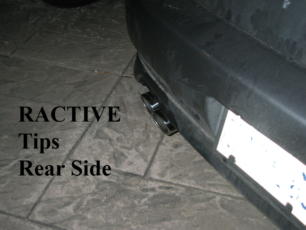

OK so I found a local store that had Ractive 3.5" oval tip 7" long with 2.5" inlet. The price was $39 which is the same as $38.99 I was quoted for Fatboy tip(these are canadian prices) from a local Nissan dealer. After 1/2hr of work here are the results. BTW I had to cut off OEM mounting brackets used for OEM tip mounting. Now I think I want to move the whole exhaust up so it is closer to the rear valance for tighter look. Don't mind my dirty car.
Attached Thumbnails New DIY mod:  2007+ Altima "Fat Boy" exhaust tips-oct2007-285-copy.jpg   New DIY mod:  2007+ Altima "Fat Boy" exhaust tips-oct2007-286-copy.jpg   New DIY mod:  2007+ Altima "Fat Boy" exhaust tips-oct2007-291-copy.jpg   New DIY mod:  2007+ Altima "Fat Boy" exhaust tips-oct2007-292-copy.jpg   New DIY mod:  2007+ Altima "Fat Boy" exhaust tips-oct2007-294-copy.jpg

thats sits really nice...great job!

G35Dude post some pictures of the tips on the car from a distance you we can get an overall look of them on the car as a whole.

The tips look great. In the first picks, you can't even tell there are tips on the car. I swear Nissan tried to dumb down the 03/04 G35 sedans as much as possible. Nasty grays lower sills, high ride height, no real wheel flaring, tiny exhaust tips, narrow body with a tall canopy, chrome lift door handles, etc. Luckily a lot of that can be improved on with a little time and money.
