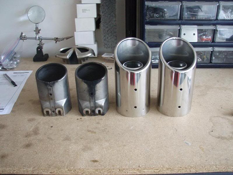

Just to clear up any confusion that might have been floating around, the tips for the 2.5 and 3.5 are not the same. I received my 3.5 tips today. The outside diameter is the same, but the inlet diameter is definately bigger. See picture below.
Even though the 3.5 inlet is bigger, it still doesn't fit on the muffler outlet without cutting!! I tried to do just a few cuts, but it still didn't fit. So I ended up making all six cuts like the OP. It fit okay, but I added a little JB Weld to make sure it doesn't come off by accident.
Attached Thumbnails New DIY mod:  2007+ Altima "Fat Boy" exhaust tips-img_0020.1.jpg

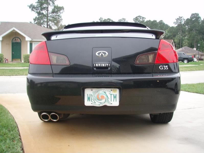

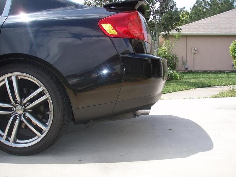

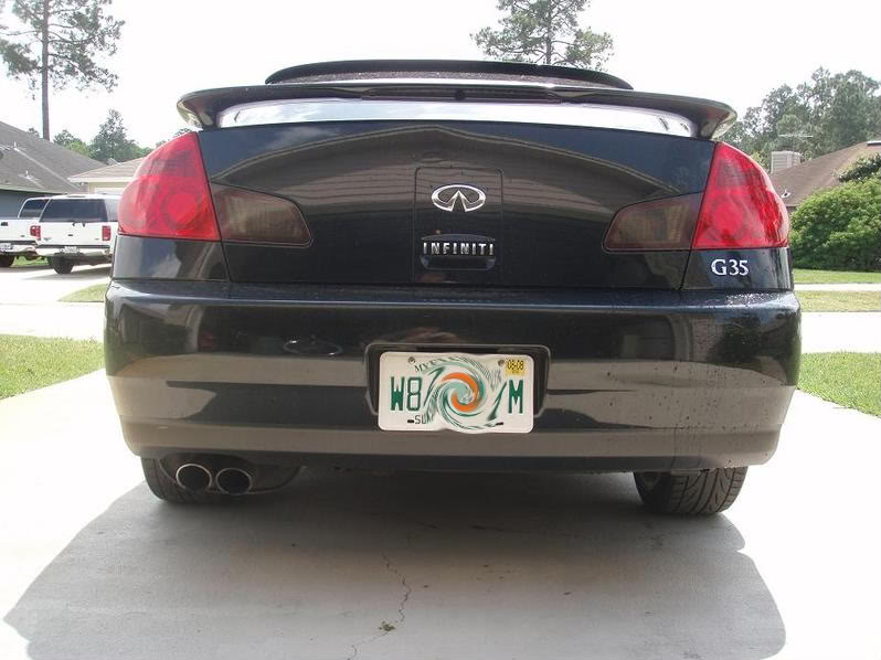

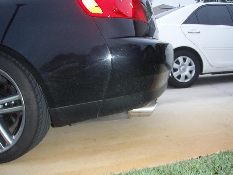

So I bought these and did this over the weekend. I did a few things different though. I cut out the ENTIRE inside of the pipe and welding them on. Also, instead of them sitting flush with the muffler, they sit straight out. If they are flush, they will point up a little bit.
Difference...
Before
After
Before
After
Add another mod to the list...

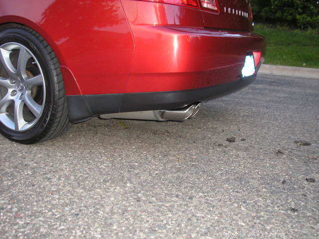

Thanks for posting up about this option. I recently lowered my car and squashed my old tips backing down a driveway. I ordered these, they were cheap, they fit, and they look nice.
