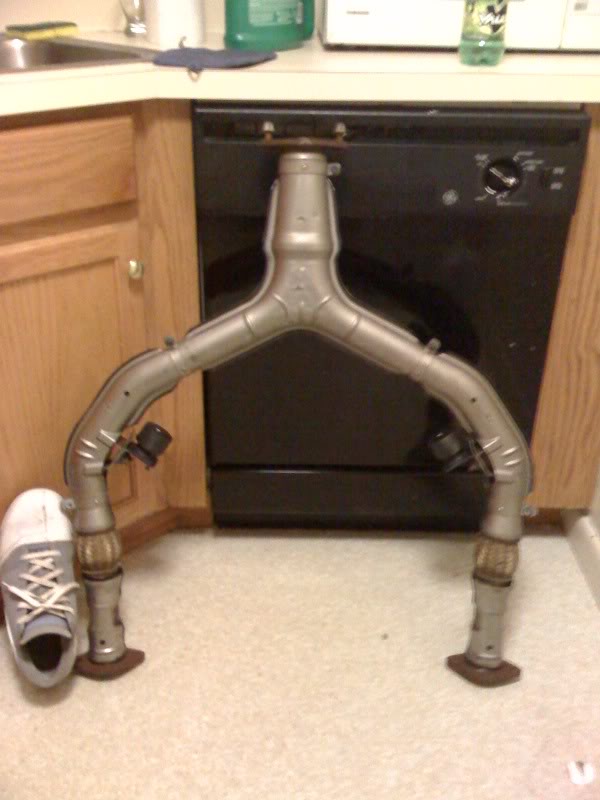

Not sure if you were talking to me, but here's a pic of the y-pipe I just bought, aka NOT the one that has been on my car.

Originally Posted by UmassG35
Not sure if you were talking to me, but here's a pic.
That one looks slightly different than my HR pipe. The shape of your Y is slightly different, the y-pipe junction is different, and the flex sections are a 3rd as long. Nissan is doing some REALLY screwy stuff if the X comes with this style Y-pipe. You'd think we were dealing with a German manufacturer
That's a picture of the one that I purchased. It's off of a g37 coupe, which explains the difference in appearance. I measured the length of the single outlet pipe on the g37 pipe and one on my car and they seemed to be identical. Granted I just marked it off on a wrench, but they both looked to be about 10 inches or so from where the pipes meet (the casing anyways) and the outlet
This looks VERY similar to the Y Pipe I've got. pic coming soon.
Now that you mention it, the Y Pipe DID come off of an "X" model 05...
I do notice that the X comes with these y-pipes that are similar in looks but yet different from the 07+ 350z ypipe in dimensions.
One explanation for having such a long section before the convergence is to give clearance for the extra transfer case. You should see the same design in the Stillen Gen 2, which was designed to clear both RWD and AWD models
