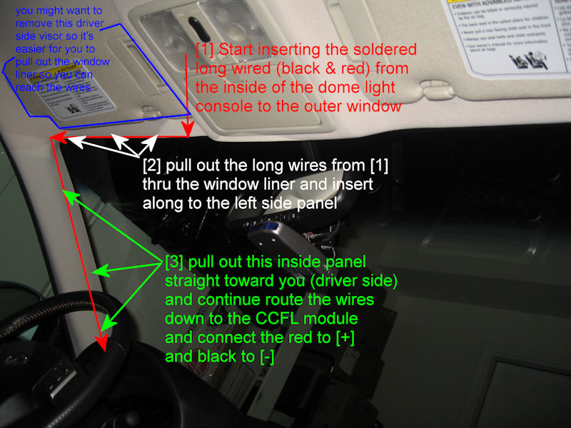

Algy, look at the attached image on how to route the wires from the dome console.
Attached Thumbnails LED under glove box/steering wheel help-ccff_wires.jpg
