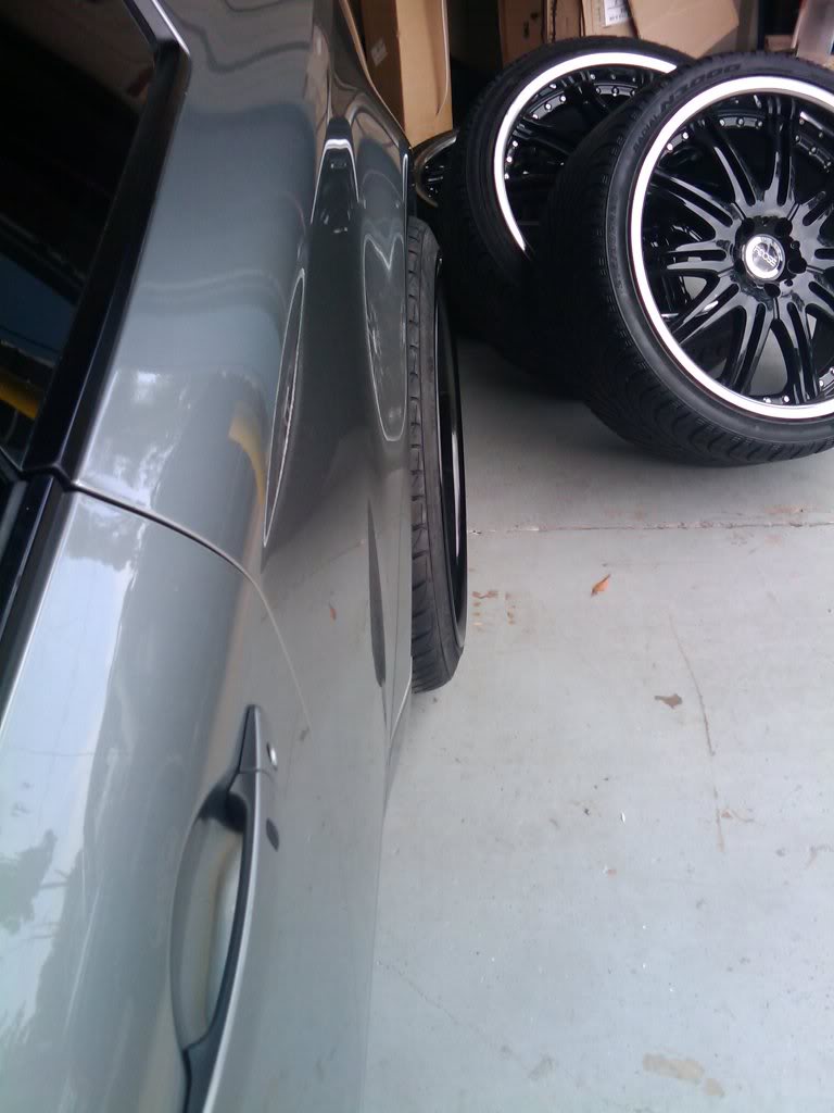

I just bought these wheels and im having a issue with it sitting flush. The specs are 20x9.5 in the front and 20x10.5 in the rear. their poping out about 1 inch from the back but the front is flush. What should i do?

Camber it, or run a smaller tire!
Are your fenders rolled?
No, but that was my first guess.
I took it to a body shop and was told that their was nothing i could do to fix this.
But i knew they were full bullsht

Roll your fenders first, then go from there!!!
like shane said roll the fenders and add some neg camber
whats the offsets?
if your uncomfortable running too much negative camber run smaller tires

^Im not sure what their disk sizes are so im not sure what you would need to clear the akebonos, prob normal or medium for rear, and medium or hyper for front
9.5 +10 Meduim
10.5 +5 Normal
9.5 +10 Meduim
10.5 +5 Normal
Quote:
whats the offsets?
front +15 R diskwhats the offsets?
back +0 O disk
Im rolling my fenders later this week but i added some neg camber today.
