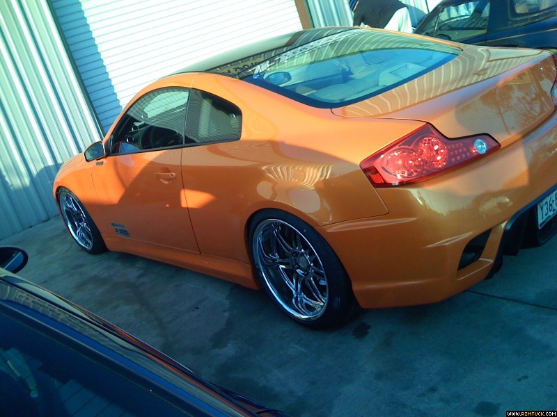

Here is one running 11 +15 at the rear - but it is running HEAPS of rear camber to keep it flush with the guard. He would chew through the inside of his rears tyres very, very quickly.
Its hard to tell by the pic, but that rear camber looks less than 3 degree.

^^^ bollocks .... look at the difference in wheel angle from vertical from the front to the rears. Given the front should have around one degree of camber already, the difference is huge.
No way in hell he's running that much negative camber to make those fit, especially at a +15 on an 11" wheel.
I know this first hand... and my camber is in spec, as well as others that I've seen in person.
Edit: Just realized that car is posted on rimtuck. Too bad this car is no more. Some dude from the east coast wrecked it after he bought it from Chris Beardon's brother. You wanna see some camber, then here you go. Shane's Car, that's camber.
