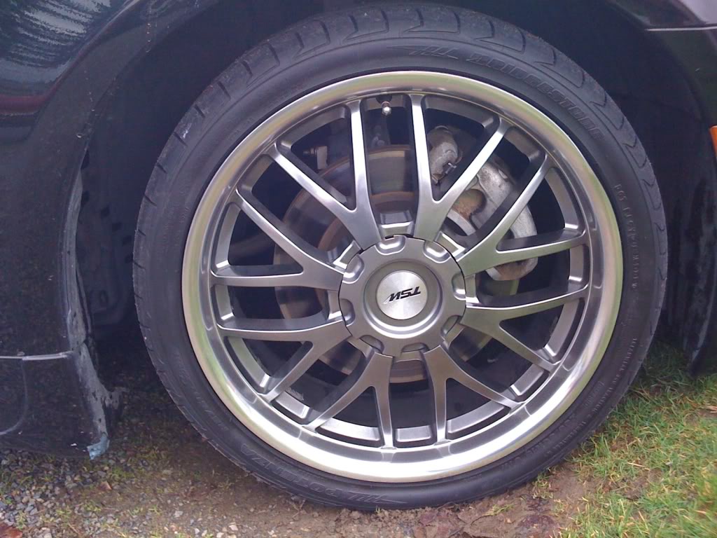

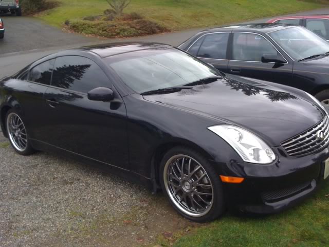

  #2823
MissG3Five's Avatar
Joined: Jan 2012
Posts: 8
From: Mill Creek
I'm a noob...
Just put on TSW Kyalamis - 235/35 19 non staggered. Not sure what the wheel width is, but it's narrower than the stock rears.
Should I be concerned with this set up, any problems having narrower wheels on the rears?
Firestone who installed them, recommend that I get larger rear tires with my stocks back on or get a wider pair of rims in the rear.
Not sure if they're just tryna bang out another buck though, because I know the guy who installed them.
How can I make the wheels look more flush with the fender?

Originally Posted by MissG3Five
I'm a noob...
Well there isn't any issues that will come of it, but the guys are somewhat right, you really should have some more tire and width in the rear of the these cars.
If you want to get them more flush I would recommend new wheels with correct offsets and widths suitable for the G35s large fenders.
I'm a noob...
