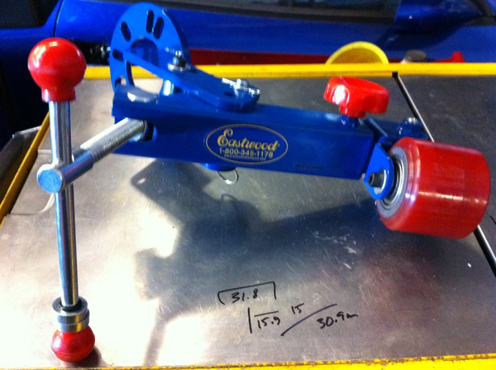

hey guys, i am going to get my front fenders pinched flat and have a question. The place i called (UMS Tuning) said that their rolling tool cannot pinch it flat. Is there something specific i should be asking for? Was he correct in saying that an eastwood fender roller will not be able to do this?
here is the pic of the roller they use
Have a Question/s About Wheels/Tires/Offsets/Camber/Etc? Ask here::-ushhx.jpg
They might be confused by your choice of words, but that tool can absolutely roll the fenders 100% flat. I use the same roller
