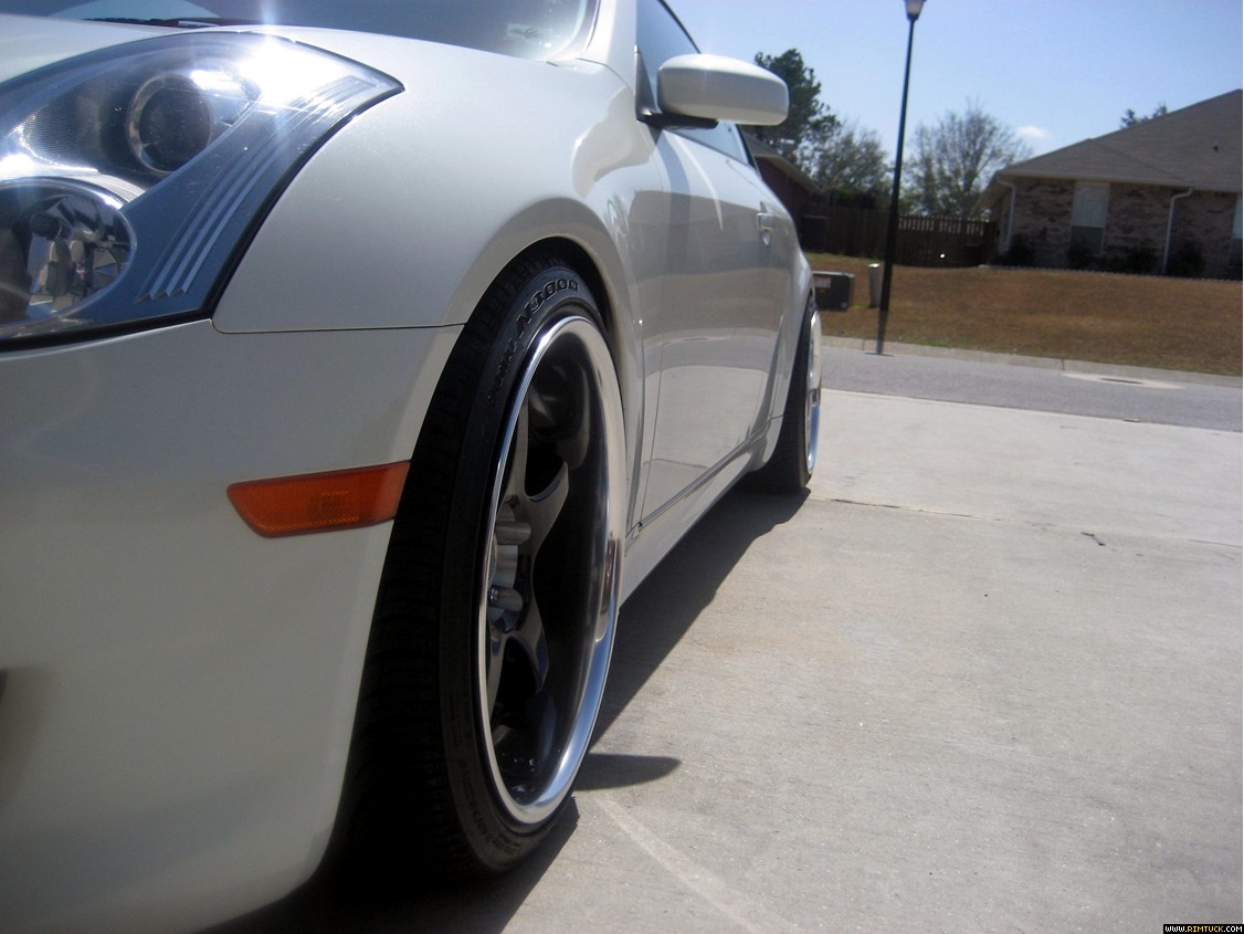

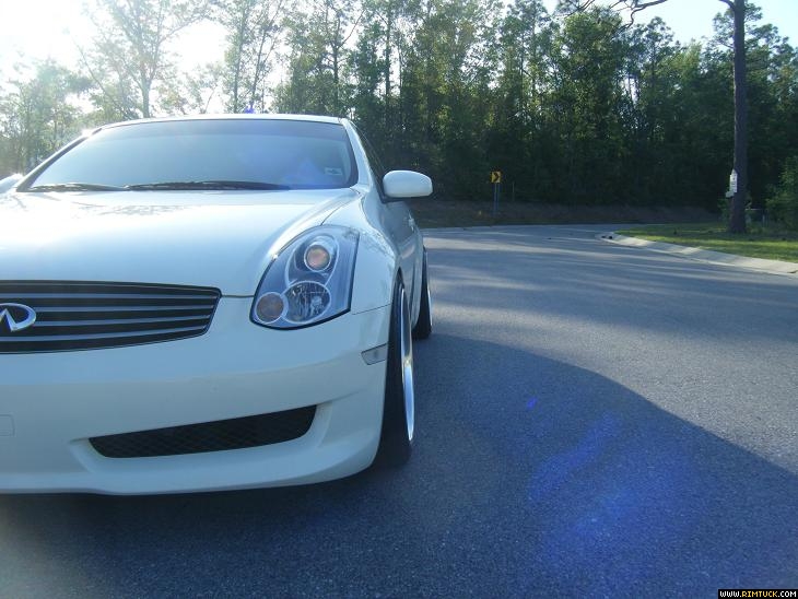

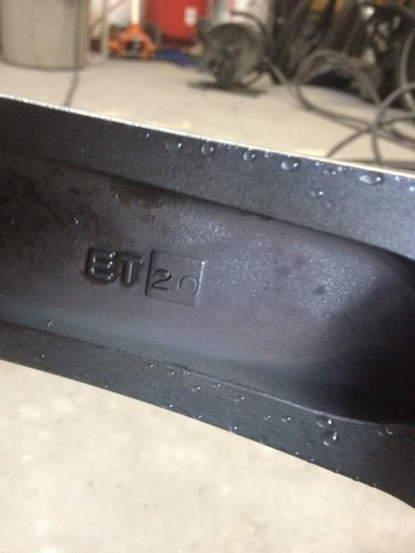

hey guys, i just bought a set of axis hiro from a guy who had them on a 350z...they're 19x8.5/9.5 going on a sedan...i'm already running that same size set up, but with different offsets...problem is, i can't seem to find the offsets for them (on the new ones)...i'm pretty sure the fronts are where it says ET 20, but on the rear it says ET _ blank square....anyone with any knowledge on this? here's a pic for ref...from what i've seen on websites, they only seem to offer the 9.5 in either +25 or +45, but that's what i've found not sure if other offsets are available

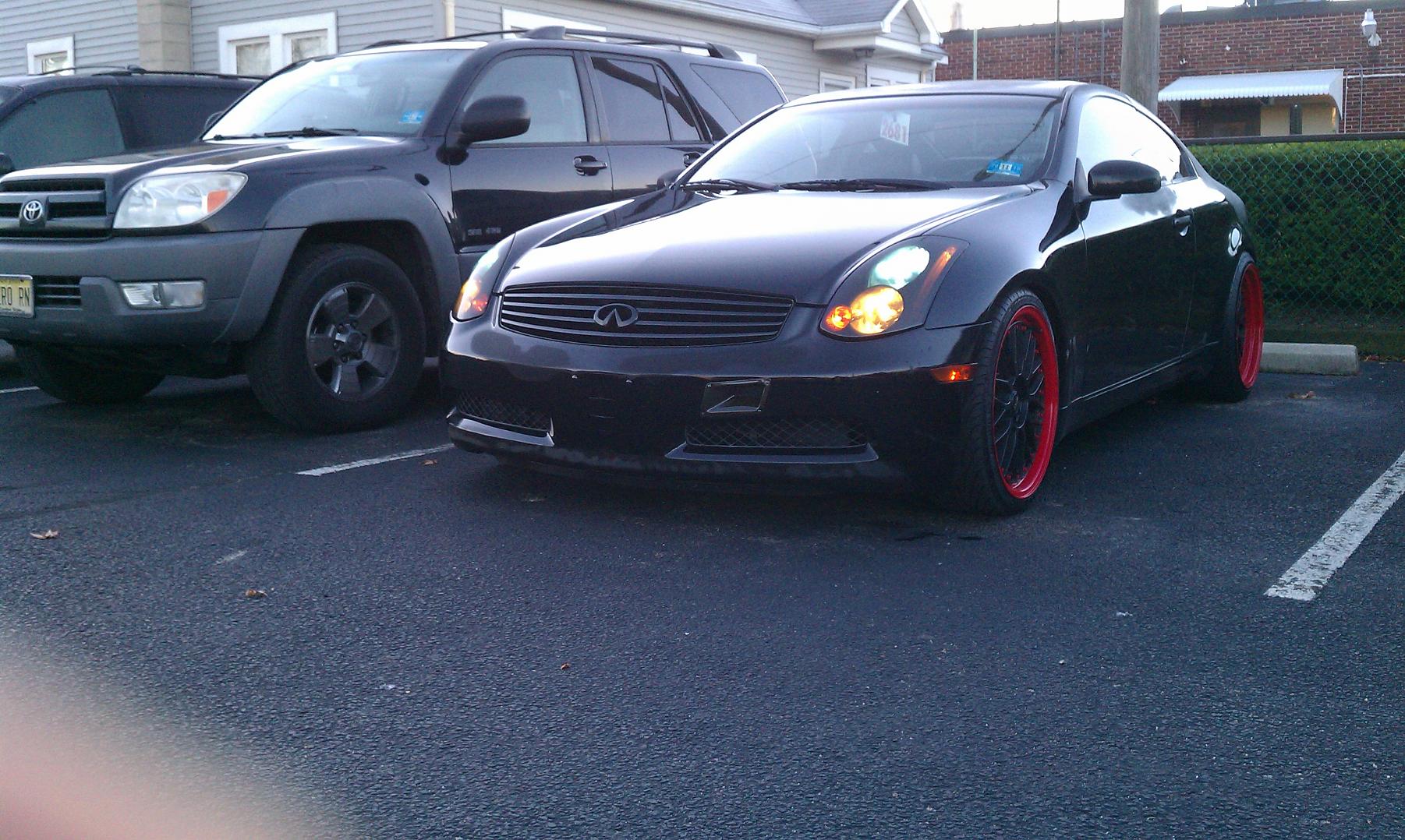

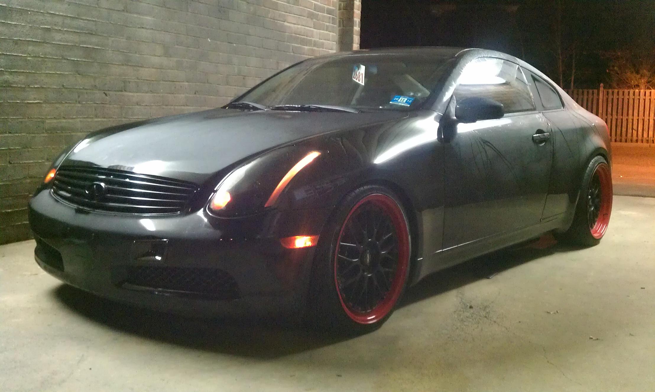

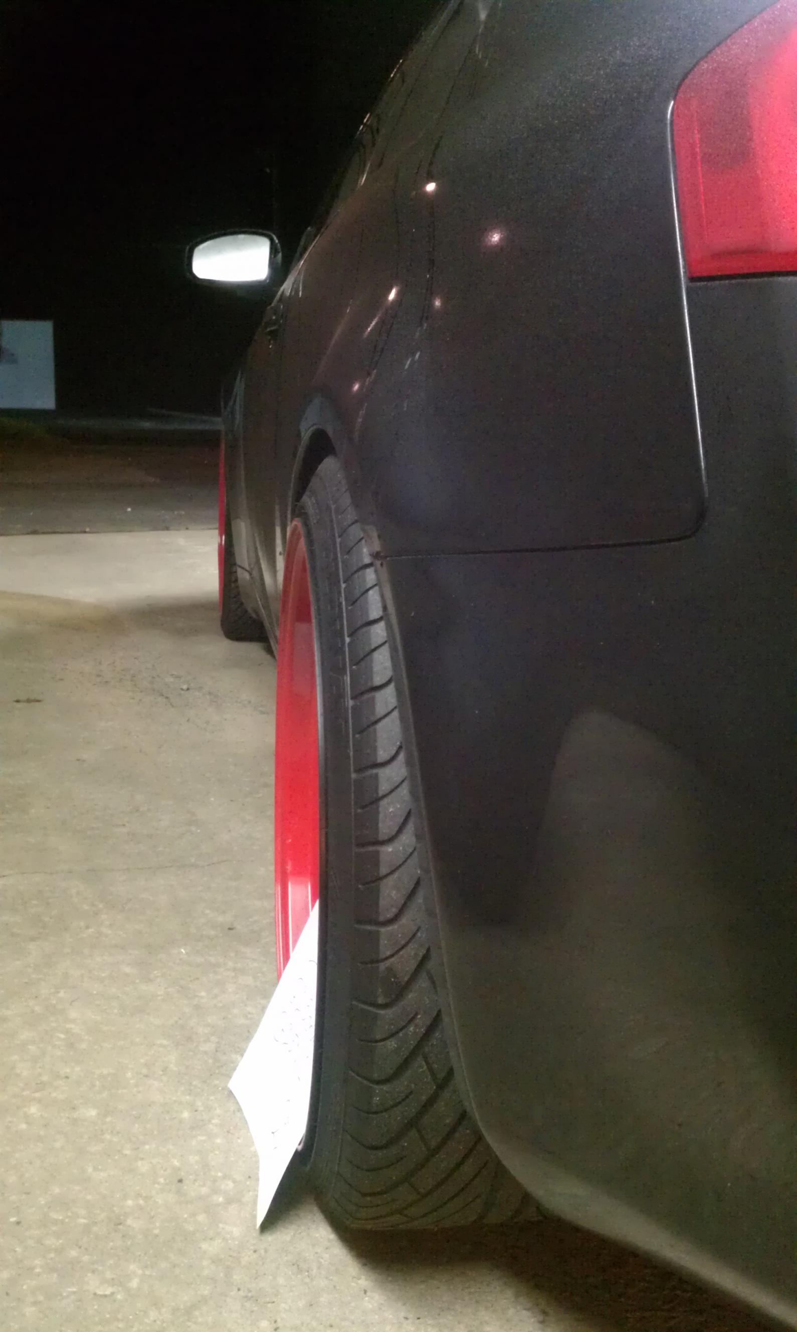

oh,,,,here is some of the most current height and stance i got...hope this helps more...
That's really weird that the offset spot was blank.
I'm going to guess since the front is the +20 that the rear is the +25. If you can test fit them on your car I can tell you for sure. But my money is on +25
Originally Posted by leoverte
well i guess with my suspension im barely lowered...buuuut idk what might be differ between my car and others, but man i barely fit a finger between the tire and fender, in the front or rear for that matter...maybe being that i pretty much cut almost the entire rear spring mount off........anyhow i stretched since the rear tire and rim stick out a decent amount in my opinion honestly...even in my driveway right in front of my garage i have a small incline and whn i park there my rear tire goes into the fender......im not mad aggressive in the rear, but im def out....but again..this was my first attempt at bein aggresive, so i thought single digit offsets would be good with my spring setup, tire sizes, fenders rolled, etc. soooo....
if i run this rim up front def the same size tire,,okok im good with that as for the spacer 10 mm....dammm was trying to stay away from spacers...was hoping to be able to get away with a 3 or 5mm....
regarding camber in the front i just checked and from my alignment in oct, im -1.9 in the front and -1.5 in the rear...does that help boss?!?!? seriously thanks for the info man....cuz i kinda want to go for a big change, but before i drop money want to know my limits,,,,thanks again man,,,
try and break up paragraphs for me, it's difficult to do numbers when they're squished together haha.
The offsets are good and the reason it is poking out so much is definitely the lack of camber (from the small drop)
Nothing wrong with running a 10-20mm spacer it's the big 40mm spacers that you want to stay away from.
This is 19x10 +6 with a 245/35 with a similar drop to yours.
The reason the car is tucking the rear is because the springs are pretty soft. Switching to adjustable coilovers will give you a little more control over this (not to mention height adjustability)
Hopefully that covers your questions?
