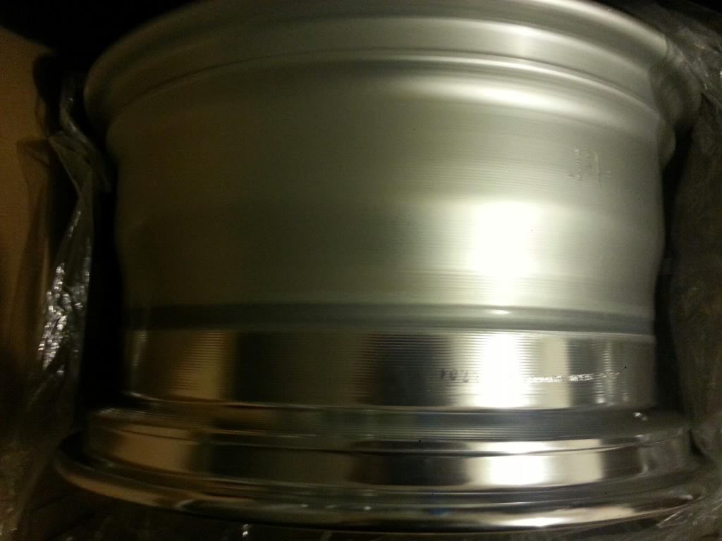

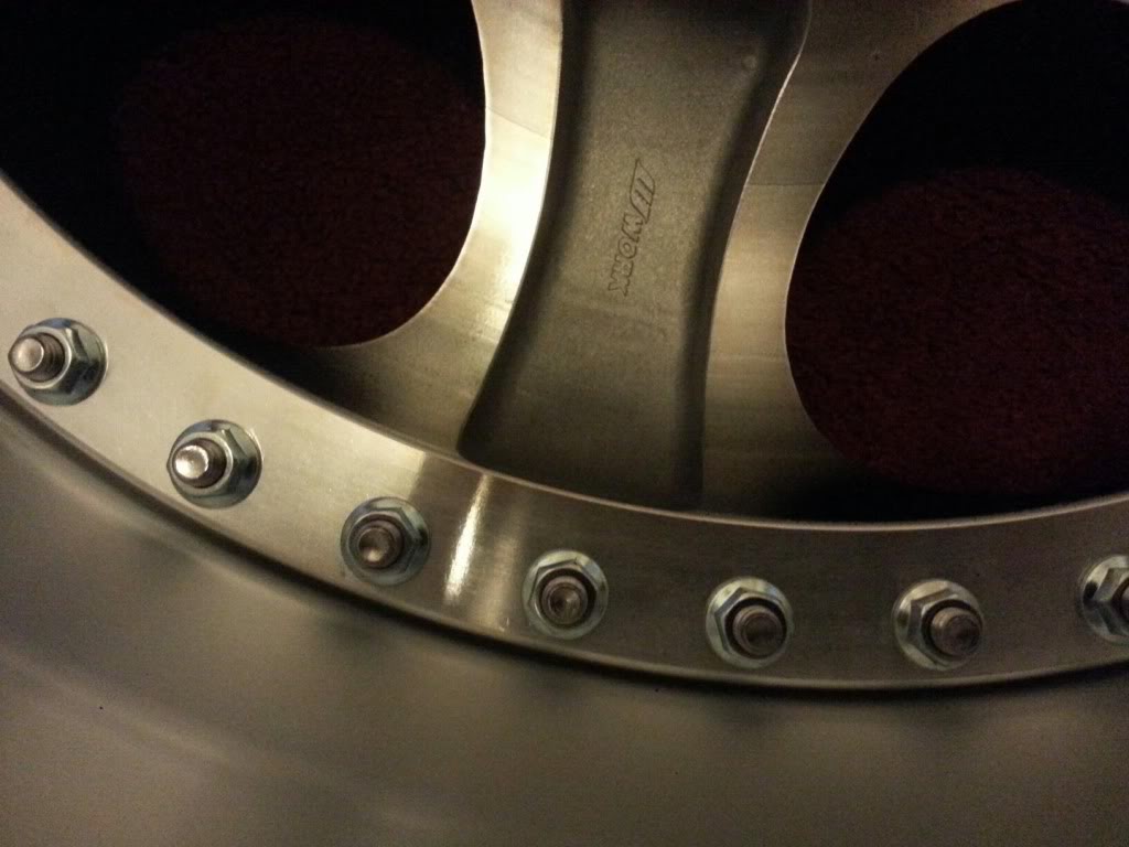

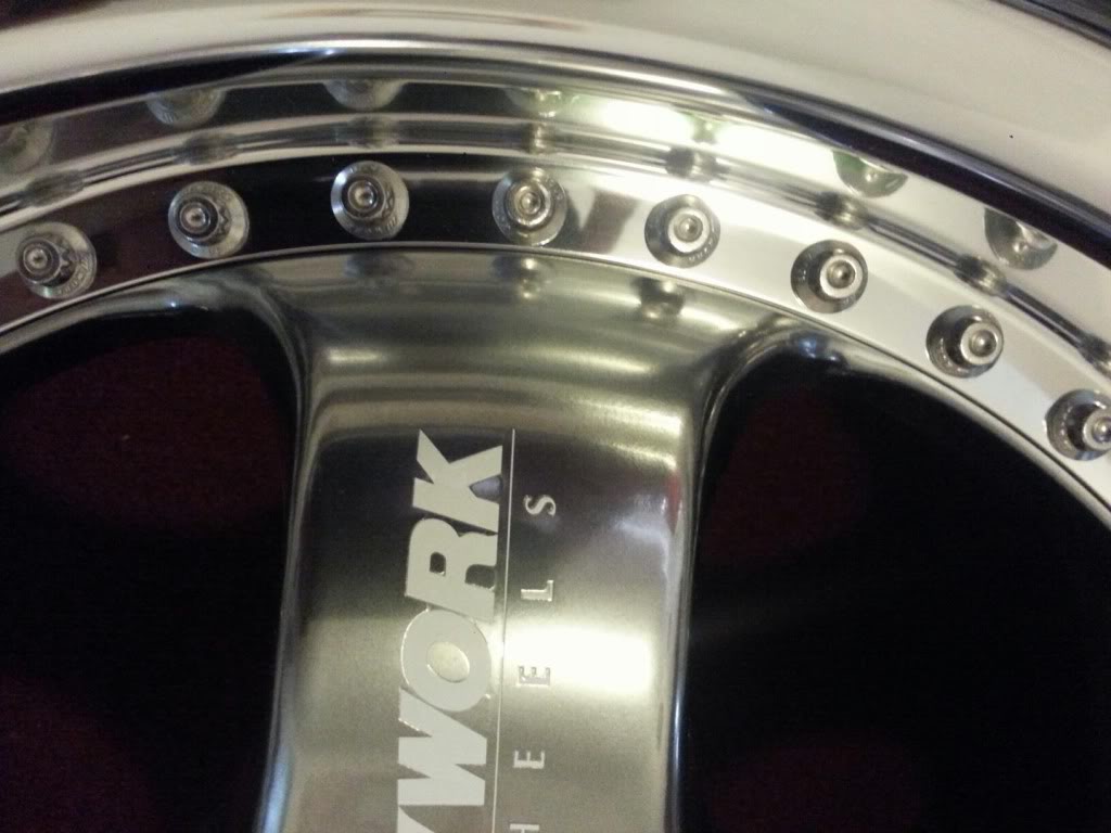

Wow thanks guys. I'm asking this guy to see if there's a weld/silicone or not.

They look beautiful. No way to tell unless you take a razor and scrap up some silicon.
