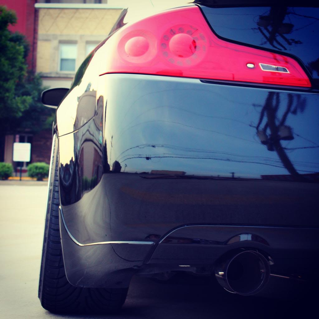

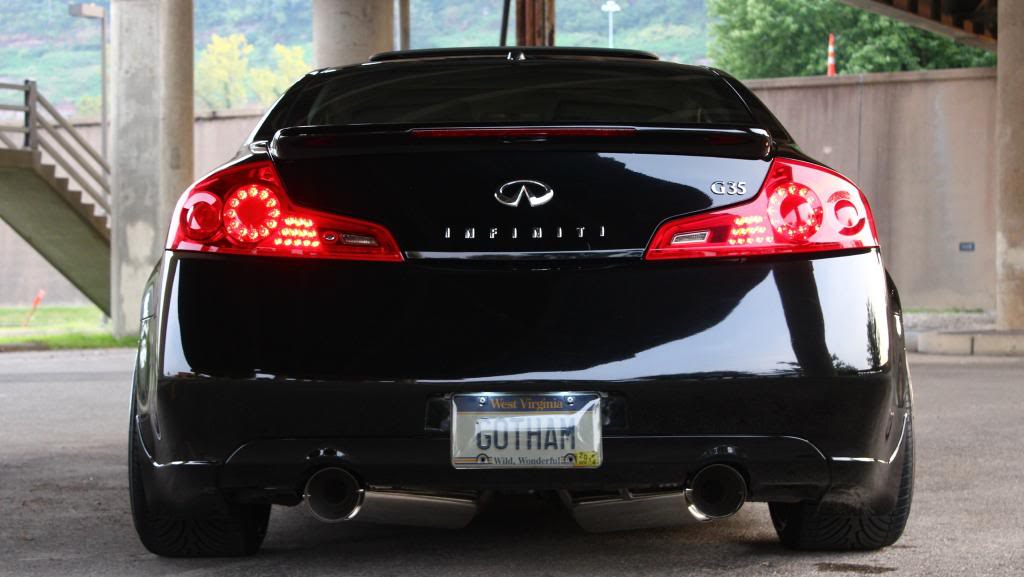

I have another question/request concerning my setup. I took my car in for an alignment yesterday, had my guy put my stance rear camber arms on, and I told him not to adjust it that much, just basically leave it close to where it was from factory after I dropped my coils so I could maintain a decent amount of camber for my setup to eventually run my spacers. Of course, I go pickup the car and he stuck the rear back to oem spec. both sides are less than -1 degree. I called and got setup for another appointment for Monday, and im just going to tell him what to set my rear camber to, so im looking for input on degree numbers. My front is around -2.5, so im shooting for somewhere around -3 to -3.5 degree in the rear. Mainly im looking for pictures or input on how -3.5 degrees will look on the rear.
Heres a pic of what my camber was naturally set at when I took it in to have all this done, so id like to get back to close to this camber, but the guy didn't note the specs before he installed the new camber arms so im shooting in the dark. Can someone that has more experience than me guestimate what camber I WAS at, because id like to get back close to this.

Heres another picture for reference.

Originally Posted by GothamG
20x9 225/35 +15
20x10.5 275/30 (will be 255/35 when spacer goes on) +15
15mm spacers to put me at +0 all around.
Basically im just trying to get back to the camber I am at in those pictures ^, I just don't know what numbers those were
Looks to be around -3.

Thanks Toretto, thats what I was guessing. Ill just tell my alignment guy to make the rear somewhere around -3 to -3.5 & hopefully itll work out.
