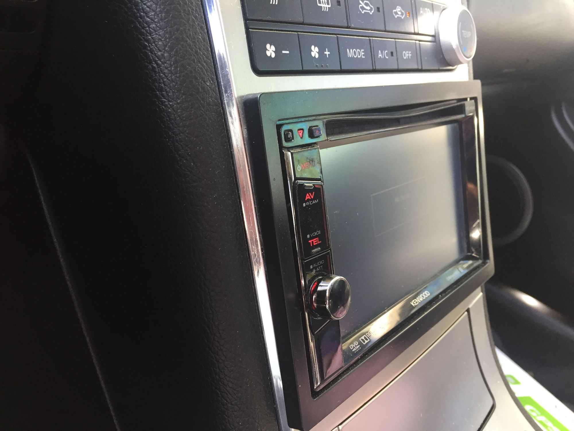

There is plenty of space behind the head unit. U could probably push it all the way until it falls in if u really wanted to. Here is mine mounted on top of the JDM trim. I did have to drill new holes into the mounting bracket to keep the angle of the screen to sit flush with the trim ring. I think it looks good.

Nice looking install. Thank you so much for the helpful info and pic. Looks like the new Kenwood DDX 6904s unit will fit w/suggested mods. It has quite a few advantages over the stock unit. I like the idea of a backup camera.

Thanks. I actually uploaded 4 pics....not sure why the rest arent showing up.
