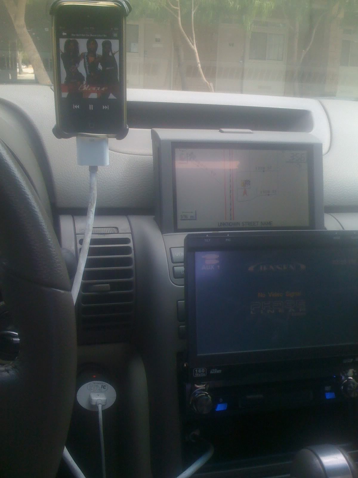

Has anyone successfully converted the JDM kit to use a single din unit? I want the form/function of the JDM kit bc I want to keep my factory nav... but I would love to use the
JDM kit, install a single din unti, and add a small pocket...
Thoughts????
Thoughts????
Yes, it's been done. There's a couple differnt ones in my gallery from the fery first post.
Old Aug 25, 2011 | 09:33 AM
  #566
BullDawg36's Avatar
Posts: 8
From: San Antonio, TX
What part was used to do so???

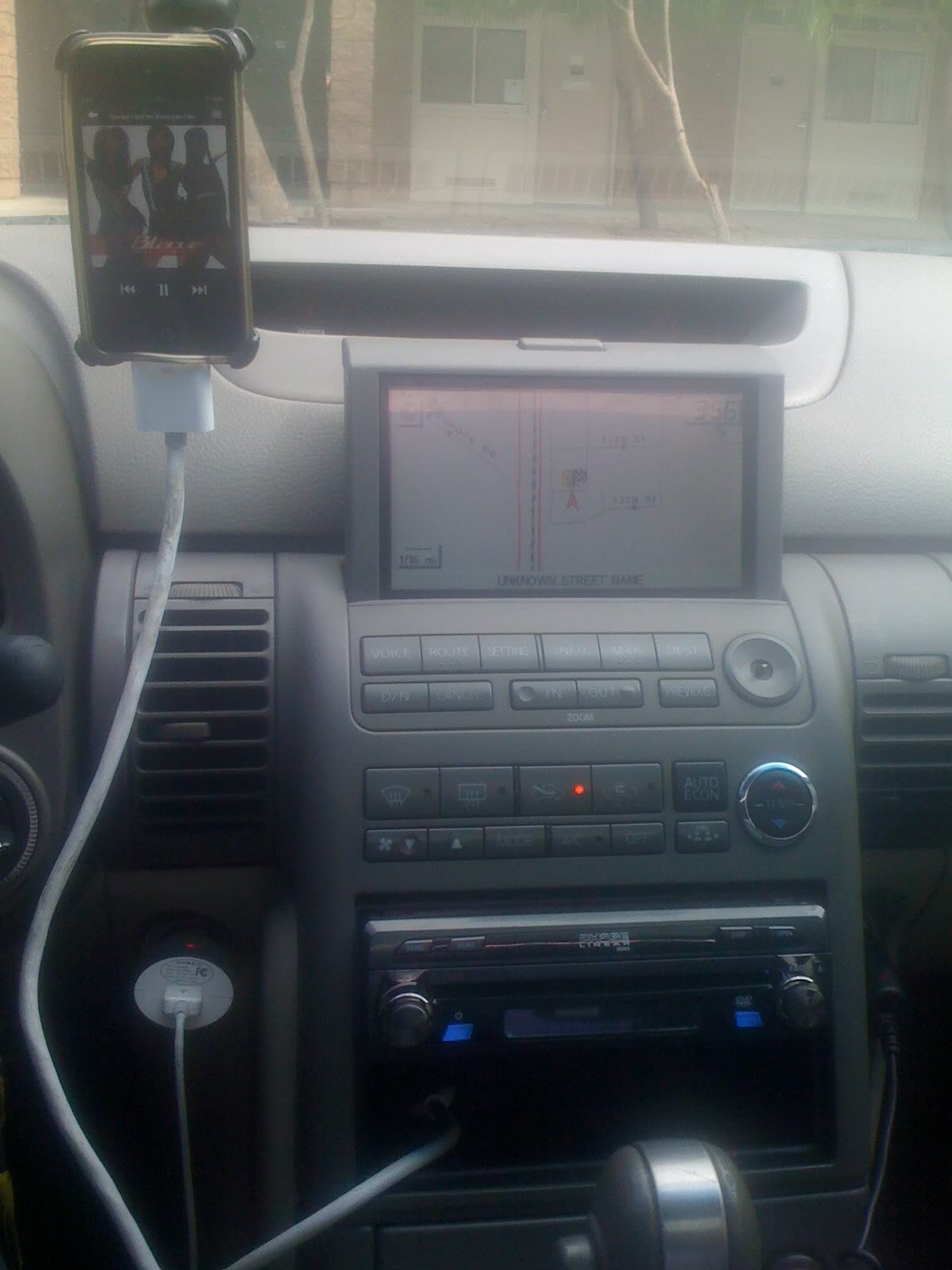

Thoughts????
Heres mine, It is do-able and it works quite well. there wont be a gap above your HU when you do your install. My head unit came with a special trim piece i that i lost. Mine needs the extra clearance for when the screen is coming out.
