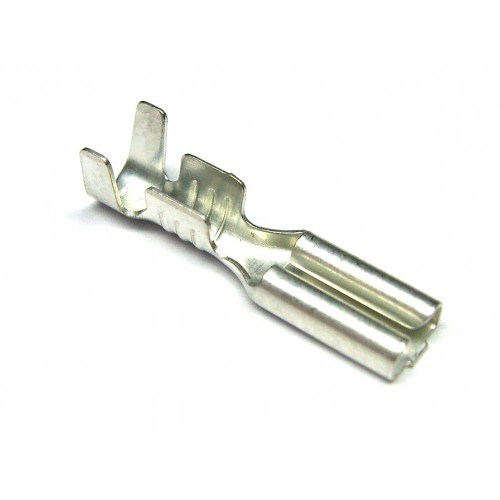

Failure of the solder... There's harnesses that disconnect, you're not actually de-soldering and re-soldering every time. My radio's been in and out more than just about anybody ever would, since I take it out for how-to's and such fairly regularly.
I guarantee if you take two identical wires, one of them smashed and pinched against the metal edge of a crimp and the other soldered by anyone with any practice and start shaking or pulling at them, that crimped wire is going to fail first. Put some heatshrink tubing over that soldered connection and you've got something that's about as good as a single wire.
Pop quiz. How well connected are these wires?
What about these?
This is how you should do your wiring, unless there is a reason why you can't get a soldering pen to the wires you're working on.
Even if you're using quick disconnects for removal, I recommend getting ones like these, so you can check the connection and heatshrink them yourself... I never trust those plastic collars that hide the connection, break when you crimp through them, or are prone to slide off.
