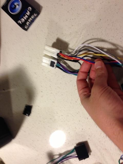

Originally Posted by malcocw
Does that mean I will need to splice on the "car" side of the Roem? And leave the blue wire open on the HU side?
Yeah, blue wire on the HU side doesn't give enough power to run the antenna, so it isn't used for anything.

ie splice these and leave blue connected to nothing.
http://i1037.photobucket.com/albums/...ctar86/65.jpeg
and leave this side like this?
http://i1037.photobucket.com/albums/...actar86/78.jpg
Yes, and you may need to splice the white/blue into the red and blue as well, depending on if the subwoofer "ON" cause a +12v on the white/blue wire or not.

Ok turned on sub and hooked up the way you said still get alternating 0 and .03 on blue/white. So you think splice red and blue/white on the "car" side?

Also just to clarify. I splice them all together into a 3 sided splice to 3 sided splice correct. Ie red, blue and blue/white from Roem all connect to red, blue and blue/white on harmes to car?

Blue and blue/whites on the radio side of the ROEM remain disconnected. The two reds, blue and blue/white on the vehicle side of the ROEM connect together.

Wrathernaut, thank you so much for the help!! It finally works, couldn't have done it without your help!!!
