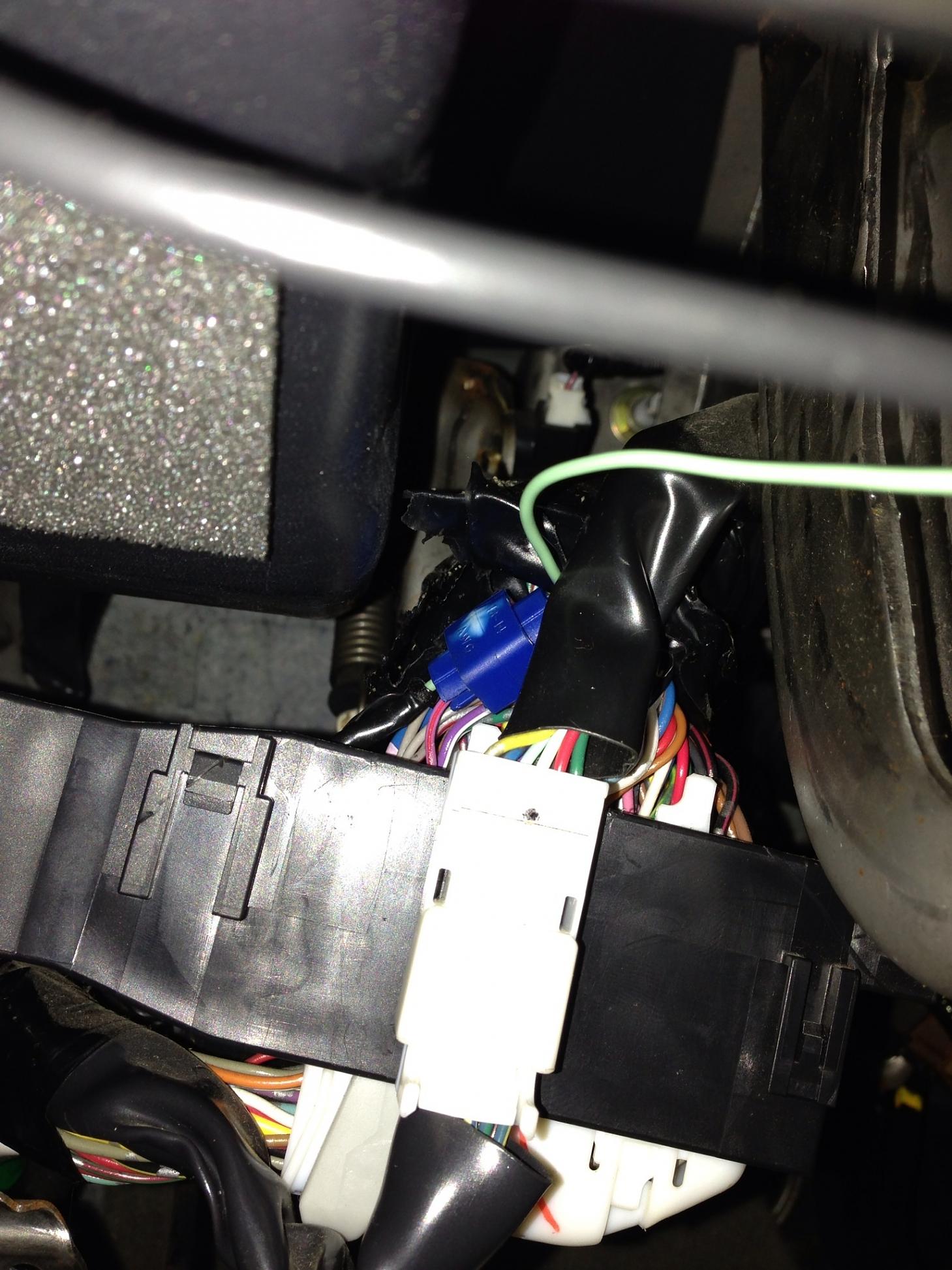

Double din shopping & Double din shop #1 HIT on google is this post by Wrathernaut
I just google searched ddin shopping and it brought me here lol, but here is a requested photos of the parking brake wire being spliced in to 5AT '06. Not an easy one to reach. ASWC WIRING to come.
