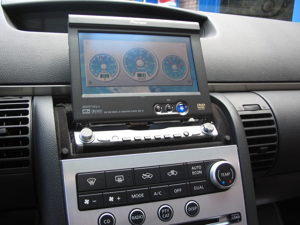

Here's the type of thing done in an first gen (installed in a different location, obviously) I'm talking about with being able to put an aftermarket radio in the 07+ sedans:

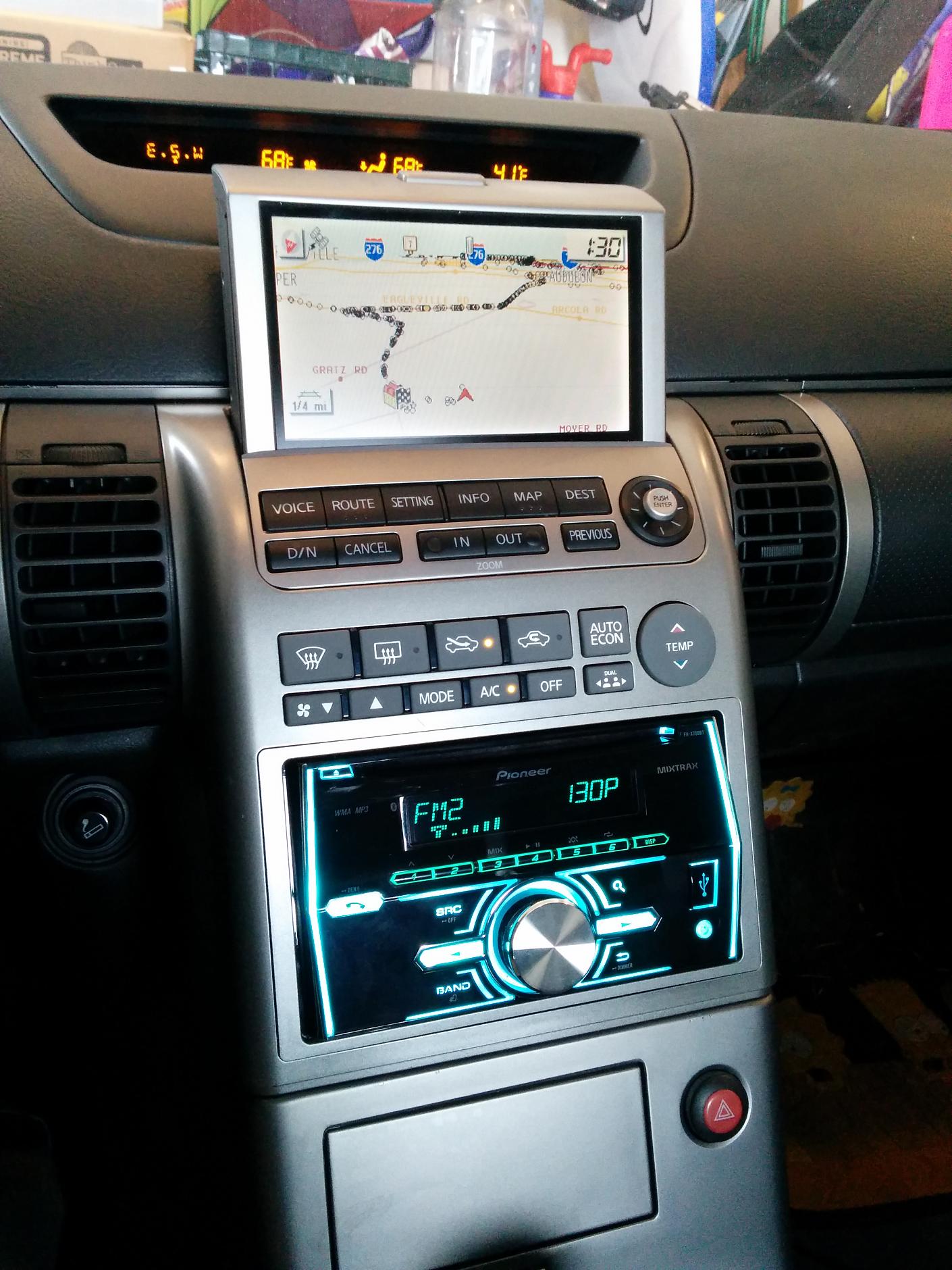

Posts: 8
Hey, thanks for the awesome thread guys! I recently had the climate controls go out on my 2003 G35 Coupe 6MT, and my FM tuner had already not been working for several years. After seeing that this was a common problem and all the resources, I took a shot a fixing it. I ended up getting the Pioneer FH-X700BT head unit, the Metra board, the Scosche CNN03 harness, and the Axxess ASWC-1 unit. I have the nav system, so I followed the instructions in the G35 Metra 2 video on youtube (that I believe you linked above) for modifying the nav controls, the metra unit, and the OEM metal bracket to get it all to fit together.
Anyway, it all worked out, including keeping the nav system functional. Thanks for the extensive resources here, it certainly helped me get through the process.

I took a whole bunch of pics as I was doing it (so I could remember how things were before I messed them up), so if anyone needs a pic of some aspect of the process, just ask. Attached (assuming I did it right) is a pic of the final result, with the new head unit and the nav system popped up (it opens and closes properly through the metra) and operational.
Attached Thumbnails Wrathernaut's Double-Din Installation FAQ, Shopping and Resource List-img_20140127_133030.jpg

Looks great and I remember seeing that din at best buy. Not my cup of tea but it's super practical. Did you complete any of the requests on the threads front page?

I was just looking for something with lots of good reviews and thus likely to have solid bluetooth support, as that seems to be an area where people tend to have some problems. Once I toned down the gaudy colors to the minimum, it looks nice enough.
Good call on the requests on the front page, I had overlooked that link. Looks like there's a request for pics of the metra / nav modification process. I'll look at the pics I took, I hope a couple of them would be helpful.
