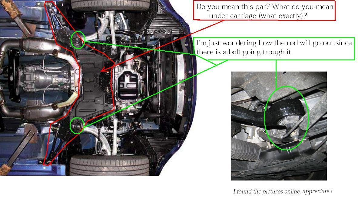

I have same problem (05 G35 Coupe) please anyone. I want to know how you replaced the compression rod. I will be changing them soon.
Do I need to remove the cross arm underneath the compression rod (where the rod is mounted), how do I take it out.
Pictures will be very helpful.

Originally Posted by Shawn87
Just the under carriage.
What do you mean under carriage (what exactly)?
I’m just wondering how the rod will go out since there is a bolt going through it.
appreciate
appreciate
yep remove the red part its like 8 bolts. then you have to take the bolt for the compression rod. its usually fused in there. We had to torch it to heat the sleeve up to pull it out. What a bitch of a job.... the old boot caught fire... car started smoking lol
Put alot of anti seize on it when you put the bolt back in.
Thanks, that really clarify everything.
