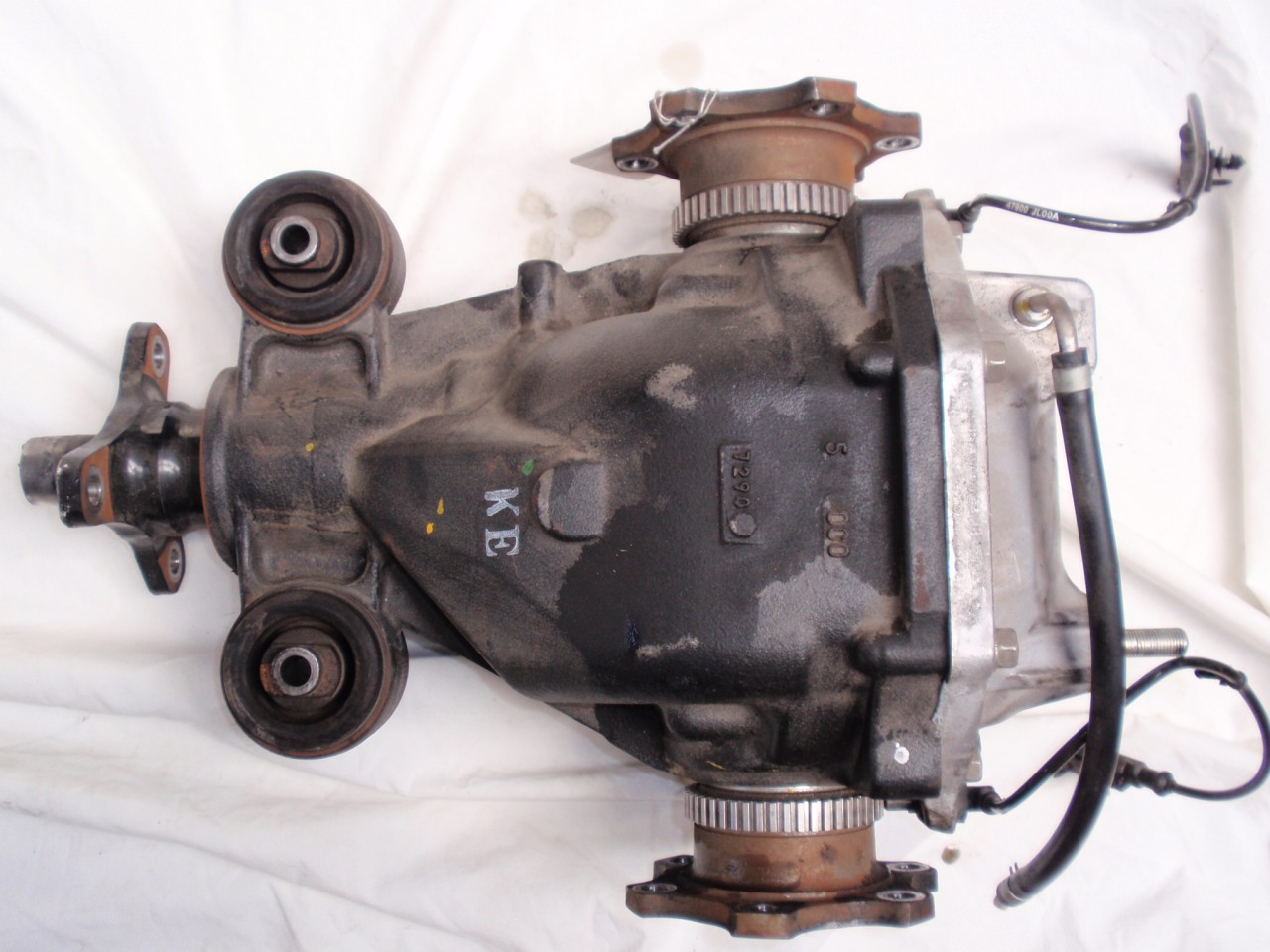

Ok, lately I've been searching for a 3.7 FD pumpkin w/vlsd and found this one. Can anyone confirm that everything in the pictures is all I need for the swap into my 5AT 07 coupe, aside from the drive shaft and flange modification? It's off of an 09 G37 auto coupe w/12k miles.
This is what the description says:
This is used complete rear differential unit. Everything on the picture is included. See picture to judge condition.
Contact for more pictures. Or with any other questions.
Donor vehicle:
Make: INFINITI
Model: G37 coupe
Year: 2009
Milage: 12000
Transmission: Automatic
Sorry if the pictures are too big, I'm on my iphone can't resize them . Thanks for any help.

looks legit to me

^^It will fit and everything is there. I got mine off a G37 sedan 6MT, no modification was required. My first one was off an auto and looked like the one you posted.

Yeah i tried looking for a 6MT pumpkin but couldnt find one . One last thing, it says it has "LSD", im assuming its the VLSD, right? Thanks a lot guys.
Old Sep 30, 2010 | 10:12 PM
  #180
herrschaft's Avatar
iTrader: (18)
Joined: Jul 2009
Posts: 7,739
Likes: 771
From: Coast
^Not sure. But according to the link below, that diff is a 3.3:
http://infinitihelp.com/models/2009/...ifications.htm
And the pinion shaft on the one pictured is different then the one I had.
