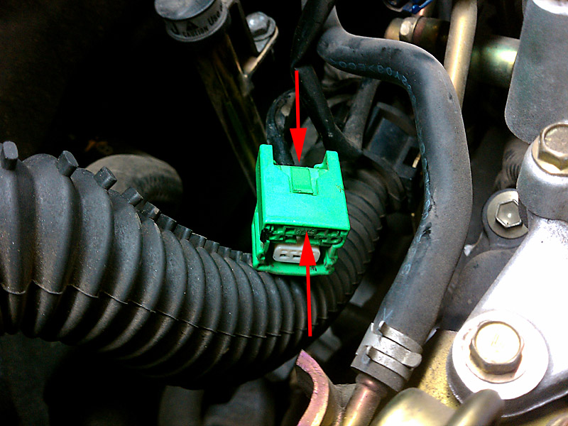

Should the connector separate easily for the passenger side? I'm having difficulty separated the sensor from the clip. Please Help!

yes, mine was a pain in the azz as well. Just keep pulling on it carefully. It will give.
Good luck

Thanks...Trickstyle gave a great explanation and visual..
i got this pic Evan78, but i took a pliers and squeezed the clip inward(the arrows on the picture) then the sensor came out with ease. DO NOT pull on the wires, my buddy did his 350z at the same time and he pulled a wire out of the harness :/ we soldered it back it but it took a while.
