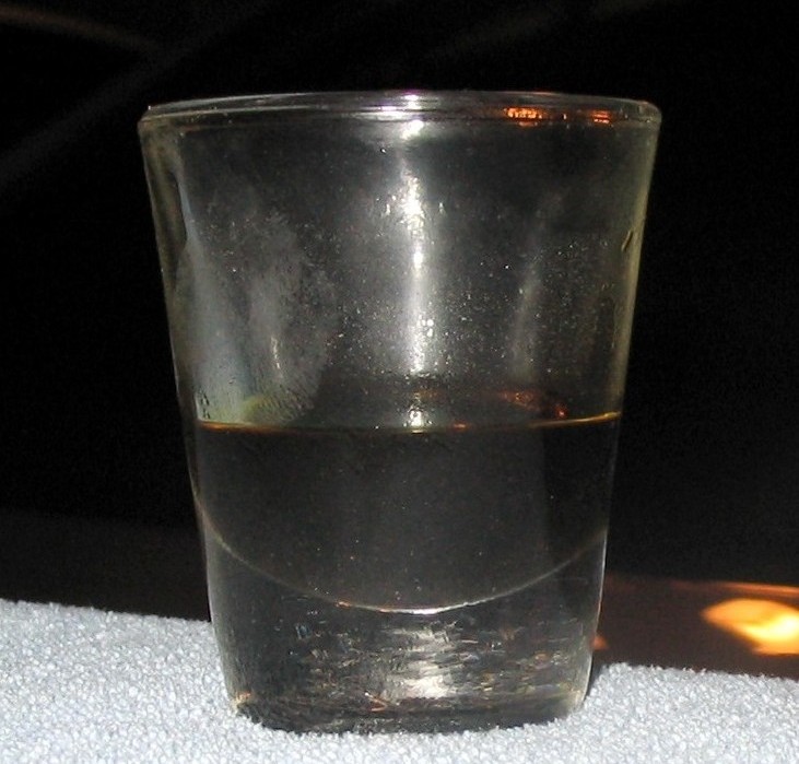

Here's what my catch can "caught" after 780 highway miles. The container is a standard shot glass. The dipstick level appears the same... maybe my engine is an oil generator.
Mobile 1 5W-30 - 03 doggie door A/T Sedan with 28,768 miles
DaveO

Thats not really to bad IMHO DaveO.... If you think about the motor loosing 3 times that much in ~3000K miles, or even 5 times that much, it's doubtful you'ld ever even notice it on a dipstick.
It would be interesting to do a leakdown test on those motors that were producing more and less oil. My GUESS would be those with the best sealing rings would push more oil out, but on something like the VQ, it's doubful that a good running motor would show much of a change even between say 3% and 6% ring seepage...
Do you have anything you can bump your timing up with, or modify the map at all?
I wouldn't consider this an abnormal amount of oil (I just don't want to burn it). I've never used a noticable amount of oil between oil changes.
My cars initial timing was bumped over three years ago as were the A/F and Timing maps.
DaveO
