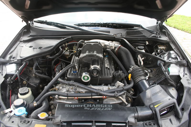

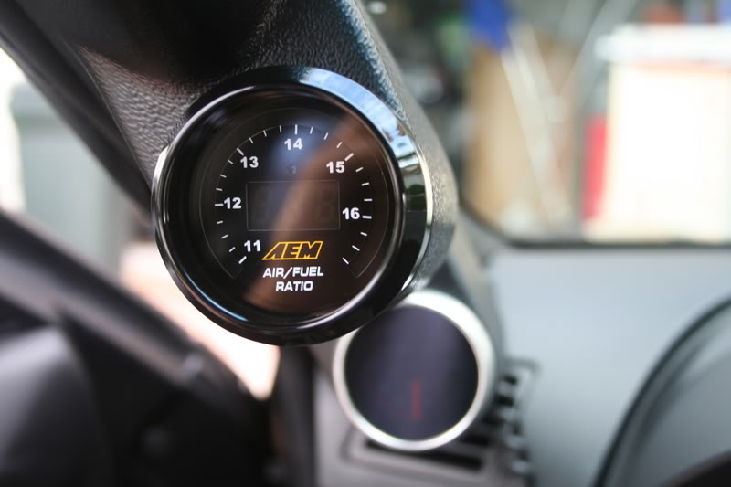

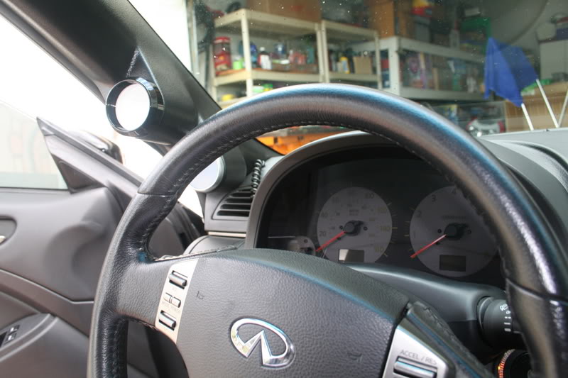

I got my gauges installed last week and so far their great! I was suprised with the look and quality of it. This is the autometer 2 gauge pod (searched for pics on here but never found them..... so here they are!) Some people may think they look ricey... but hey I like em. You dont really notice them from the outside during the day... but you can see them at night. The autometer really matches the stock gauges.
I get 8lbs of boost at WOT with a/f at around 11-12. When just cruising around my a/f goes from 14.5 to 15.
Looking to change to an HKS true dual exhaust.... I love the look but I need to hear it in person first. Enough with the talk and on to the pictures!
New gauges!
Aem Wideband A/F gauges and Autometer boost gauge

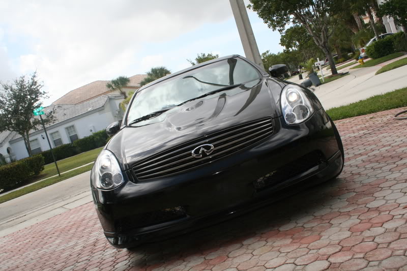

Front Shot. Im gonna modify my bumper soon to get more airflow into the intercooler.

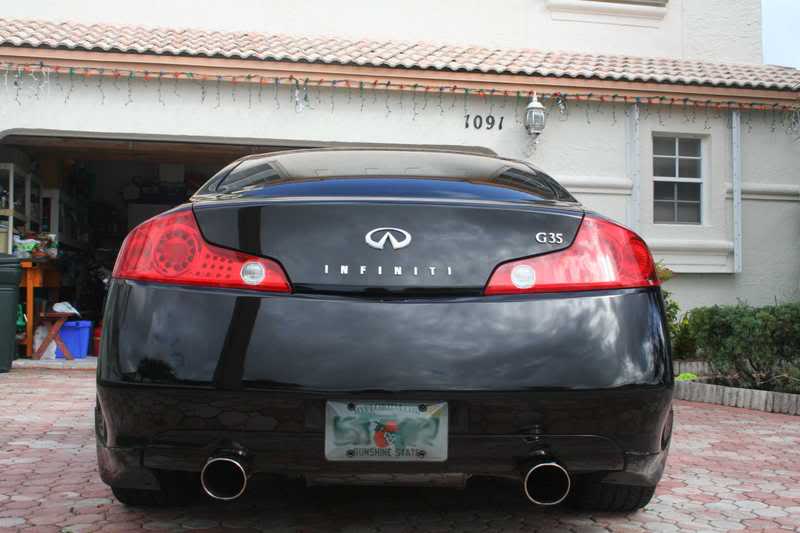

Butt Shot for Fun
Updated Engine bay shot

MsA -
First off it looks great. Congrats!!
Just an FYI, you are not going to get more air the intercooler, you are going to get more air to the heat exchanger. The intercooler is under the blower.
What year is your car? If you have an 03-04 or an AT (any year) you should only have 7psi on your stage 3. Stage 3 runs lean as-is and if you are getting 8psi you are going to have some serious problems.

Hmm..... Ill check tomorrow if it really is 8lbs of boost. What is a safe range for my a/f right now. For a little i thought I was running rich
I thought I read people are only having problems with running lean when they changed cats or exhaust components.

Safe is ~11.2-11.8 at WOT.
The stage 3 runs safe but is maxing the fuel pump and injector. There have been some blown engines with the stage 3. I would consider upgrading your pump now. If you are going to stick with the stage 3, go with a walbro 190 and if you may go to stage 4 go with a 255.
As for the boost, that is the first time I have ever seen a stage 3 run that high.
