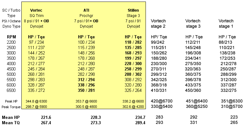

nice to see someone other than me supply some data for a change congrats
so a stage 3 stillen is slightly better with mean power than a "stage 1" vortech
The stock vortech kit with the stock 3.33 pulley is basically considered "stage 1"
If you'd like to upgrade the injectors and the 3.12 pulley - that's a "stage 2".
If you'd like to then upgrade to a return fuel system and the 2.87 pulley - that's a "stage 3"
that is a pretty weak vortech and pretty strong stillen you're comparing. The vortech has lots of room to grow and the stillen doesn't
I'm not disagreeing with the data and believe it to be 100% correct, it's basically exactly the same data I've stated except you never did give me your 338whp stillen graph otherwise i would have factored that car as well into my % comparison and I couldn't find a vortech that dynoed lower than 350whp. The only stage 3 stillen dyno I could find off hand was a 323whp. I wanted more graphs, but I could drop a pin it was so quiet in here with anyone else who had any dyno charts
who actually drives with a 344whp vortech these days? Back 2 years ago maybe, but that's like a bone stock vortech setup on a bone stock car. Yes it is comparable in the fact that some people just might run that setup, but the vortech has an additional 140+whp available to give you with a full exhaust and pulley change. I've never seen a stillen hit even 380whp.
I was reading about one vender who has tried to get more than 360whp on the stillen with headers, test pipes, exhaust etc with a stage 4 and they kept running into a wall trying to do it. No matter what they did, it didn't seem to ever go any higher and sometimes even lost power with some of the changes they did. Actually Stillen themselves were trying to get a lot of power out of their kit with other mods and ended up blowing up someone's engine with the stage 4. It was on my350z.com. I don't remember which vender or who's cars it was in either case, but it's a fairly recent thread in the last 6 months
These days people don't often use the stock 3.33 vortech pulley since the 3.12 has proven to be so reliable and give an increase in power/tq across the board
Just saying I rarely see a vortech car below 360whp these days
BTW, if you have a 344whp vortech and a 338whp stillen - guess which one of those cars is actually harder on the engine? It's the stillen because daily driving you're forcing more air into the car even at low rpms. The vortech doesn't get much psi in daily driving rpms. It's not until you floor it.
People say torque breaks parts, well the stillen is making full torque at low rpms. The engine speed isn't very high, but the tq pressure is decently up there. Most people that have blown up engines with vortechs have done so because it wasn't tuned right and/or they were trying to make a lot more power with other mods and they skimped on something

they're different, but why not compare a stage 1 stillen to a stage 1 vortech? or are we afraid to?

Well its better to compare BOOST PSI to be around the same instead of Stages. And Clearly Vortech had the advataged on PSI.

what if I don't think that's a fair comparison? the lowest stillen vs the lowest vortech isn't fair? we're comparing kits and what they put out in the real world, not psi battles
shouldn't we be laying out the low, medium, and high of the stillen and vortech kits together. If the data is all layed out, we can see where everything stands.
You and I already agree that for $5000 the stillen will give you more mean hp than a vortech kit and if that's the buying criteria that's the best option.
But why don't we gather up data for all stillens and vortechs? I'll be happy to convert the vortech graphs I've found into 500 rpm increments and do it your way. Either method of averaging graphs with black/white or your way with sampling points on the graphs is pretty much going to reach the same conclusion so let's just do it your way

I took the liberty to add to your chart with some other vortech setups
you seem to want to measure 8 psi, which is an odd thing in itself cause if you open up the exhaust, the boost psi drops, and you therefore have to upgrade the pulley to fill the engine with more air to return back up to 8 psi. It's completely possible that a 400whp vortech is running at 7-9psi depending on what breathing mods it has
the 450whp vortech actually was done on a dynodynamics load based dyno which usually read about 11-13% lower than what a dynojet reads...
if someone with a stage 1,2, and 4 stillen would please post their dyno, we can add that one in as well - and also lets try to get a 370-380whp vortech dyno
I see you're using the Sport Z magazine supercharger article from 2 years ago for your data. Do you consider that to be current data by today's standards? The vortech in that article was detonating from who knows what reason - is that really an accurate comparison? If a modern day vortech, ATI, and stillen car showed up for a dyno shootout, you really think the results would be close to what they were back then when the kits were brand new and had bugs etc? The ATI was notorious for not having a timing solution and detonating and the vortech's base map was so great and had a few changes made to the kit itself later on. I think the Stillen kit was the same back then as it was now - they got it right from the start I do believe, but these days things are different. You're still not factoring in that those are three different cars. You could have 3 stock cars on the same dyno on the same day and they'd all put out different numbers...
Does this graph look like a valid graph?
http://www.sportzmagazine.com/images...tech_Chart.gif
I suppose it's better than some of the graphs Sport Z magazine posted in their turbo shootout
anyway, here's the chart layout
Attached Thumbnails Thinking of going Stillen S/C-stillen_vortech.gif
