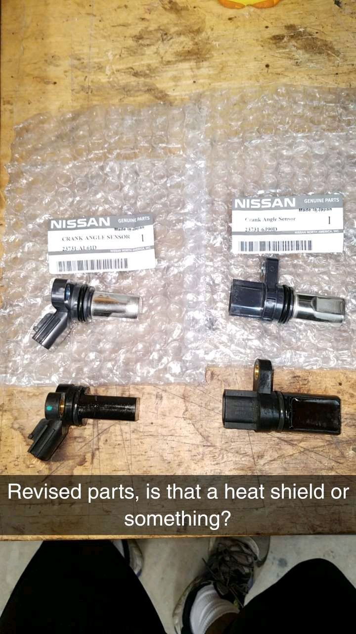

Had a code P0340, ordered new revised parts from Nissan. Only got intake, will probably get the exhaust ones anyway as preventative.
As you can see, they've got some kind of metal io them now.
Unfortunately, my starter also decided to die, so that will be this evening's festivities.
P0335 is the code for the crank position sensor, P0340 is the code for the bank 1 (left side) camshaft position sensor. They're both straight and don't have metal around the shaft. The crankshaft position sensor is part number 23731-AL60C and I believe goes into the transmission housing.
Also the part number on your bag is slightly different than the correct cam sensor: 23731-6J90B.
The part numbers on the bag are the new revised part numbers for the cam sensors.
In other words: bank 1 (passenger side) 23731-6J90B has been superseded by part number 23731-6J90D
Bank 2 cam sensor is now 23731-AL61D
​​​​​​ They now have metal on them as you can see in my comparison.

Replace your starter with a rock auto $80 replacement. It's made my G sound fast again with it's startup sound... I really like it.
As for revised cam sensors - interesting!

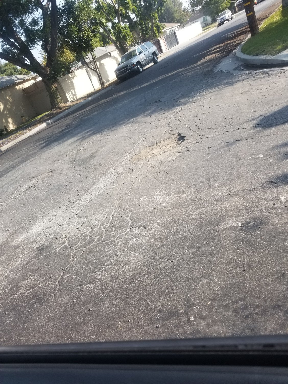

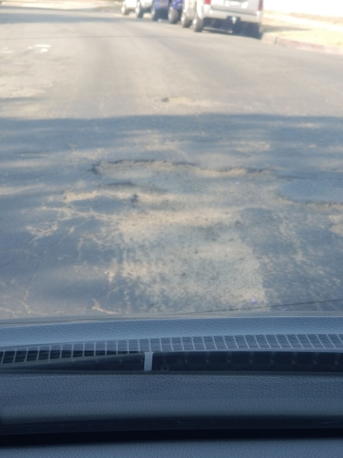

see pot holes everywhere
