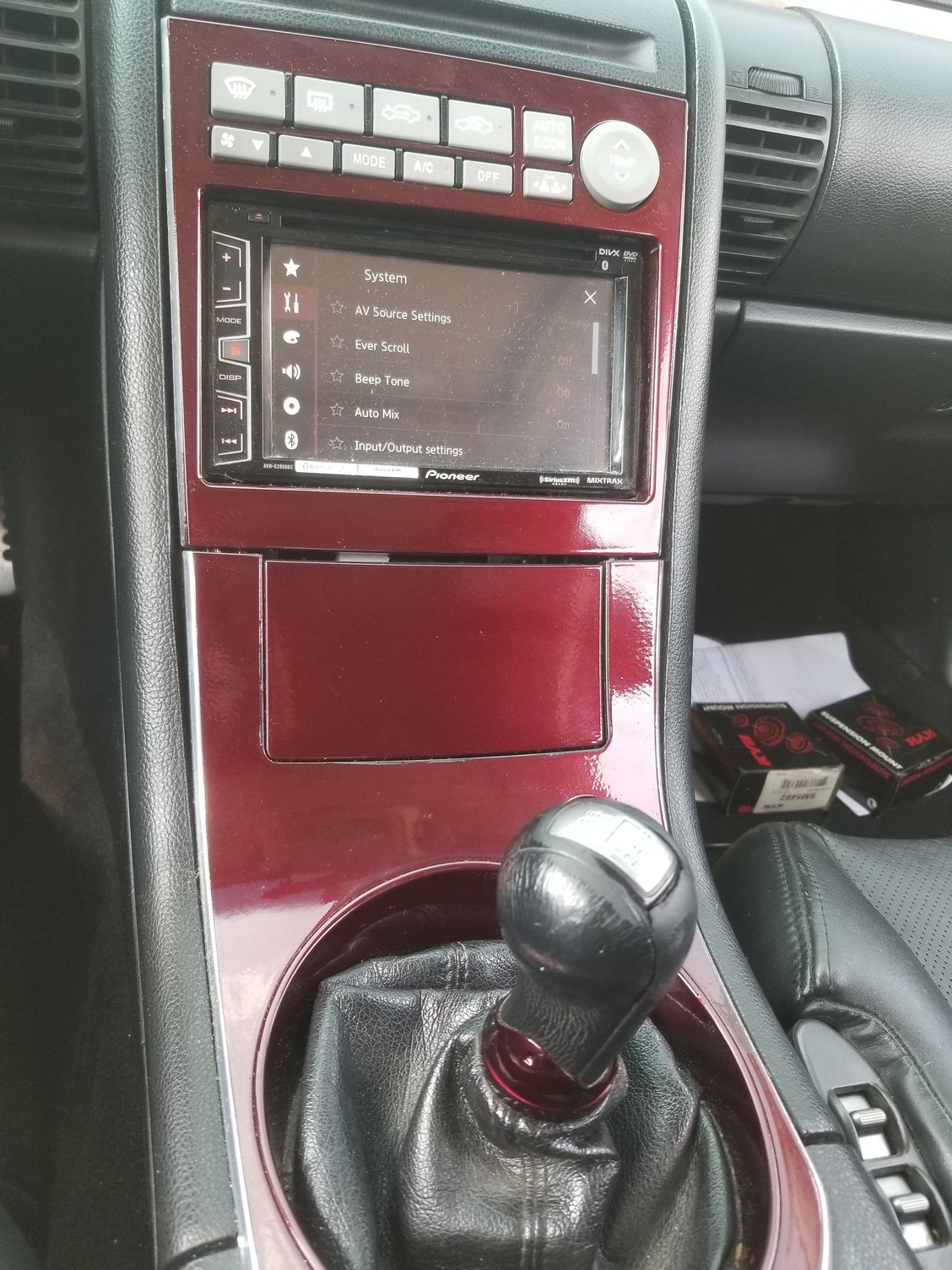

Unique color, really spices up the G! Your console looks easier to wrap since it's more flat and doesn't wrap all the way around like the crappy '03-'04 console, I got a few ugly creases on the sides which would have driven me crazy so I pulled it off and left it stock for now. What's with that orange peel texture on your wrap, is that how it's supposed to look? That would cause me to tear it straight off without a second thought, but that's because it would just remind me how crappy my car's paint is.

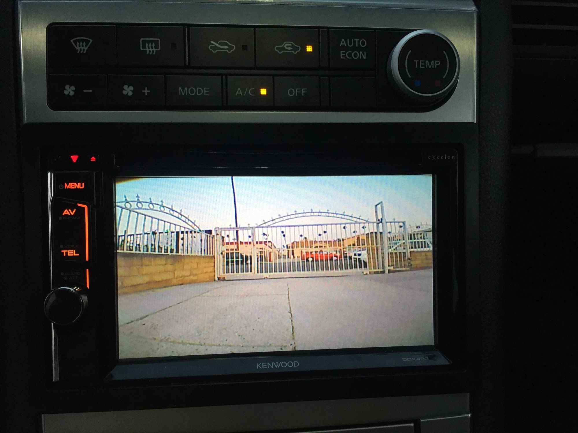

Anyway...finally installed my backup camera today. Pretty damn good for only $23 bucks!

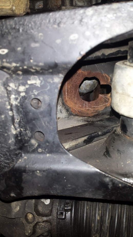

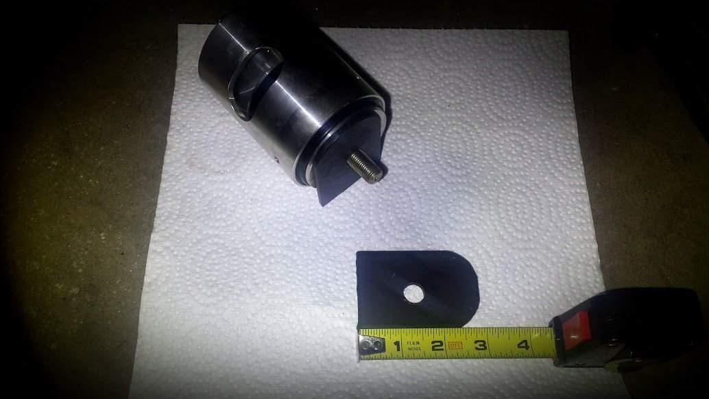

My car hates me, and I've only done good things for it.
2 AM update. Z1 engine mounts bolted to engine and ready to be dropped back into the front X-member, except I found that the driver side engine mount mounting point was also broken right off the front cross member. Oh well, time for more JB weld and 24 hours of waiting.
This side turned out pretty good.
I fabbed these guys up with an angle grinder, sawzall, and drill to fit in that entire slot to take the stress off the JB welded sections.
So I'm almost done, just need to drop the engine back down and do the bottom engine mount nuts, and put the cross brace with the compression rod studs back on. SO CLOSE, NOTHING LEFT TO STOP ME!
I'm tightening up my passenger side compression rod nut, with the torque wrench set 40 ft-lbs under spec and...... SNAP
FML. It looks just like this. https://g35driver.com/forums/g-spot/458809-uh-oh-compression-rod-stud-broke-what-now.html
I hate my life.
Looks like tomorrow night is going to be another fun ordeal of grinding, drilling, tapping, and swearing.... And lots of Loctite Red.
And to think I knew nothing about mechanic work and had no tools when I bought this car.

On that nut I strongly recommend using anti-seize and subtracting -25% to -35% torque, start with a subtracted 35% and see how it "feels" then increase torque to a subtracted 25% and call it good. Check torque again after a week of driving to confirm it's still within spec.
