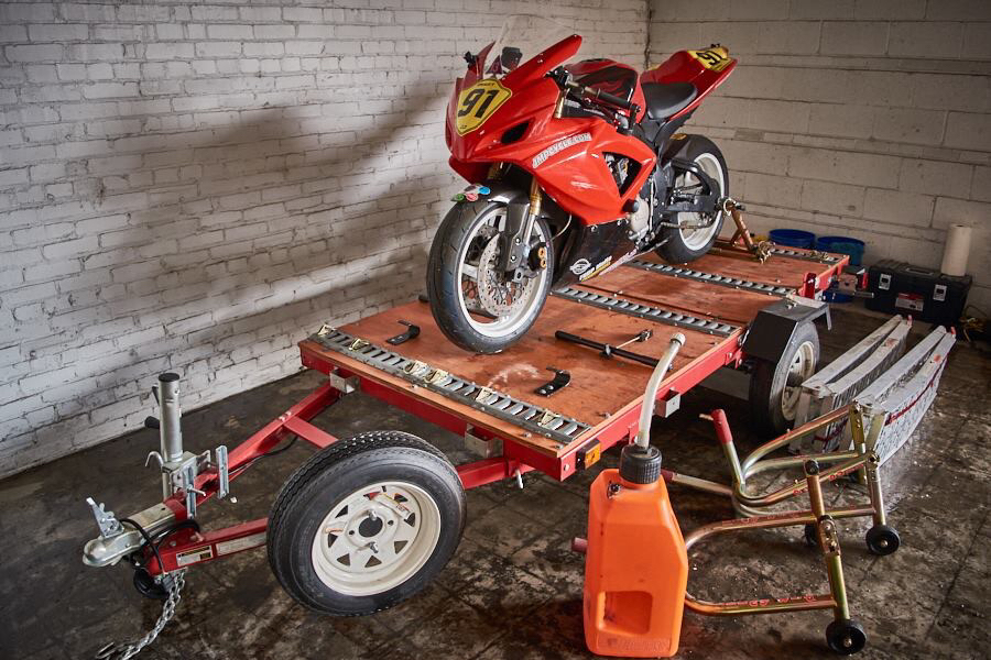

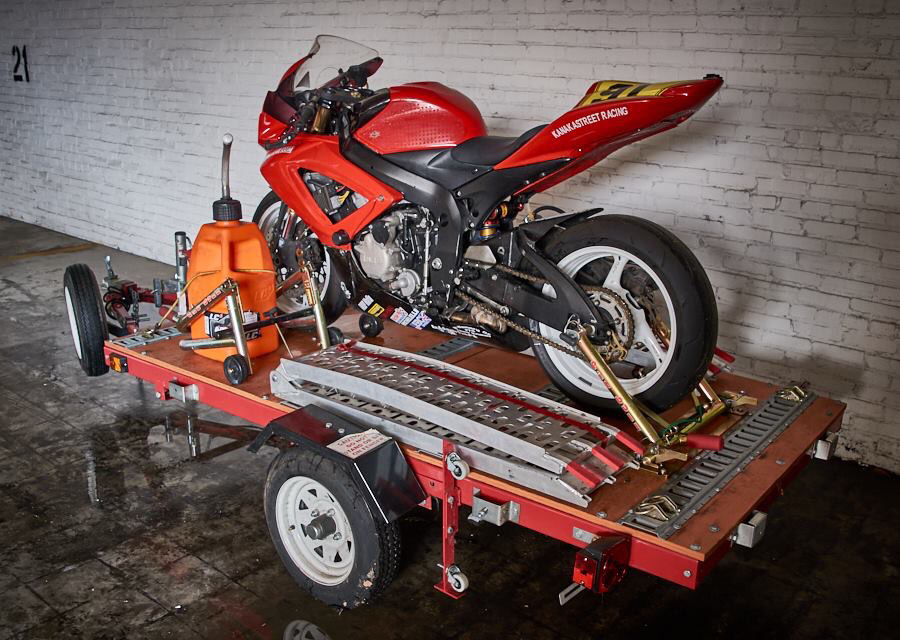

Originally Posted by WoodG35
Installed a new fuel pump and sending unit............and the other sending unit on the drivers side?
Installed a new Curt trailer hitch so I can pull my small trailer when needed.
Spent an hour trying to get the rear seat back into place......what a bitch (or was I doing it wrong?)
Finally someone else with one... very nice.
You have a coupe I assume? This will be my set up this summer.
